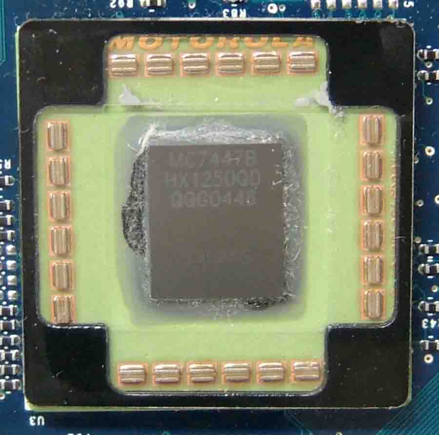

Here is the MC7447b cpu, but no reference anywhere on Freescale's website that we can access at least and no mention of it in here. This cpu is used in the Mac mini, Hector is correct. So is it custom version of the MPC7447A CPU?
