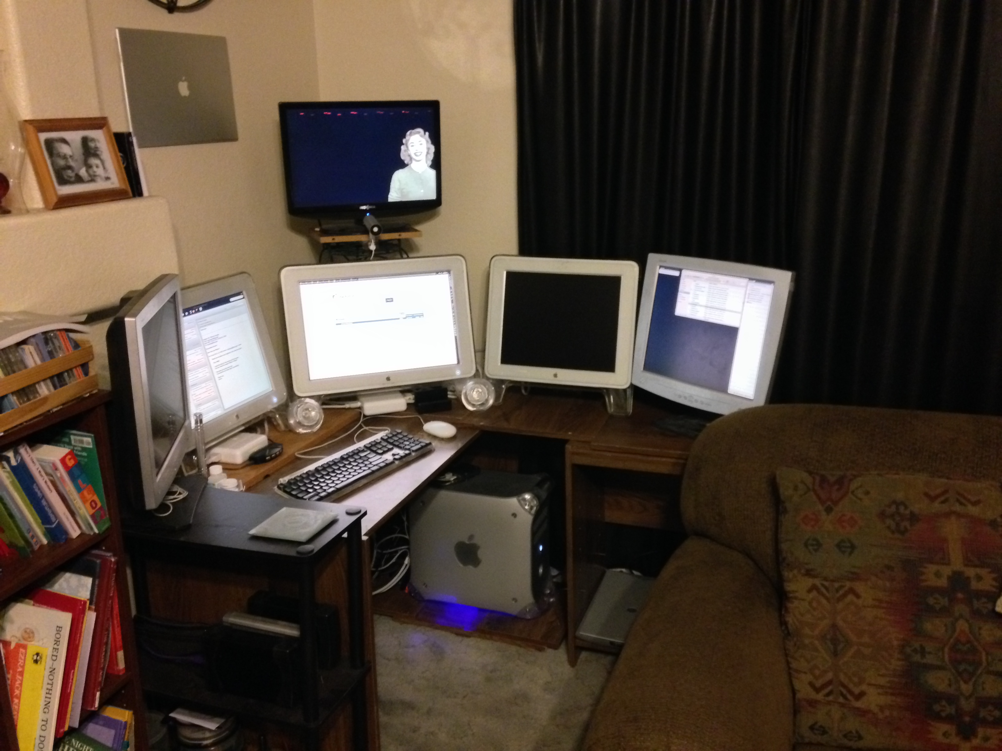

Welcome fellow Quicksilver owner! I love the QS and believe it's the most beautiful Mac model Apple ever made. Have fun with yours! P.S. Yes, the case it a tight fit. Start adding stuff as I have and you are going to find it very cramped!
Here is my QS by the way. I'm working on one more video card and then I can light up those other two displays. 😀

That is an impressive looking setup you have there! What're the specs on your QS and what have you added to it?

My QS?
1.2GHZ Sonnet G4 (I have a dual 1.8GHZ, but it's unstable)
1.5GB ram (the max you can have in the QS)
1 ATI Radeon 9800 Pro 128MB video card
1 ATI Radeon 7000 video card
1 SATA card
2x 1TB hard drives (total of 2TB)
1 USB 2.0 four port PCI card
1 22" Cinema Display
2x 17" Studio Displays
1 20" HDTV
2x 18" Gateway monitors
By Saturday I am hoping to be replacing the 9800 with a FireGL X3 with 256mb ram and adding in a ATI Radeon 9200 Pro
For the three Apple displays I have three A1006 ADC/DVI converters. These devices allow you to use ADC displays with video cards that have DVI ports. Since ADC displays require power and DVI ports to NOT provide power it's necessary to have a converter that will power the display and pass along the digital (DVI) signal.
I could totally use different displays of much bigger size, but I want to stay true to the period and that means the acrylic displays. Ultimately I will eventually have six 23" HD Cinema Displays - which is going to take time and money to get.
Six displays is crazy, but it's what I want and the Mac is capable.
