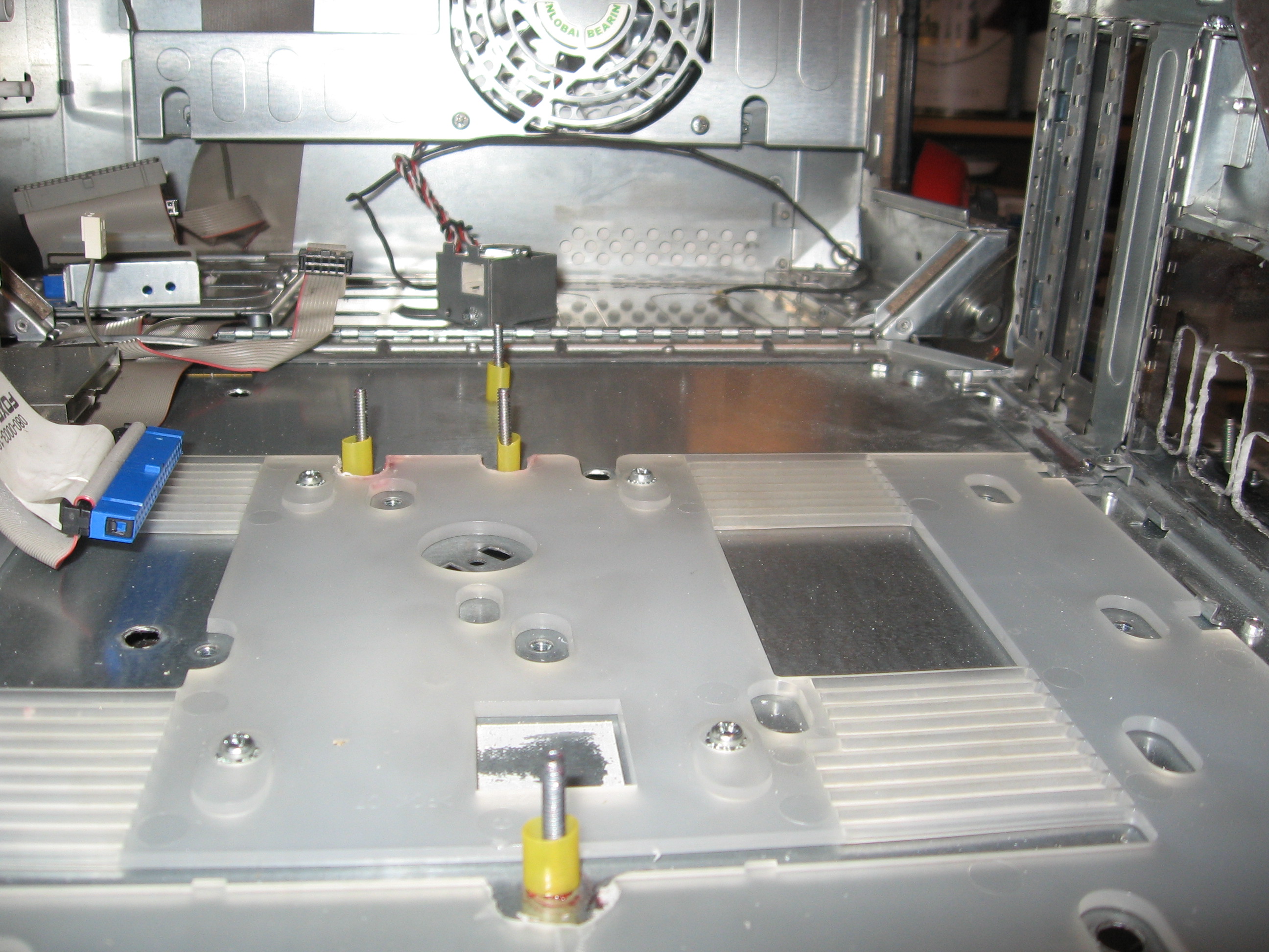

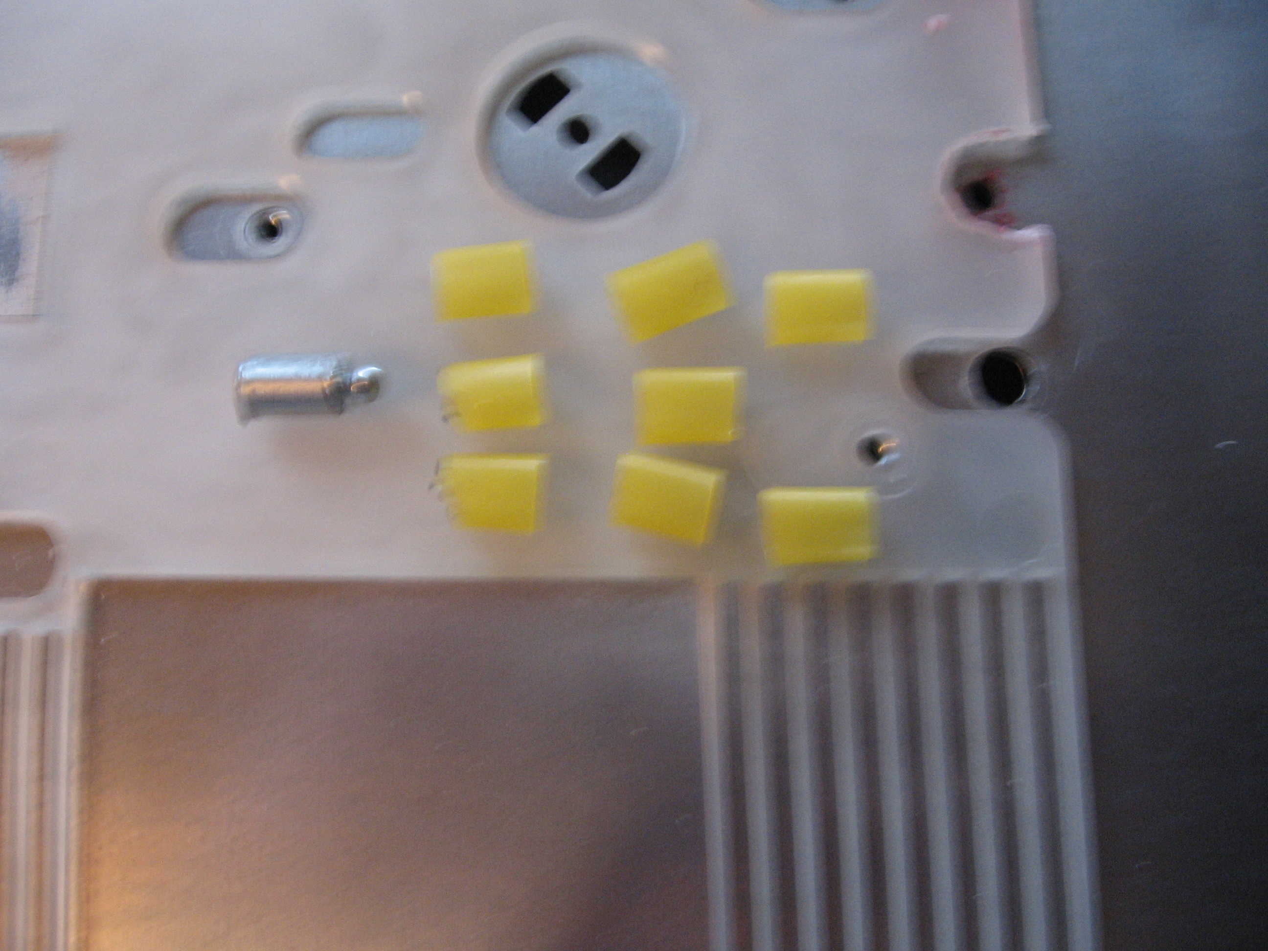

I realize this post is a few weeks old.. But i have to ask.. How did you get the motherboard stands in? drill holes the same size as the drill size on the pegs themselves?

Regular motherboard stand offs are the wrong height. After disassembling the door. I broke off all the metal pieces with pliers. I then drilled holes and ran screws through and made custom spacers with plastic hose. As I recall I also had to cut slots it the door latching system.
If I were to do it again I would solder or glue the screws in place and use a stiffer material for the spacers.
what do you mean by spacers? im not following what you're explaining here at all.. maybe to do you a photo you can share or at least PM me it? i want to do this mod in the summer.. but dont want to make the case a total mess... kinda a noob at fabrication..
what do you mean by spacers? Im not following what you're explaining here at all.. Maybe to do you a photo you can share or at least pm me it? I want to do this mod in the summer.. But dont want to make the case a total mess... Kinda a noob at fabrication..

Thats fancy, I just drilled holes without using spacers, I probably should fix that since PCIe cards don't quite fit without a bunch of effort.
If you still have the original standoffs. Use one as a guide for the spacer size. I'd use a stiffer material than the tubing I used. It crushes awfully easy.
