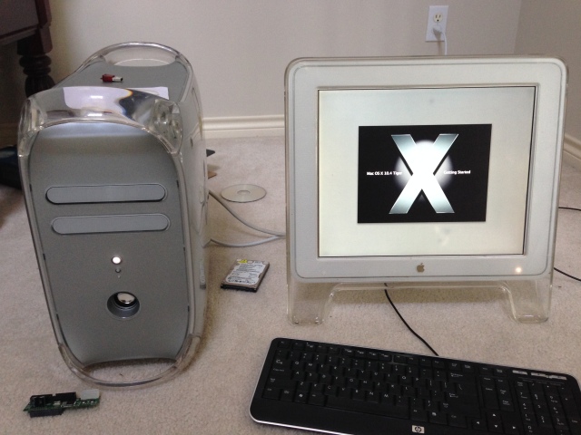

I will post some pics soon. 🙂

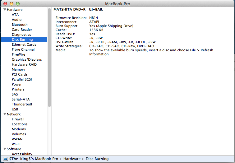

Zack, what OS you're running ATM? If lower than 10.4 and this drive doesn't have Apple firmware, you'd need Patchburn or OS upgrade.
OSes prior to 10.4 need this small app to add burning support for non-Apple drives.
You can check it in ASP. It should say "(Apple Shipped Drive)" in Burn support, if it has Apple firmware.
Like on this pic:
Currently the PowerMac is running no OS. I booted the install USB for Tiger and erased the hard drives, then tried to install 10.4 but it would fail when getting to the "Essentials" package. With the new optical drive being inoperable, I can't even attempt to install it with the DVD. 🙁

edit: thanks for the pic. 🙂 i sure do love quicksilver systems. QS=art=awesome!:apple:
