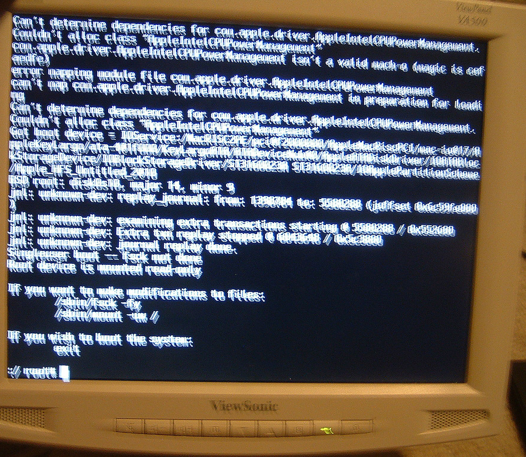

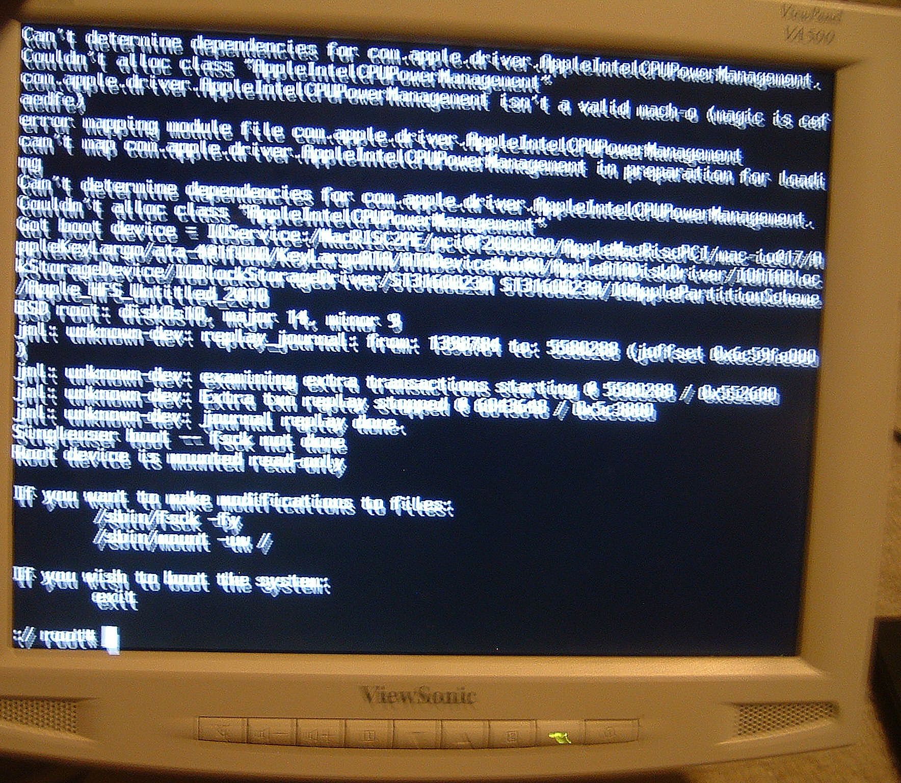

Then I started up in Verbose mode. A whole litany of verbiage appeared, but one thing that kept repeating read, "Can't determine dependancies for com.apple.driver."
Also read, "Jettisoning kernel linker."
Last line reads, "Login Window Application Started -- Threaded auth" And that's how it ends. Won't continue boot from there.
Can you get a screenshot of the verbiage when it gets to this point?
What you are listing is not necessarily out of the norm. The fact that your Mac gets to the login window and then locks up says that OS X is booting. It's just not advancing to the login window.
P.S., not everything you see in verbose mode is an error. It's simply the system booting and reporting either what it's going to do next or the result of a previous step.
No, I can't. Where would the screenshot be stored? On the hard drive, right? And I can't access the hard drive.
Sorry. I meant to say a picture. Like from a cellphone camera or something. If you can, just snap a shot of the screen when it gets to the point where it says "Login Window Application Started".

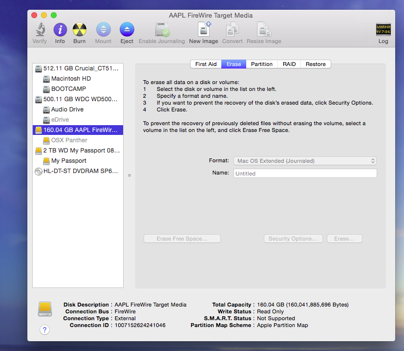

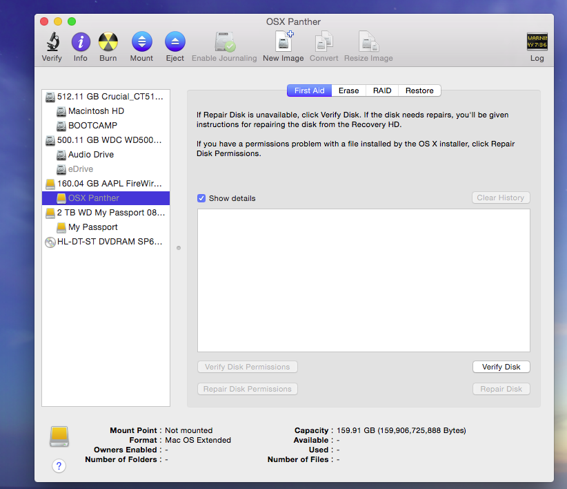

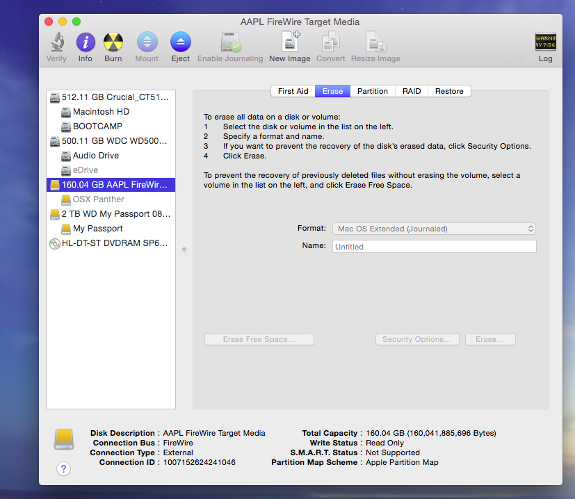

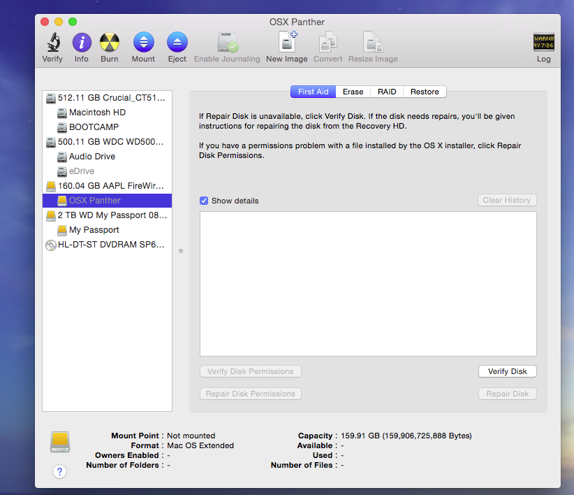

What I did today was press T and run it in target mode, and connect it to my Mac Mini 2012 via FireWire cable. It wouldn't mount, but it would show up in Disk Utility. Here are some screenshots of that.
BTW, although the HD is labeled OSX Panther, I'm actually running Leopard, 10.5.8. Just didn't change the name.
I wasn't able to mount it, repair it or even erase it.

Just a note here…if you noticed when you saw the drive in Disk Utility (from the pictures you showed) the drive was grayed out. That means even though DU saw the drive, the disk was not mounted to the desktop.
You can't format, erase, repair or otherwise work with a disk in DU unless it's first been mounted.
In general, if everything is solidly connected, DU is opened and DU sees a drive as unmounted then that indicates a problem with the drive. In your case it may be because the cable was not in solidly (and that can happen if it was loose to begin with from the normal vibrations inside the case) as you indicated.
