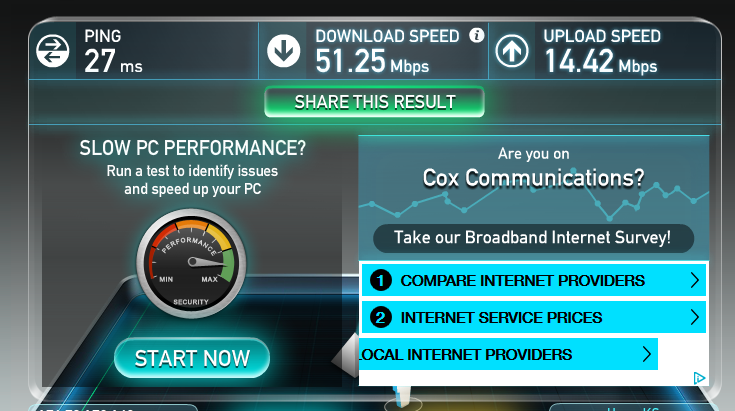

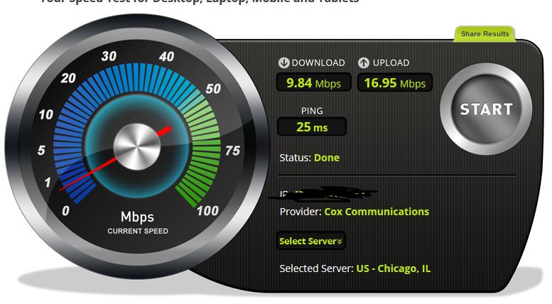

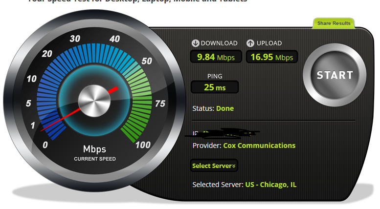

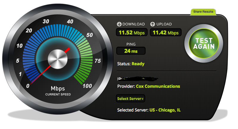

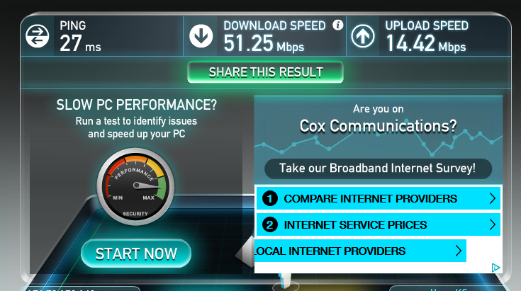

One thing you may not be considering is the path data packets take between your computer and whatever server is being used for testing your bandwidth.
I pay for a 50 Mbps pipe from Cox Communications. Here are three test results from two different computers on the same network. Both of them directly connected to my router with Cat5e cables. The first is my G4 Gigabit Ethernet tested @ MyBandwidthPlace, the second is my Windows 7 PC tested @ Speedtest, and the third is the same Windows 7 PC tested @ MyBandwidthPlace. The reason a different site is used for the Mac is because Speedtest.net utilizes Flash to run the test, and I wanted to use the same site to test each computer as a control. The tests on my Windows 7 PC were run just a couple of minutes apart and notice how one shows a ~50 Mbps download speed, while the other test ran on the same computer shows a download speed of ~10 Mbps. Why the difference in reported download speed? The only difference that immediately comes to mind is that Speedtest.net used a test server based in Hays, KS, while MyBandwidthPlace used a test server based in Chicago, IL.
