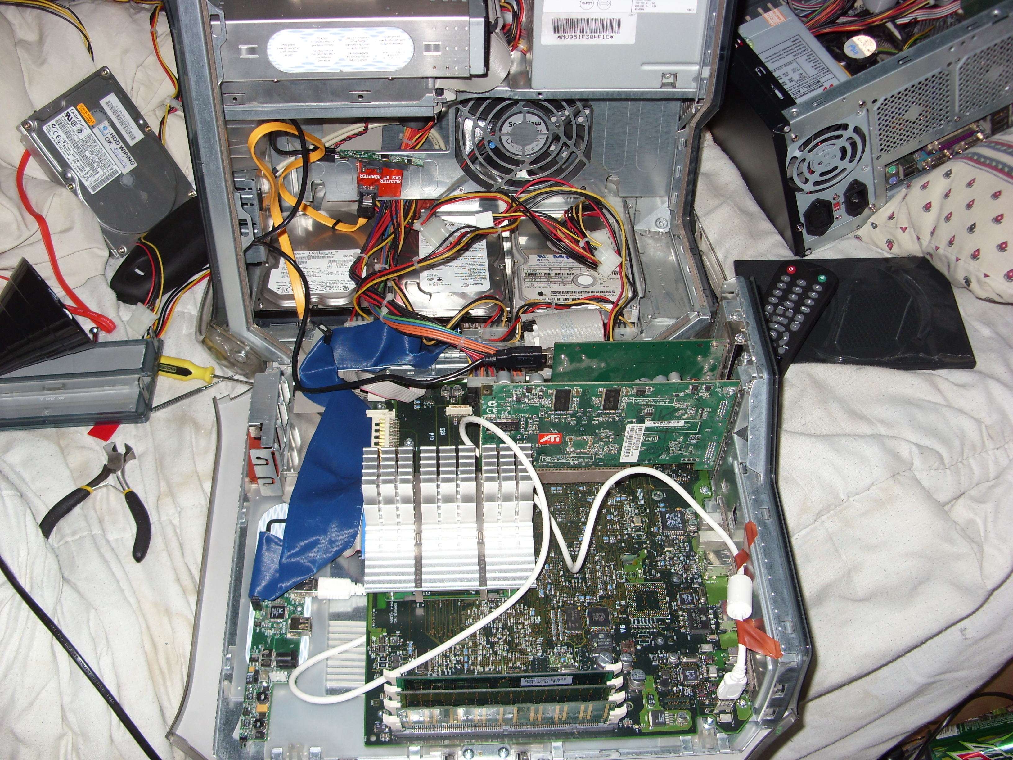

i thorough i might as well post the results of my nearly completed g4 ftp server, i have added a 40gb hdd in the zip bay, a usb 2 card (i have 2 usb drives for the server), a usb sata controller (plugged into the internal port on the usb card), and a firewire ata controller (pluged into the internal port on the mac's logic board) i still have one more sata hdd that needs to be plugged in
you can see the horrible old pc server i pulled all the drives from in the corner

What a mess inside 😱 😀 Do something with this cabling. Grandpa must look good when will be finished 😉
Do i see R9000 128 MB there? Good card for this oldie 🙂
it's not quit finished, i will tidy it up when i get around to modding a 450w pc psu for the machine so i can run even more drives😀 and yes that is a r9000 128mb card, i brought the g4 from ebay for £40 and i was expecting the stock card, alo would you recommend i add a fan to the top of the g4 to improve cooling
