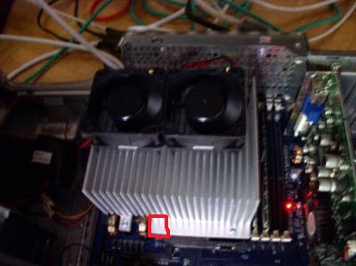

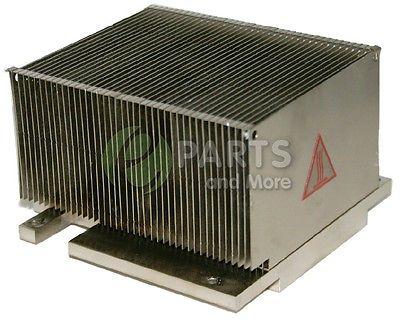

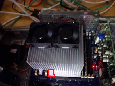

Which of these does it look like?

It can be made to work - you'll need to cut away part of the heatsink using a hacksaw to make room for the extra inductor that's on the dual processor modules. It would also be a good idea to add some extra cooling fans.
I'm fairly sure that heatsink isn't the right one - it needs to be one of the Apple OEM ones. Just keep looking on eBay for 'Power Mac G4 heatsink', they do come up for sale quite often. They usually go for about £10 - in fact a few months ago one of the copper ones was sold for £14 (wish I'd seen it! 🙄)
