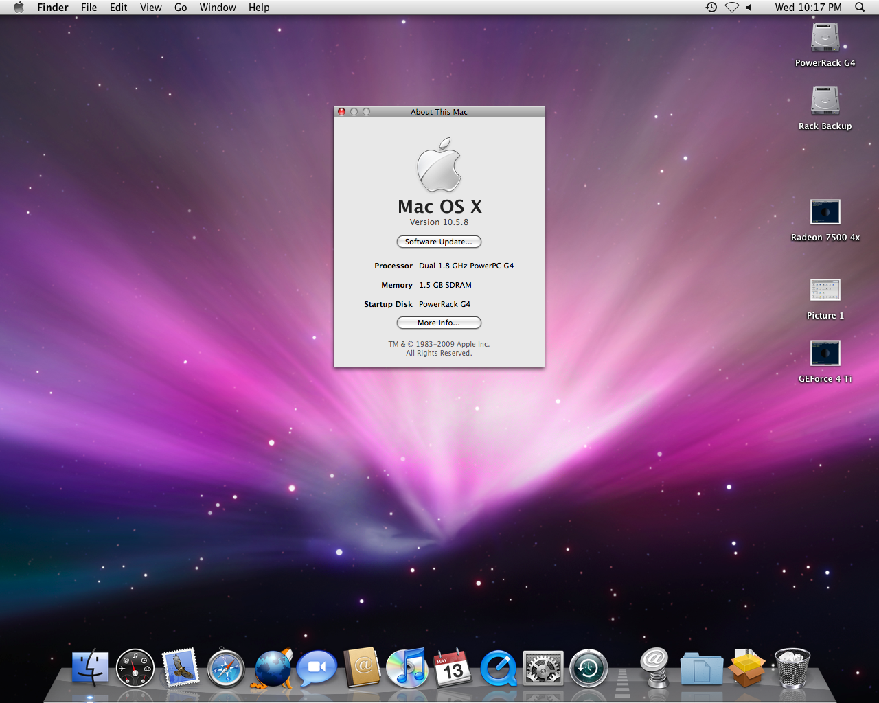

Hopefully a report will be forthcoming this evening
It took a little bit of futzing around with the firmware patch(apparently I needed to hold down the power button rather than press the programmer's button) to get things going, but with that done it works perfectly in OS 9 and Leopard.
It's rock stable and blazing fast running at its rated speed-that's more than can be said of some other "Dual 1.8ghz" processors that have been on the market. Geekbench and Xbench are coming later this evening.

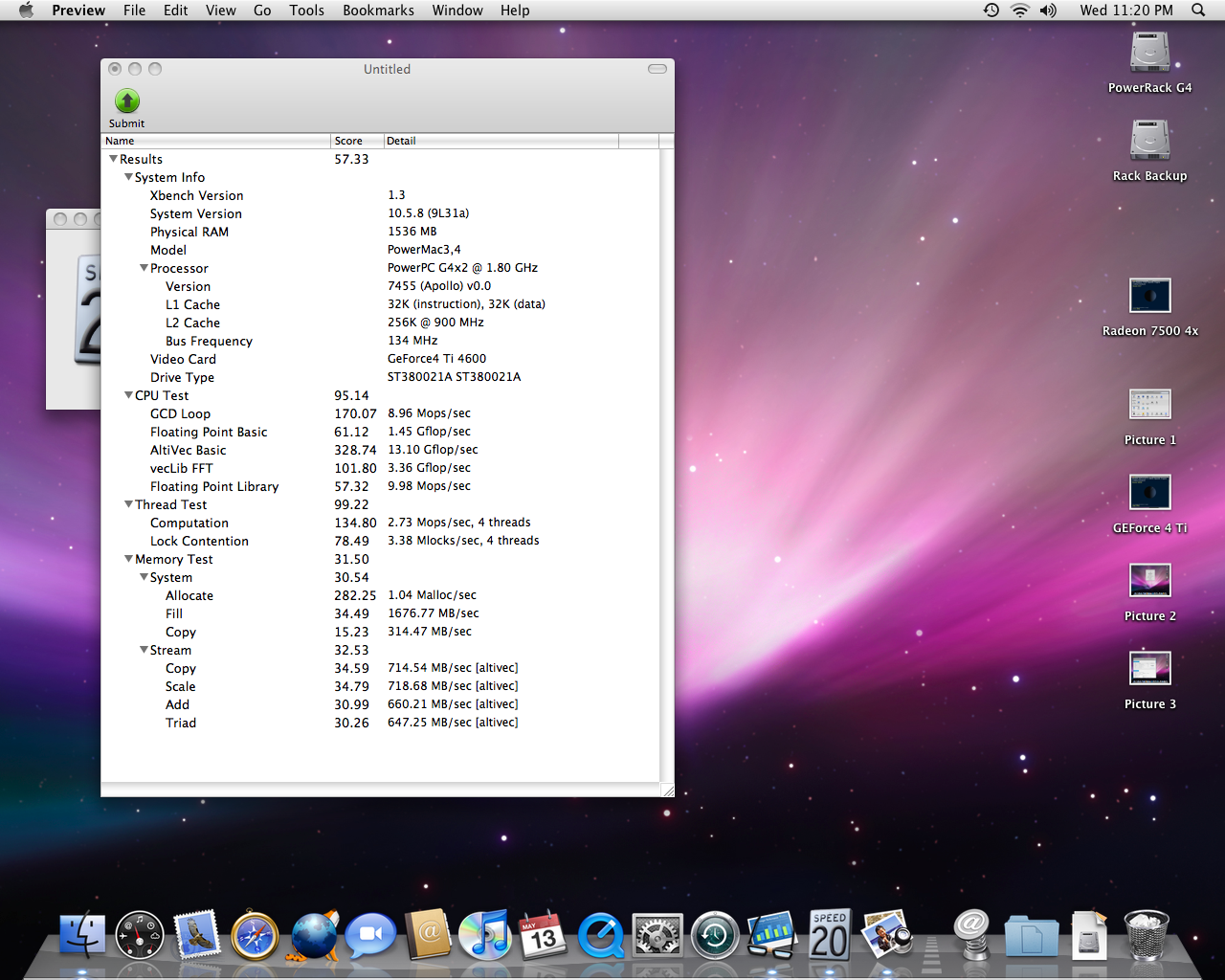

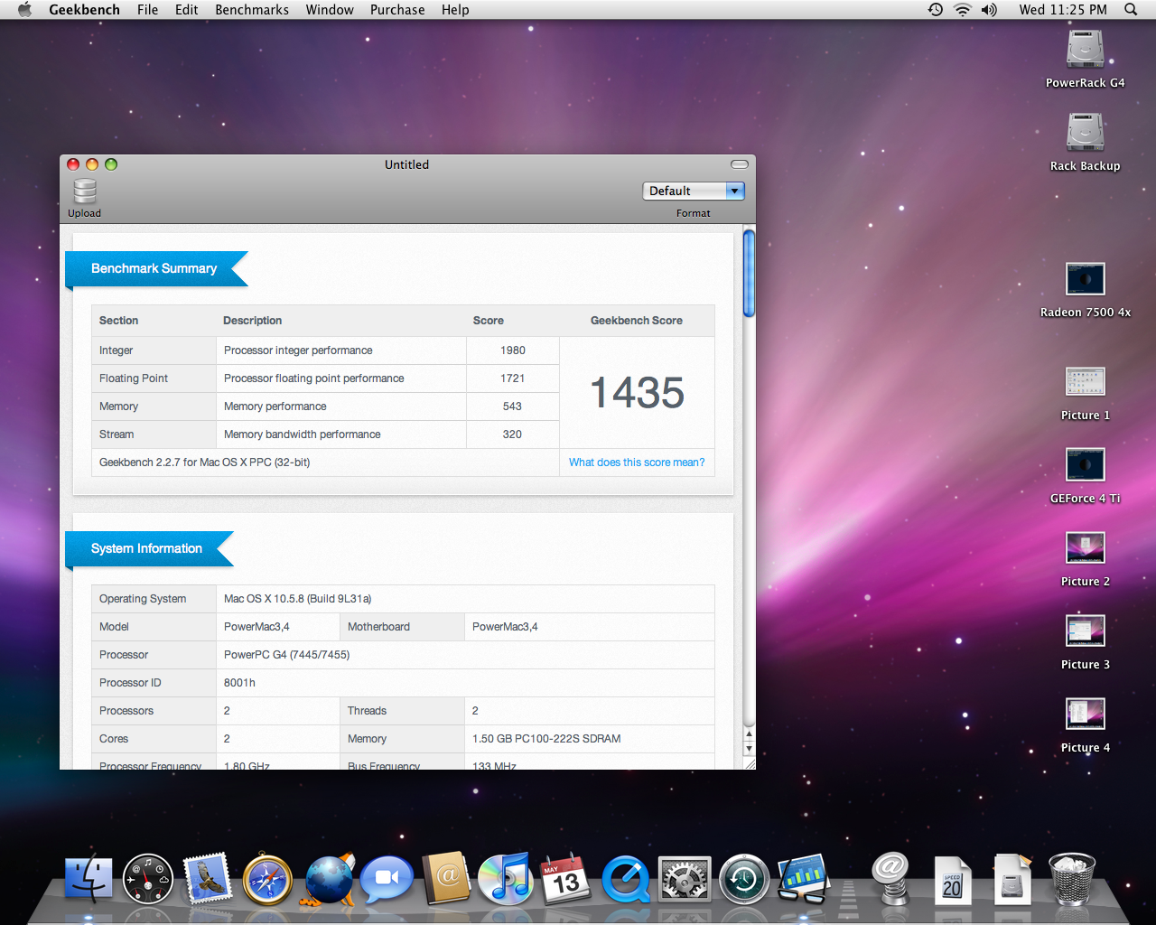

As promised-Geekbench and Xbench
BTW, the metal case is quite toasty right above the processor.

glad to see everything is working out 😀 its interesting OS X sees them as 7455As I wonder if it the boot rom patch does that or they use the NVRAM thing to report them as such so OS9 will boot... (OS 9 will lock up on a 7447A CPU unless you tell the computer to report it as a 7455 its one of the steps I used to boot OS 9 on my iBook G4)

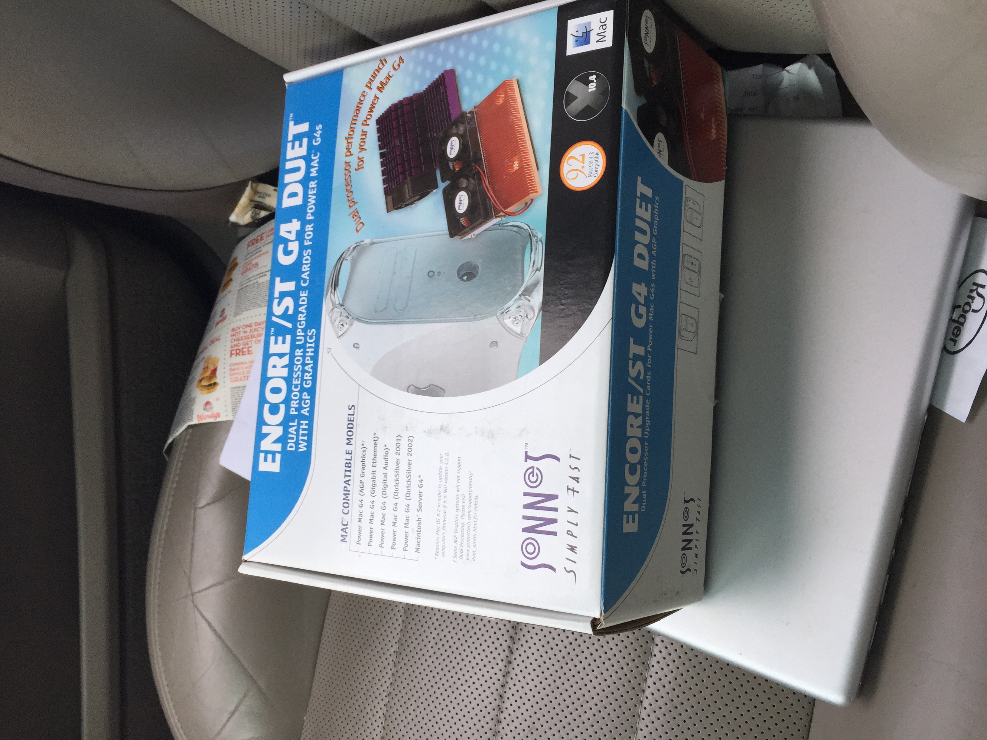

After Kroger and Wendys? 😀 😀
And the bad thing is that photo was taken at the drive-through line at Fazolis 🙂
I can't say too much-I'd just spent 3 1/2 hours driving back from Louisville(thanks to an accident shutting down I-64 that left me and the rest of the world taking 2-lane US 60) and was worn out. 🙂
(I really need to clean out my car)
No that 7455 is one of the several incapabilities of Xbench. It is reported on the net a few times (I think it was even in the developers read me file).
If you let bunnspecial open the detailed info under "about this Mac" it will show up as 7447.

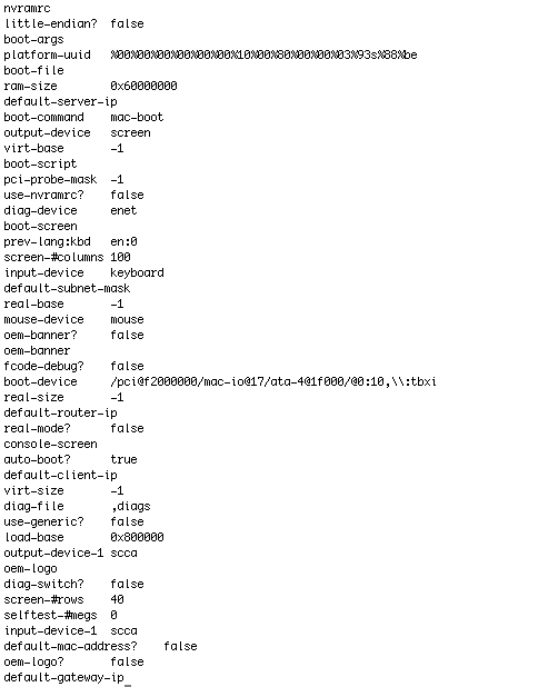

About OS 9 and this special Sonnet CPU. Only OS 9.2.2 works with this CPU, so be sure, you upgrade OS 9 before that (well, you will have to do it anyway, to run the ROM updater, but be warned if you later swap HDDs and have a OS 9.1 or whatever on it). Some people have the issue, that they have to change a file in the system extensions folder, so that OS 9.2.2 runs with this CPU.
EDIT: "OS 9.2+ is supported, however you must go to system folder/extensions/multiprocessing/Apple CPU plugins
Move Apple CPU plugins to the trash, now the machine should boot normally under OS 9."
(Btw. on holding the power button down: on my AGP G4 I had to hold down the programmers button for a while).

understood that xbench might not report it properly BUT look at geek-bench that reports 7455s (and I know for a fact on my iBook a 7447A will show up in geek-bench as a 7447A) if Bun could open up a terminal and run nvram -p for me and show me the output it would be interesting to see if there using the NVRAM patch to make the CPUs show as 7455s instead of 7447As (as OS9.2.2 will fail to boot on a unknown CPU so you have to trick it so and thats what i did with my iBook G4 after then geek bench saw its CPU as a 7450 till I cleared the NVRAM)

Also, Sonnet was very insistent on the ROM flash being done from OS 9(Gigadesigns did it from OS X) so I suspect this might also install whatever OS 9 extensions are needed.
With regard to the holding down the power button-this particular DA is the rackmount one that I bought a month or two back. It has the front panel board mounted inside the computer, but pressing the programmer's button didn't seem to do anything(the power and reset button are functional). Finally, out of frustration, I tried holding down the power button on the front(which is not an Apple OEM part) and the ROM flashed.

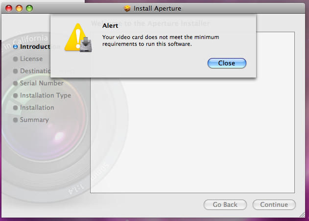

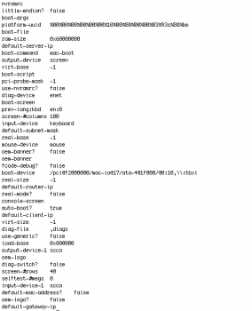

One "acid test" I've found for seeing if a computer has a 7447A is to try and install Aperture.
Aperture will only run on a 7447A(and with a Core Image card/GPU). I have it running fine on my Quicksilver with the Gigadesigns and a PC&Mac 9600, although it will not run at all on my factory dual 1ghz Quicksilver(it has a 9600XT).

It looks like Aperture sees it as a 7447A, as it gave me the "Video Card Not Supported" message rather than the "System Not Supported" message(I know from trying multiple configurations that it checks the processor before the GPU).
If I felt like getting the 4Ti out and messing with a 9600 Pro tonight, I'd try again to install Aperture. Since I'm not really inclined to do either tonight(the Ti is a pain to get out of the rackmount case, and the 9600 Pro is hit or miss in DAs), I'll try again tomorrow.
