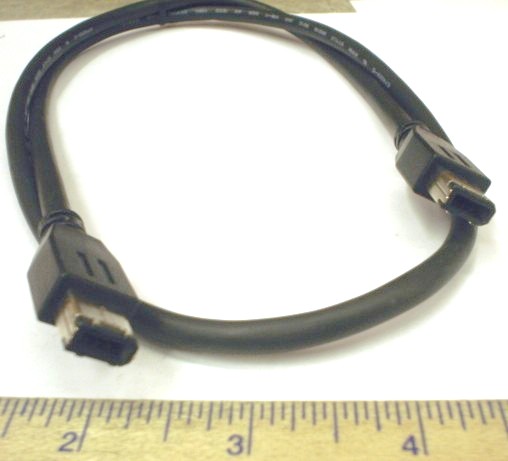

USB will not work, and for FireWire to work you'll need a FireWire 400 connector (similarly sized to a USB port) on both sides of the wire, connected to both computers. In order for the G4's hard drive to show up on the G5's desktop, you'll need to start up in Target Disk Mode ("t" producing bouncing Y screen) and then connect the two computers with FireWire.
Here's an example of what a FireWire 400 connector looks like, you'll need to have a cable with two of these in order for it to work.
i did?
Hi, thanks for the reply. in your picture thats the lead i have and thats how I started it up. G5, start up G4 with T pressed down, attach firewire and....nothing happens?
