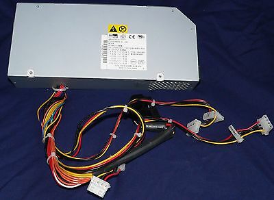

It is possible to recap (replace the capacitors inside the PSU) with some soldering ability and (usually way less) than $20.00 worth of new capacitors - but even that wouldn’t promise you a renewed, fully functional PSU. There is also the danger of some serious stored voltage within your PSU.
So, shy of re-capping your own PSU, acxelectronics down in Austin Texas (USA) does a great job repairing PSU’s for G4’s. I know several people that have used Andy’s services and he’s a great guy. (He’s helped me in the past.) And no, I am not affiliated with his business in any way.
Here’s a link for his MDD PSU repair service on eBay.
Contact him specifically about your Quicksilver PSU and I’m certain that he can help. Of course you may need to raise some funds - but still better that buying another Quicksilver... likely with a PSU as old as your original one.
*Update: here's the Quicksilver PSU specific listing...
Wow, 350% gross profit margin on parts of $20.00. So, if we say parts are parts and the value is in the skillset and service, lets put shipping a PSU at $15 bucks and the recap takes 1 hour, said service rate is $50 bucks. Sounds pretty darn fair to me. I mean PC service in my neck of the woods is around 35-40 an hour but I can imagine it being well more than or $50/hr in larger urban centers where cost of living is more.
