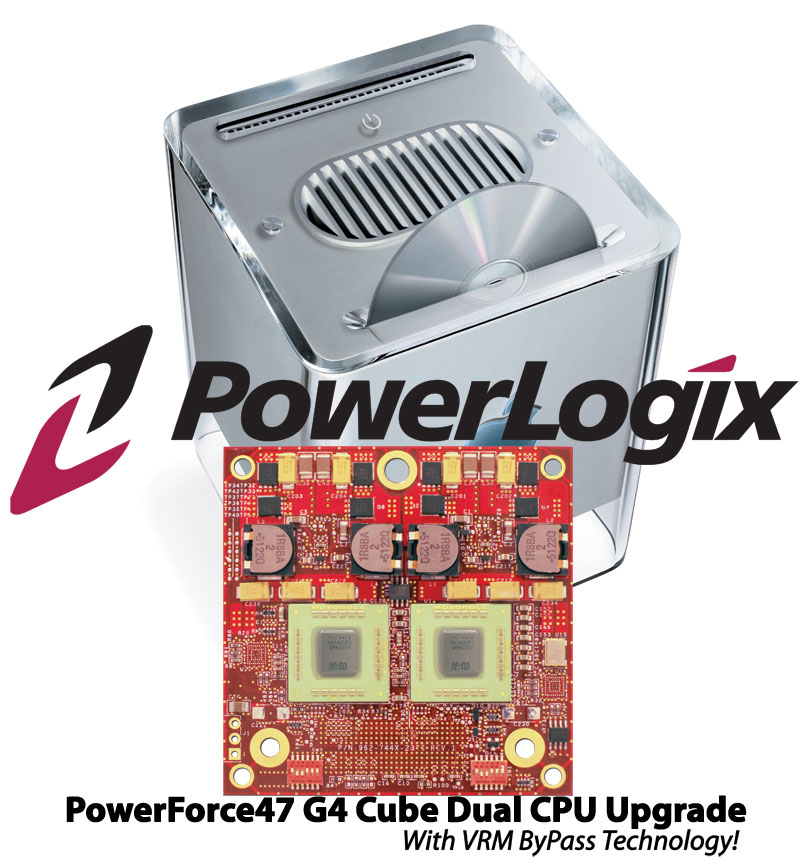

I'm thinking about upgrading a G4 Gigabit Ethernet doing the following:
I've got a Powerlogix dual 1.5 GHz 7447a cpu card I could use to replace the dual 450 GHz cpu. However, I don't have a fan for that since it was originally a Cube upgrade card, and it came with a base fan for the Cube. So, for heat sink, I assume I could NOT use the heatsink from the dual 450, since there is no fan for that. Should I see if I can get a heatsink/fan from OWC?

I've got a Powerlogix dual 1.5 GHz 7447a cpu card I could use to replace the dual 450 GHz cpu. However, I don't have a fan for that since it was originally a Cube upgrade card, and it came with a base fan for the Cube. ...
This will not work. Processor daughtercards are fairly specific to a particular line of Macs. The accelerator card for the Cube is mechanically and electronically incompatible with the your Power Macintosh G4 (Gigabit Ethernet) Medusa2's processor card slot.
Take a look at the Cube processor upgrade form factor:
Now ponder the Medusa2 processor upgrade form factor:
picture.php
in single processor form and
picture.php
in dual processor form. The Cube processor card will not work in your Medusa2.
