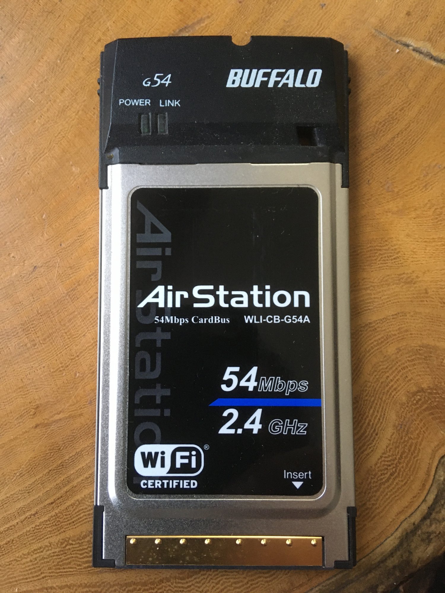

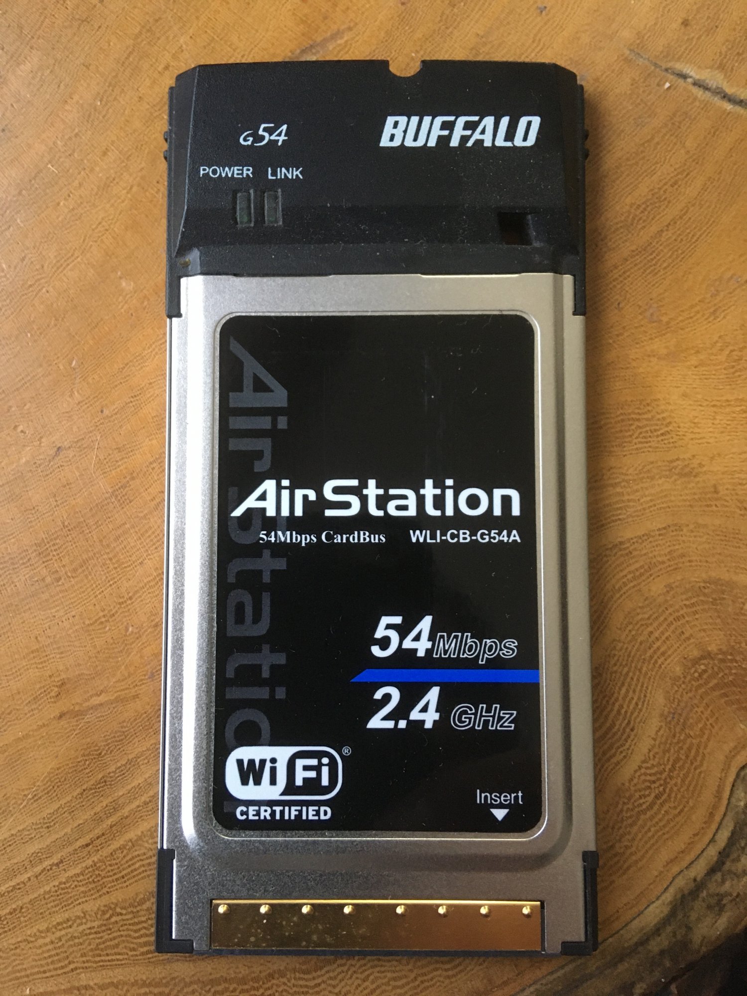

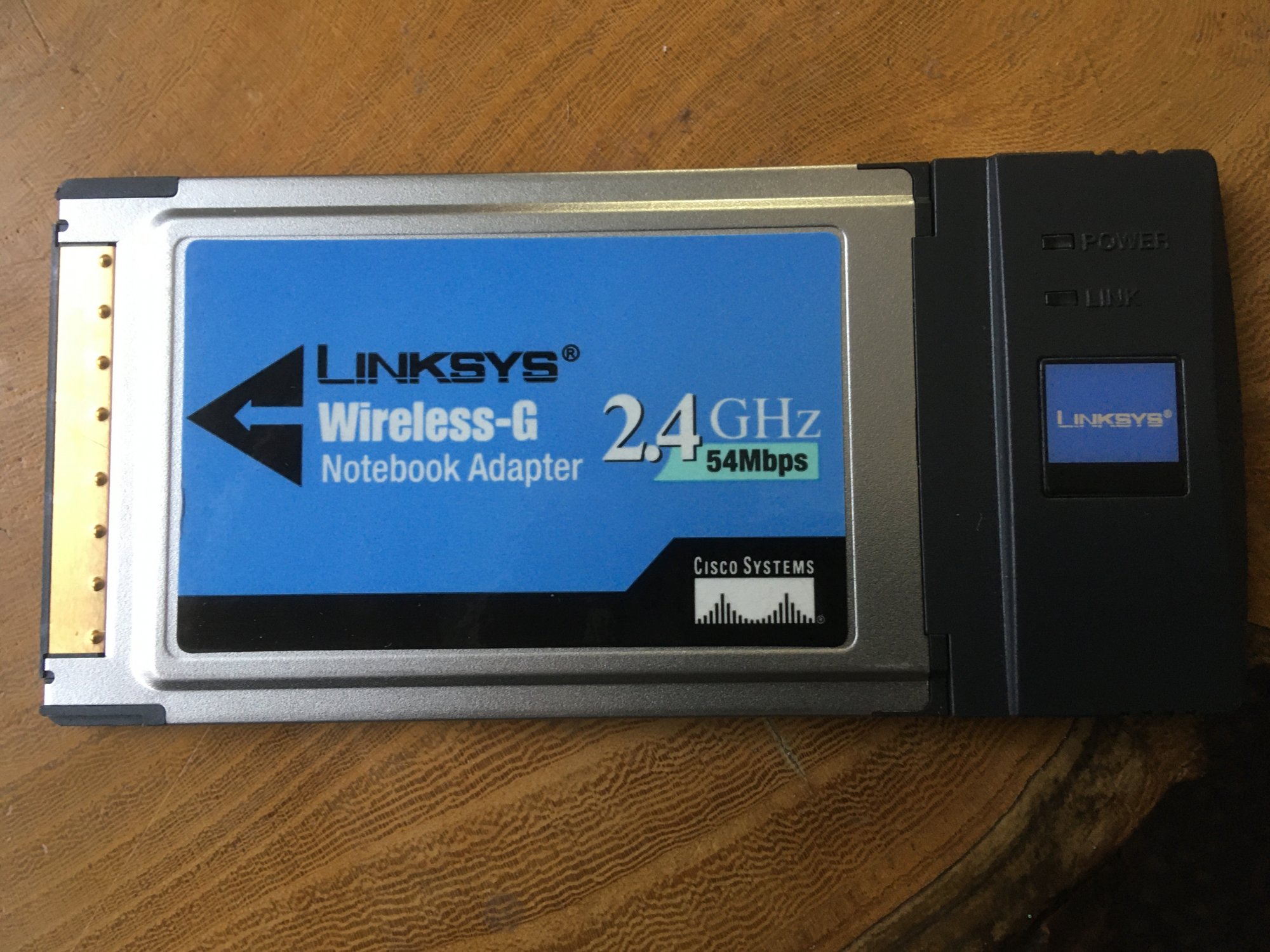

I can confirm that Buffalo 54G card is Airport native and works fine. The Linksys card seems to have a little more trouble connecting on my Pismo.
The Buffalo card is more expensive of course ;)

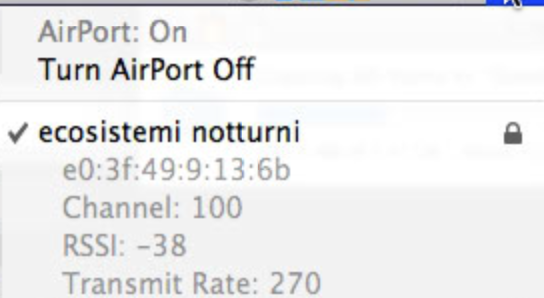

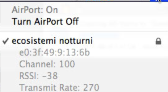

As for the PCMCIA card I have for my DLSD, the throughput is respectable for being across the room from the 802.11ac (three antenna) router:
And this is me moving a 2.5GB file from my G5 file server to the DLSD. It’s not the theoretical 600Mbps promised by the card’s specs, but it would be a bit higher were it physically closer to the router.

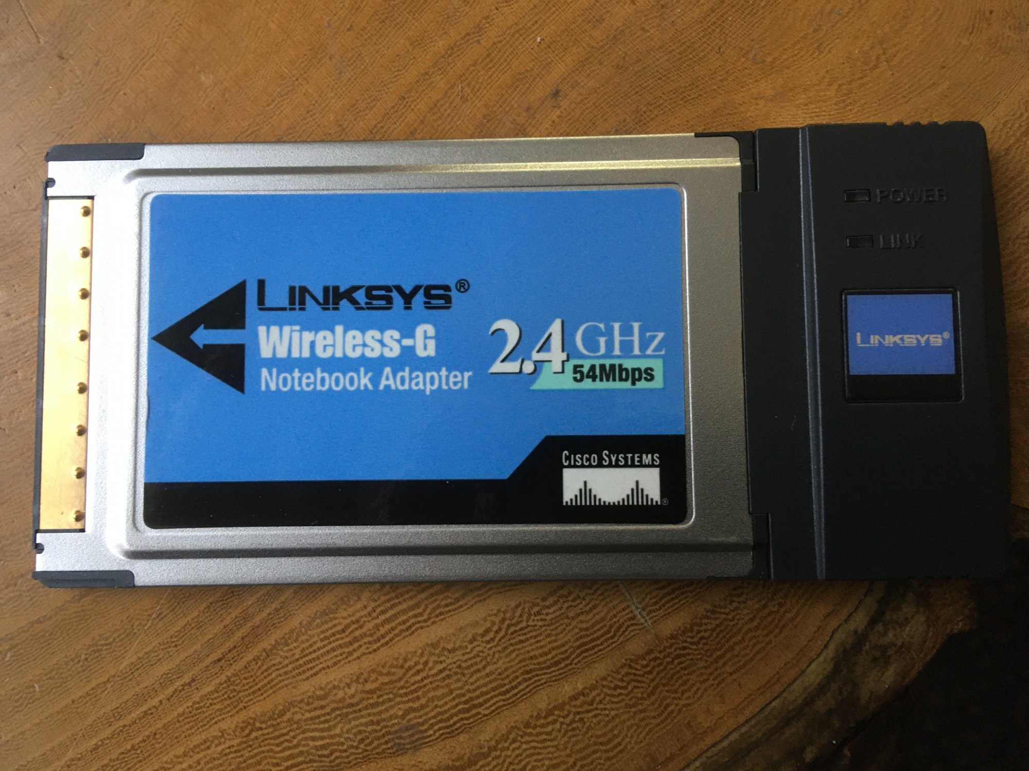

That said, it would have been really handy for one to be able to attach an optional antenna to the PCMCIA card I’m using (the Linksys), because I find there are lower reception bottlenecks in places like a Starbucks (where I’ve been successful in connecting to wifi, but dealing with the coding overhead/backend on those datavalet-dot-io pages is just brutal, especially when it isn’t clear just how strong the router’s signal actually is).

OK, the Buffalo card - WLI-CB-G54A...

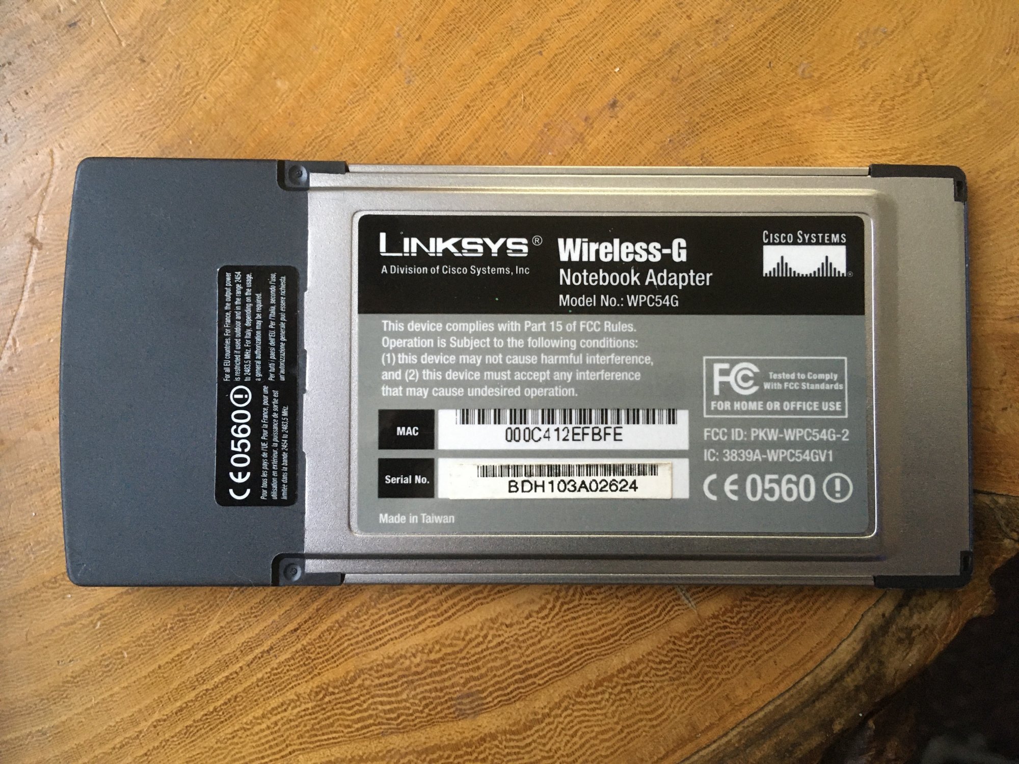

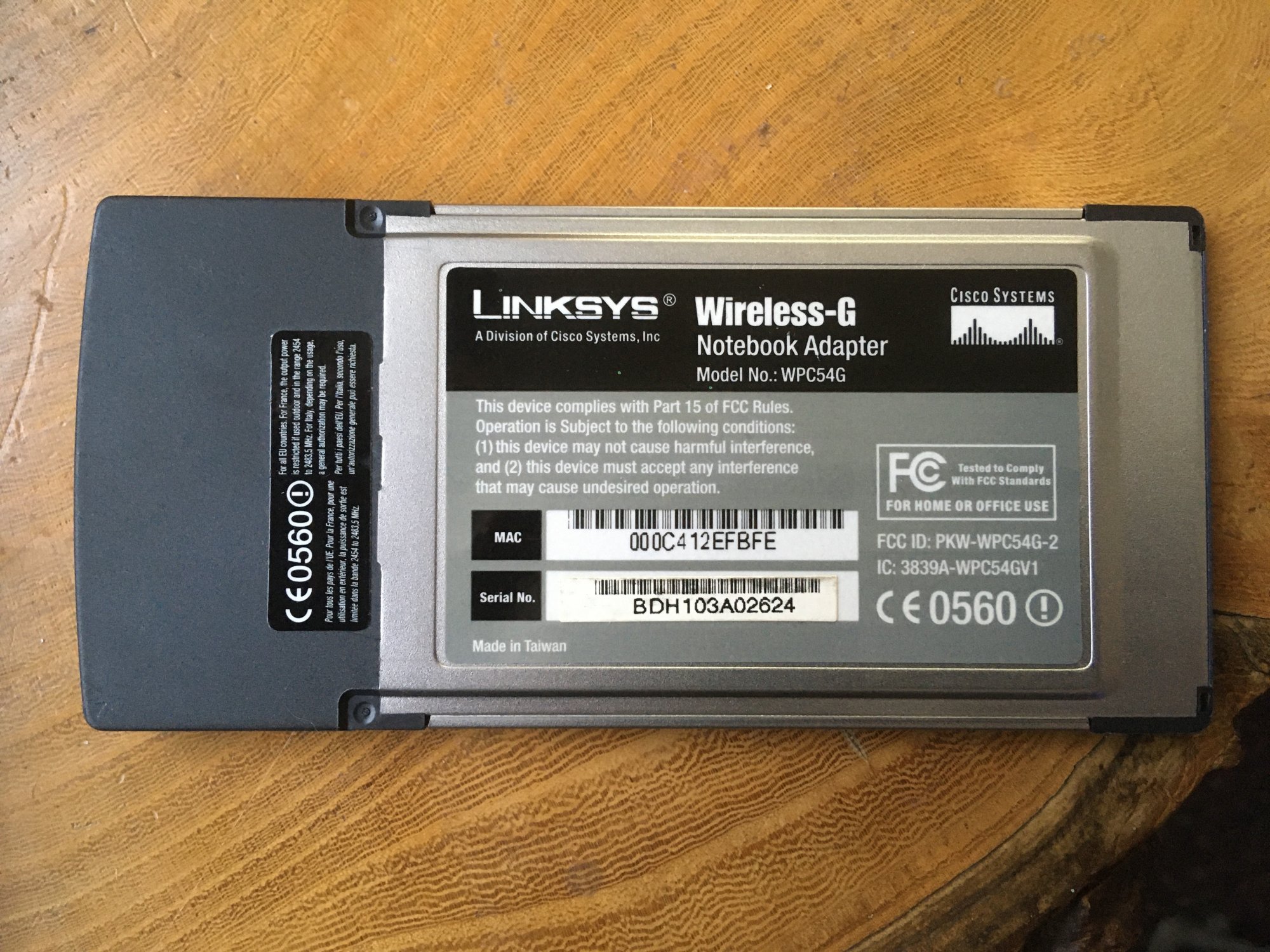

Linksys - WPC54G...

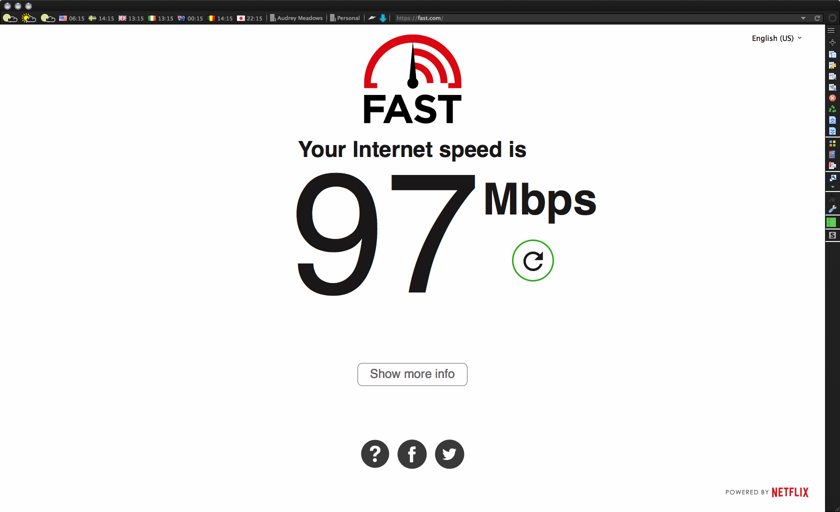

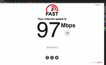

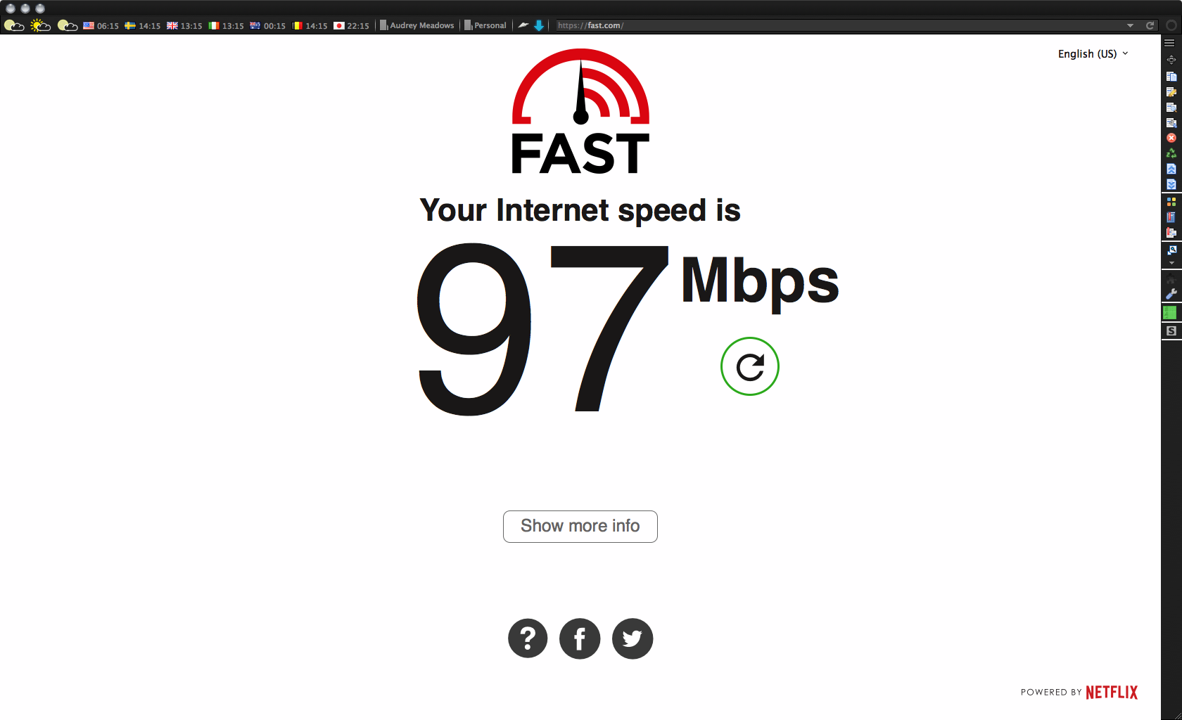

I'm not so sure I can agree with that.
PowerMac G5 Quad. Gigabit router, gigabit switch, I pay for a Gigabit cable connection.
But....your post confirms what I said though? You have a gigabit connection. 97Mbps is about 900Mbps short of what it should be getting.
What kind of speeds do you get when downloading large files from a sufficiently fast server?
