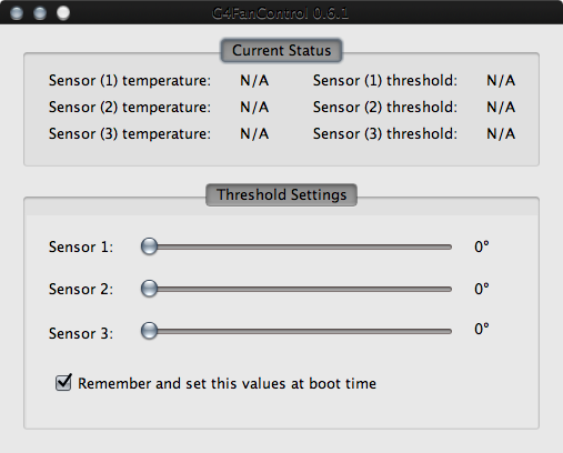

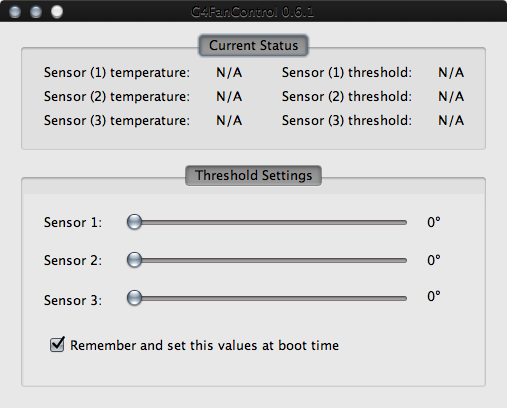

So, I thought I'd give this app another try and wasn't disappointed in finding that it's useless again.
Here is the main screen whenever I open it.
As you can see, it registers no temperature sensors despite my A1013 having at least three (CPU, Power Supply and Drive).
Ramping up the sensors to turn on at a specificed temp has absolutely no effect. Fans kick in at 140º which is the normal set point for PowerBook G4s.
Quit the app, reopen it and these temp sliders have all moved back to zero.
I have absolutely no idea what the difference is for those of you out there that this app works for but yet again it does not work for me.
With apologies to those who use it (and it works for them) I cannot help but think this is one of the biggest gimmicks out there.

Odd. I've never owned a 17", but I've had good experiences using G4 Fan Control on 12" & 15" PowerBooks. Beats me!
17" PBs are all I have ever tried to use it on. I used to have a TiBook but that was long dead before I discovered this app.
It just doesn't seem to work on 17" models.
I've had this issue as well. It only seems to work on Leopard on my 15" aluminum. It doesn't work in Tiger for some reason. I haven't tried it on either of my 12"s yet. Definitely does not work on the Titanium.

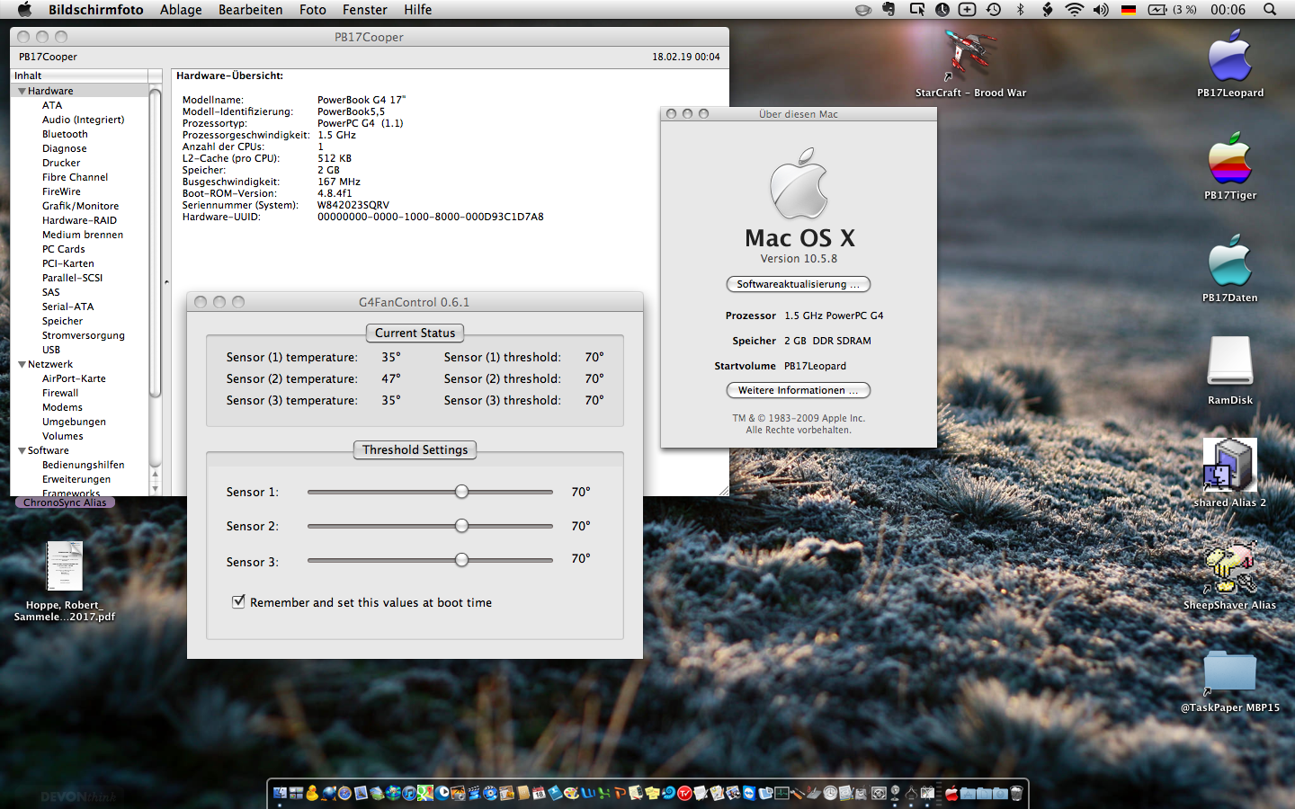

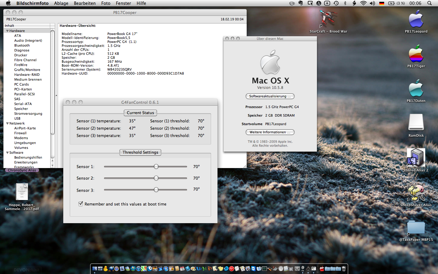

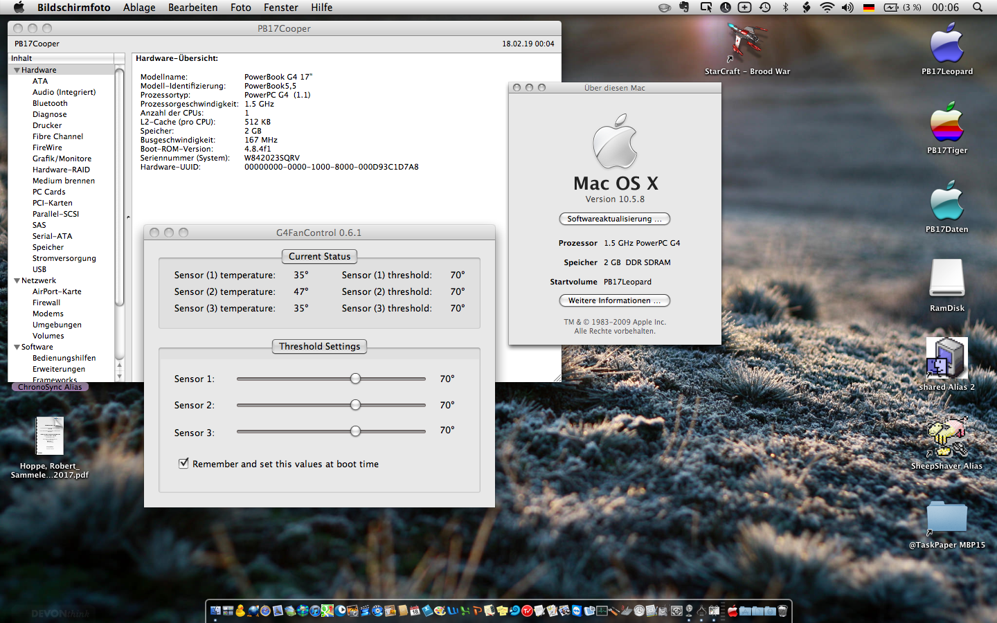

Oh, G4FanControl is a life-saver on my 12"PB and it also works on my 17"PB fairy well (but since there's much more space to get rid of heat on the 15 and 17" books , the app isn't mission-critical on the 15/17" devices)
Oh, G4FanControl is a life-saver on my 12"PB and it also works on my 17"PB fairy well (but since there's much more space to get rid of heat on the 15 and 17" books , the app isn't mission-critical...)
I use it on the exact PB, 1.5Ghz 15". I have mine set to 50 degrees, seems to stay pretty cool. Doesn't work in Tiger on the same machine for some reason.

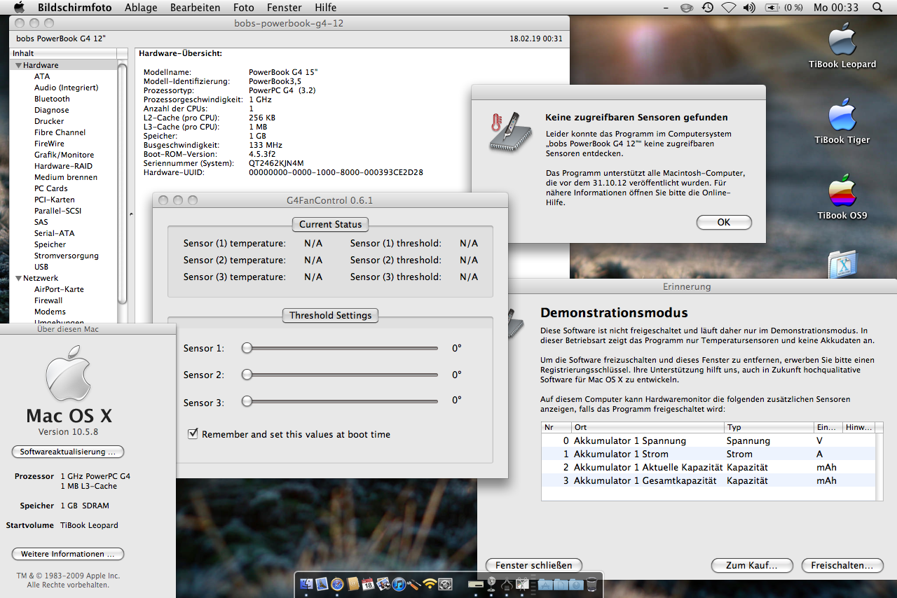

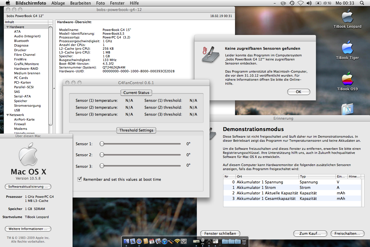

Just checked on the TiBookG4 1.0GHz.
Neither "G4FanControl" nor another temperatur-monitoring app seems to be able to get access to any temperature-sensors.
Seems Apple didn't pay much attention on temperature and fans etc. in the dawn of early OSX-capable hardware ...
The one commonality here seems to be the 7447 processor in all the PowerBooks where G4 Fan Control works. The A1013 17" and every TiBook had 7455's.
Just a guess, and I can't imagine why it would be that way, but there it is.
EDIT: Ok, not every TiBook had a 7455, only the later ones did. However, none of the TiBooks ever had a 7447. Seems that among the aluminum PB's, only the first generation 12" and 17" had anything else but a 7447 (and they both had 7455's). For what it's worth.
