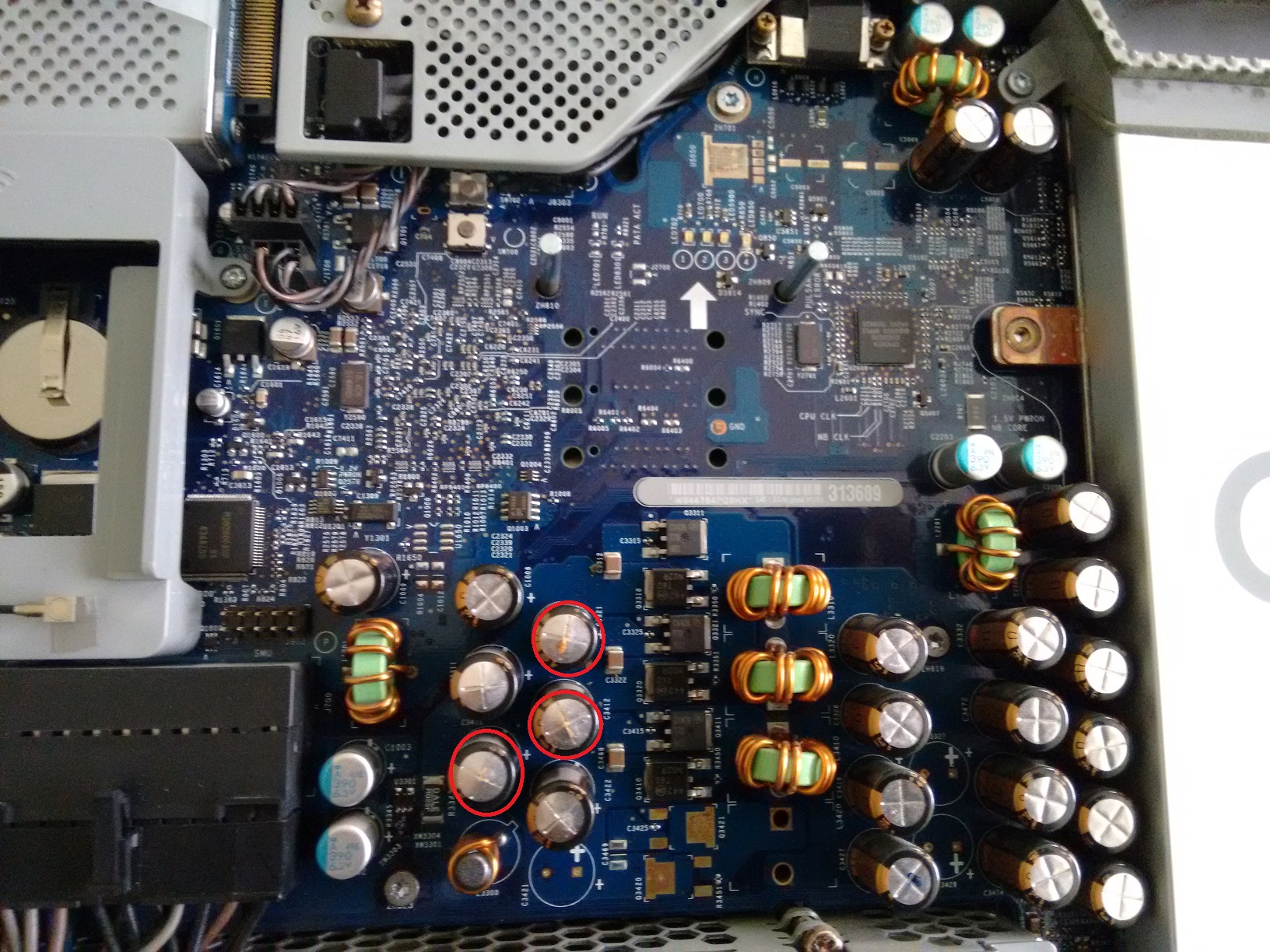

I have had another look under the cover and it might be bad capacitors after all. In the image below, I have circled the suspects and now see that others are bulging.
Even if just 2 or 3 show visible symptoms, all should be replaced, because the others are failing too (or will fail soon). He probably could get away with just replacing that group.
Yeah, they're gone. Probably the other two next to them as well.
