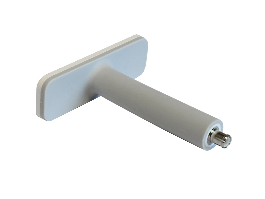

The PMG5's came with an Airport antenna. It plugs into the back.
This is what it looks like…
Without it you get poor reception. They go for about $50-60. You can fudge a bit with a paperclip stuck in the antenna hole (it's in the back of the Mac with the airport icon).

There is no separate router per se. I'm using my ISP's Zyxel PK500Z modem. I can connect up to 4 10/100 cables and it broadcasts my b/g wifi network. The antenna LOL. Had absolutely no idea there was such a thing for PMG5. I bet that is the issue with AP as the signal icon shows a weak signal. I see a number of folks claiming reliable 10mbs by using a plastic twisty tie with about 1/2 inch of the plastic stripped off the end. Im going to give that a shot as I have a bunch of those. If it sucks, I'll get an antenna.

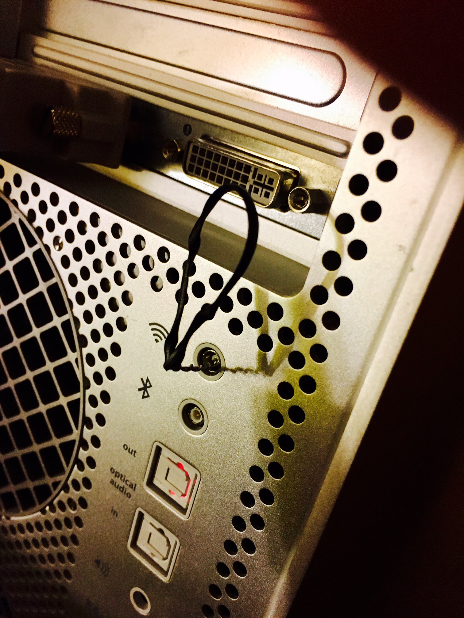

So this DIY antenna works like a charm. It's fashioned from a twisty tie with about 3/4" of the plastic removed and those sections twisted together. I then leave about 1/8" inch at the end in a U shape. One side sticks in the center hole and the other side pinches or clamps the outside. Gently nestled in and I'm getting excellent signal. Just DL'd TFF in no time.
I still haven't figured out the ethernet but I'll do that this week sometime. Running Time machine for the first time. That'll be a while.
