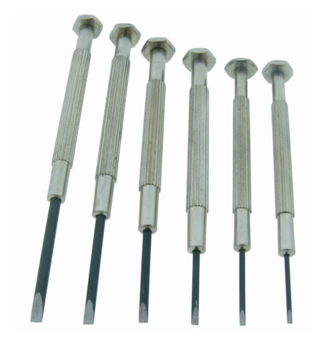

You can use a jeweler's screwdriver to fix those. These are small enough to slip in between pins and allow you to push them back up straight.
I've used them to straighten the pins on my G4's CPU socket before when I bent them.
This is what they look like…
I had tried a small screwdriver to fix them earlier but they are so small and so hard to see, I couldn't tell if I had gotten them straight or not. I tried using the telephoto on my iP7+ which helped a little bit but I suppose I'll just have to get into a good spot to work on them for a while. If I still can't get them right would I be able to use a same model logic board? They're fairly cheap online refurbished for the model I have (820-1592-A). Thanks.
Before you spend cash over an otherwise functioning board I might make one more suggestion - a magnifying glass. Lots cheaper than a new LB.

As @eyoungren said, try a small screwdriver and a magnifying glass. Another cheap alternative to an entire logic board would be a set of dentistry tools, in particular a probe and a mirror.
