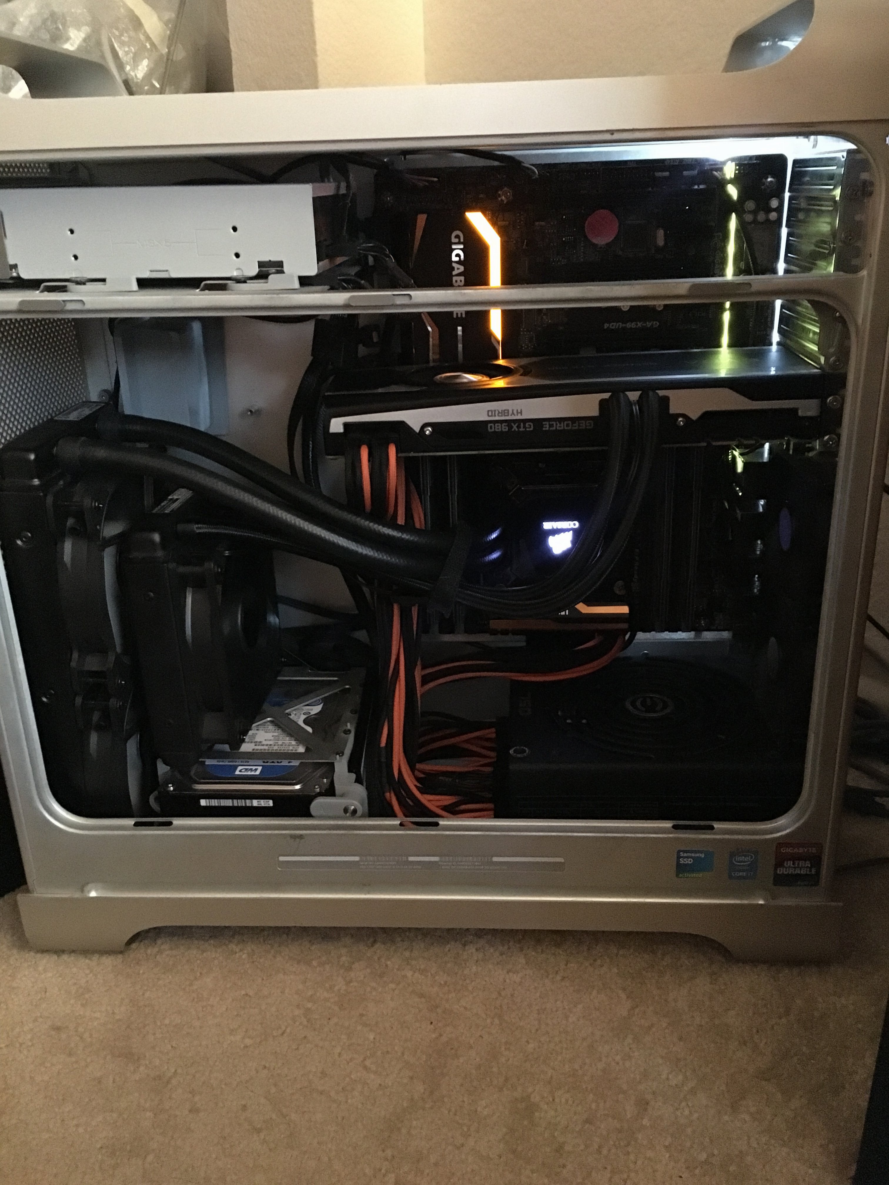

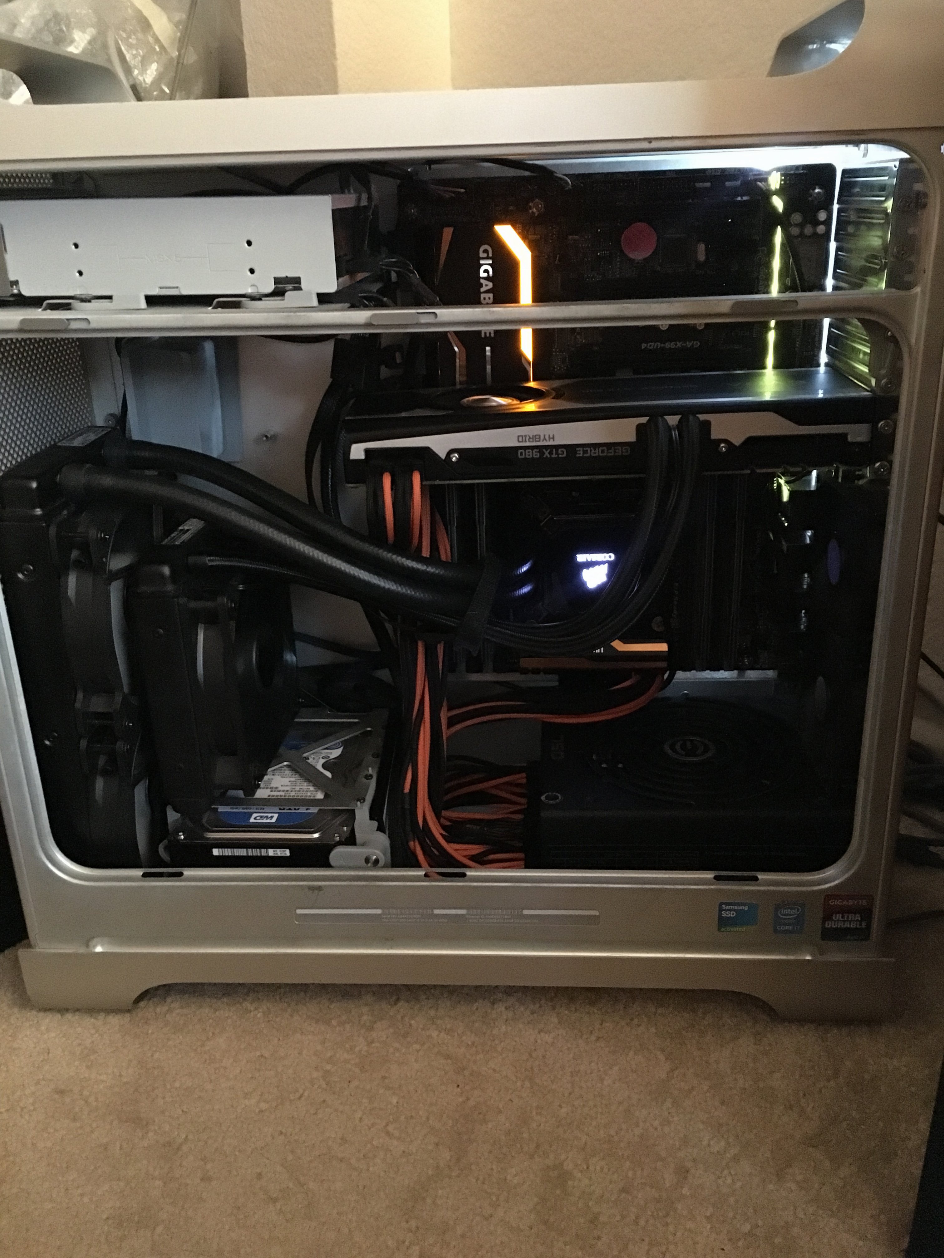

This is my Mac Pro with a 5820k and a GTX 980.
I rewired the original power button and left the usb 2.0 ports as-is. I don't care too much about front usb 3.0 but if I did, I would buy this conversion kit ( https://www.thelaserhive.com/kits/front-panel-conversion-for-g5mac-pro/ ) or resolder the original usb and firewire port to fit some 3.0 ports off an eBay kit.
For the motherboard, I am using a mountain mods duel 80mm tray. ( http://www.mountainmods.com/mountain-mods-modular-removable-motherboard-tray-p-56.html ) It requires a bit of cutting around the latch but it works fine. For the PSU I got a Lian Li bracket ( http://www.coolerguys.com/840556088271.html )
I added a SATA dvd drive because it was cheap but deleting it adds more room for stuff like hard drives or dual gpus.
The only thing I reused from the original G5 was the hdd cage and pc speaker.
P.S. I just upgraded the GPU yesterday so I'll relocate the HDDs soon.
