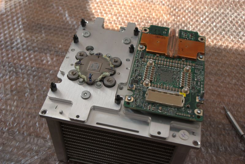

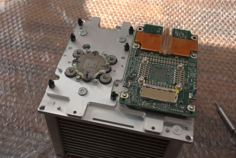

Cooling system / CPU's are now off, can't see any signs of leak so either it has not leaked or it has been cleaned before me:
EDIT: Well, removed CPU's and there was indeed blueish thing, not very much but still. Also when I reseated CPU's the machine does not give chime and/or error codes... I tried to be careful but did I still broke something? It powers on and after a while fans run full blast, no led lit on the front.... I didn't however tighten any screws on the cooling system.

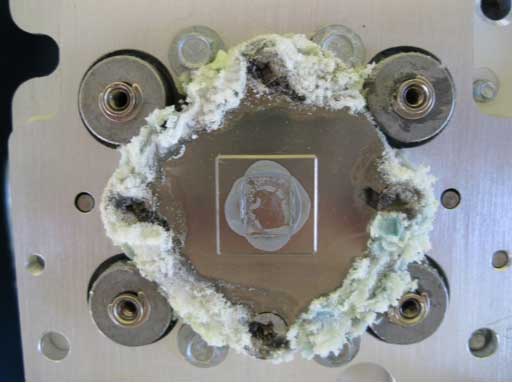

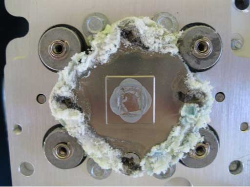

One thing you should have done is to actually take the CPUs off the LCS. Under there you will see if there is whiterice or not.
Yes I did:
I don't know if this has been cleaned before me.
EDIT: Hmm, maybe it has since even that screw has some amount that thing on it.

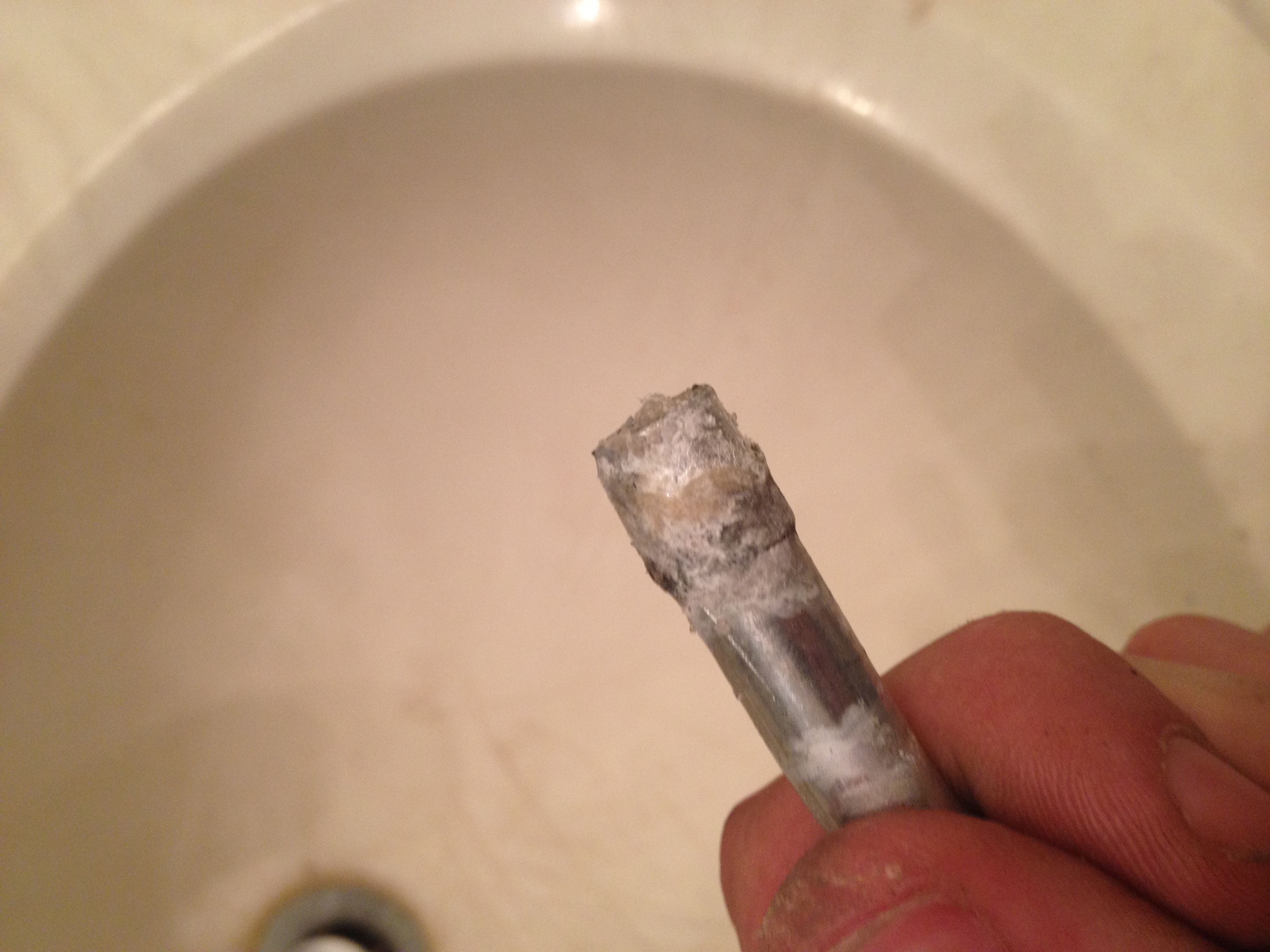

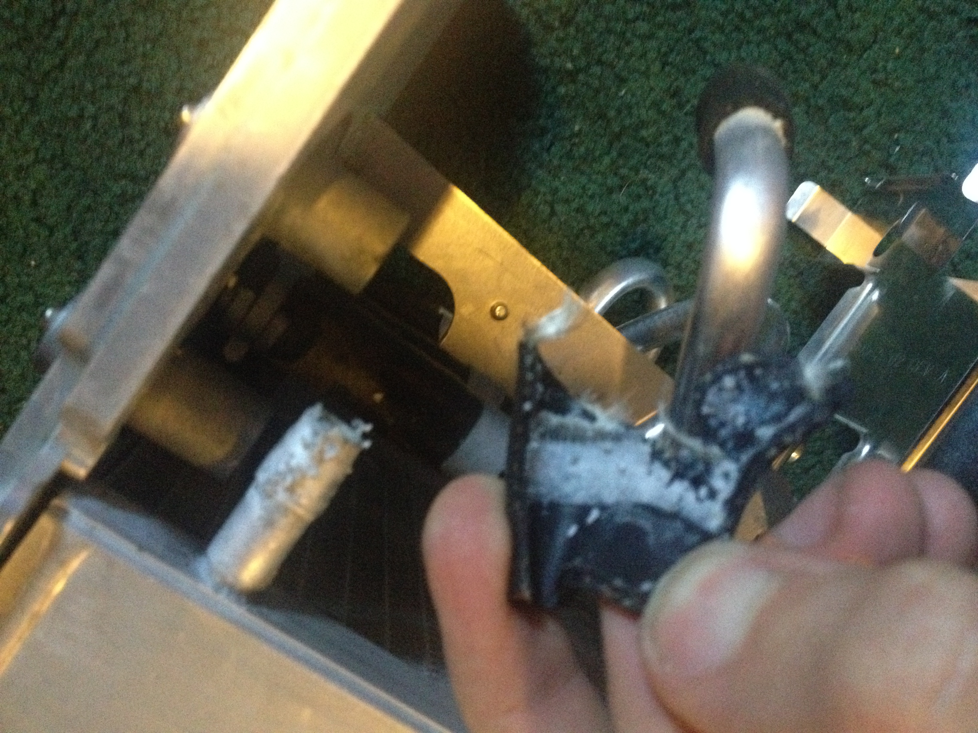

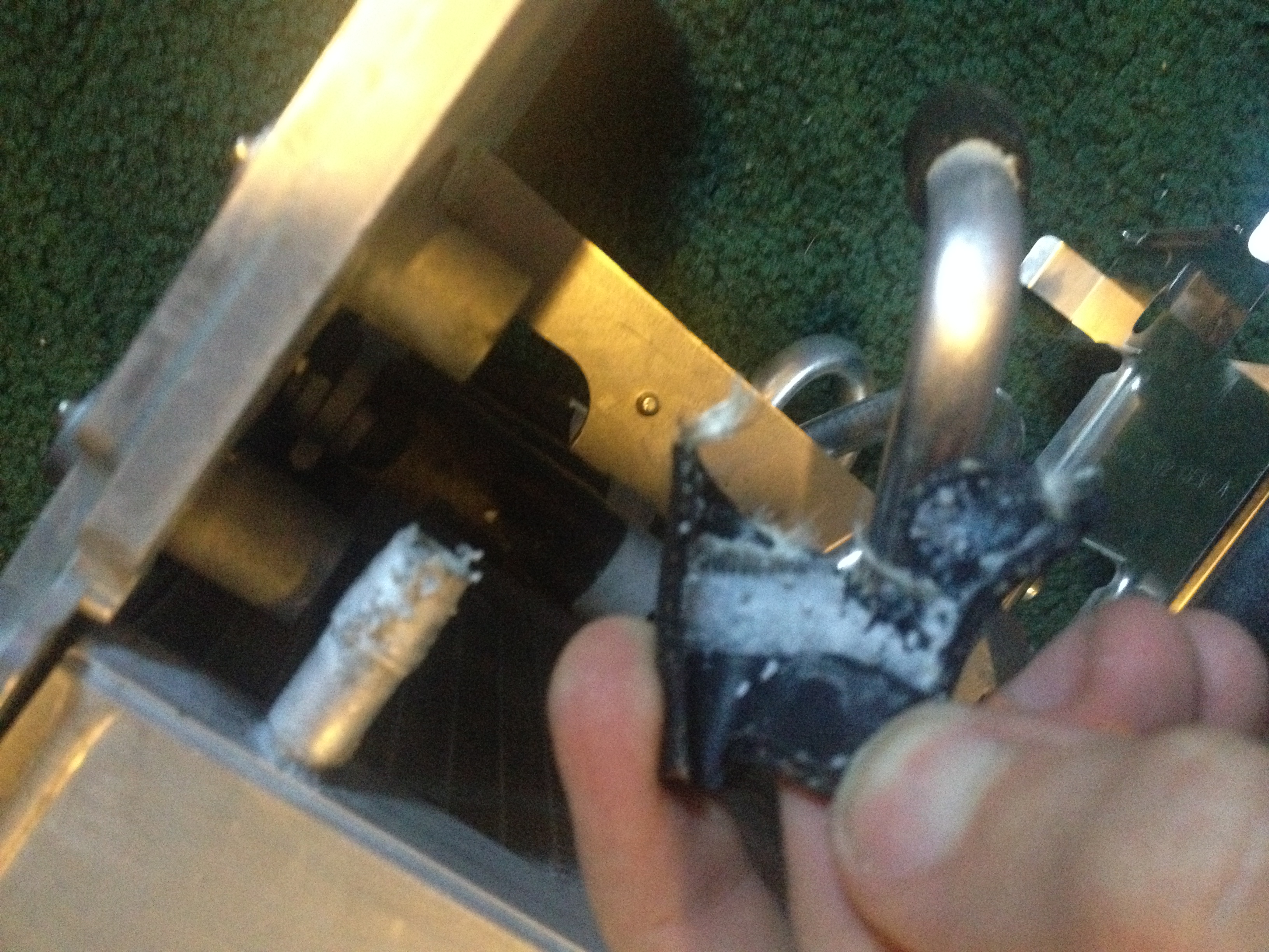

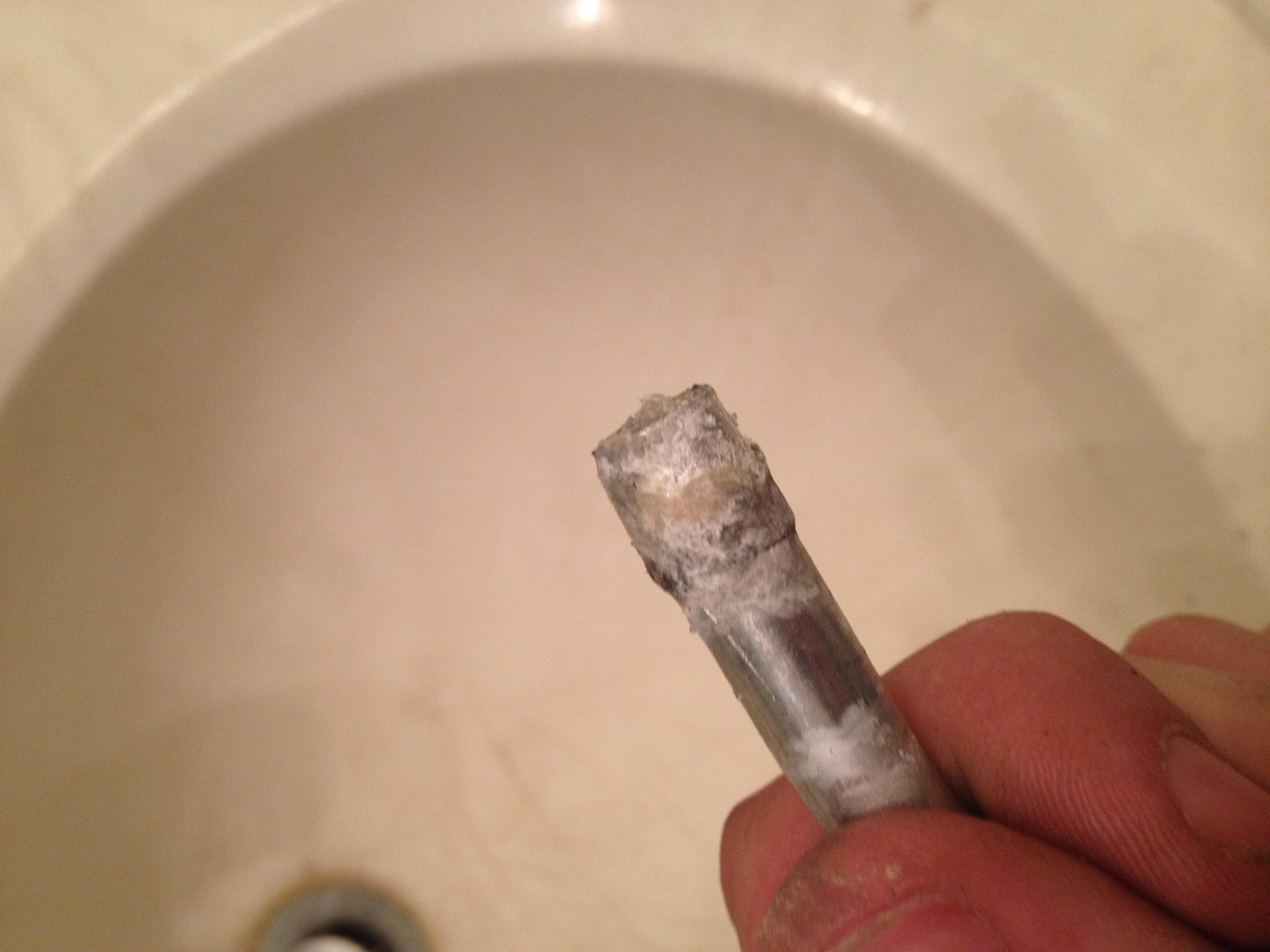

One other thing to watch out for if you rebuild the LCS is the crap that builds up on the piping. I had to work on making my 2.3 (was a 2.7 with a LCS, now air cooled 2.3) work today and I saw the LCS and took these pics. Nasty crap!
I dunno if I will ever work on the LCS.... I have zero knowledge of it.

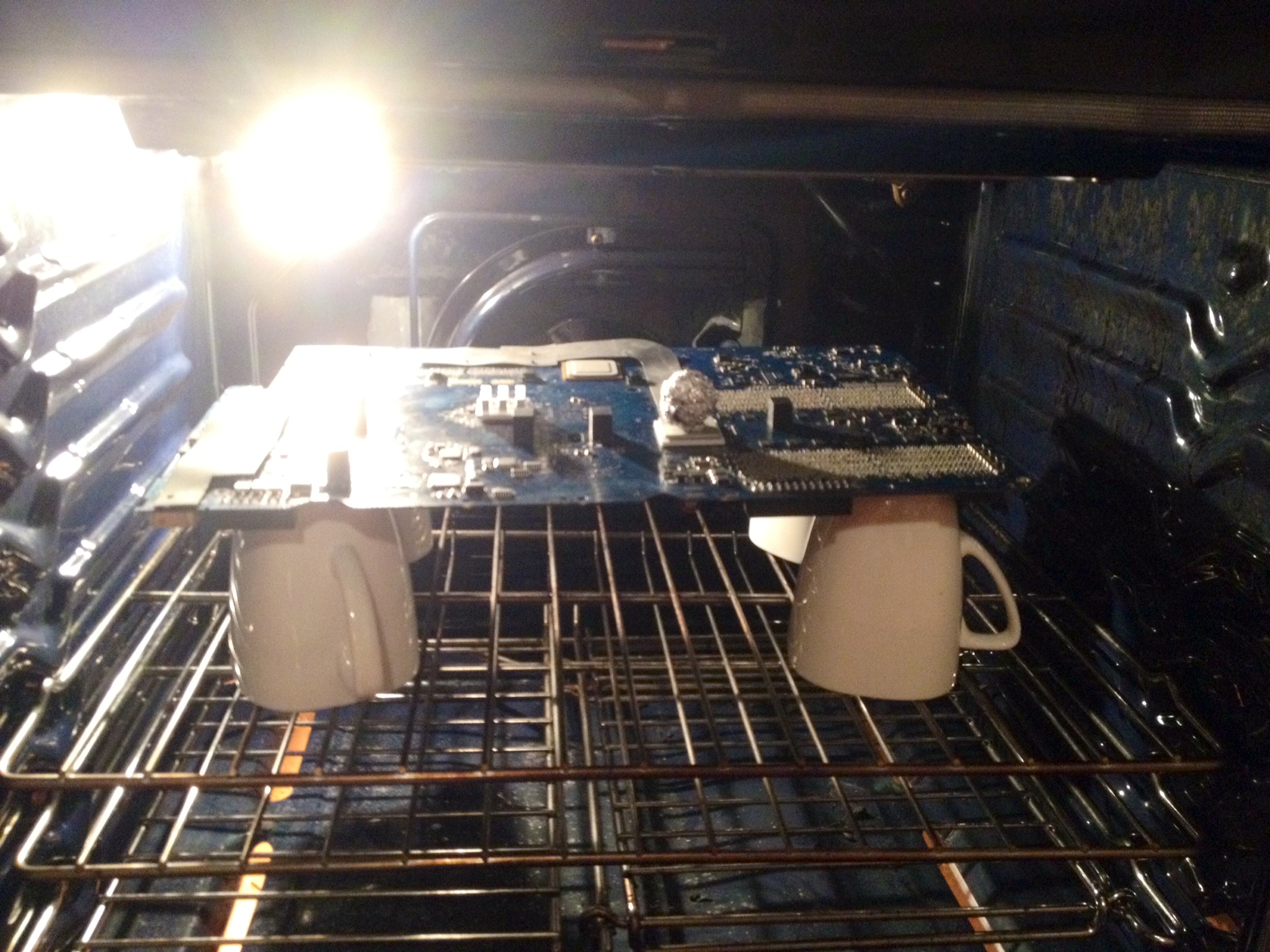

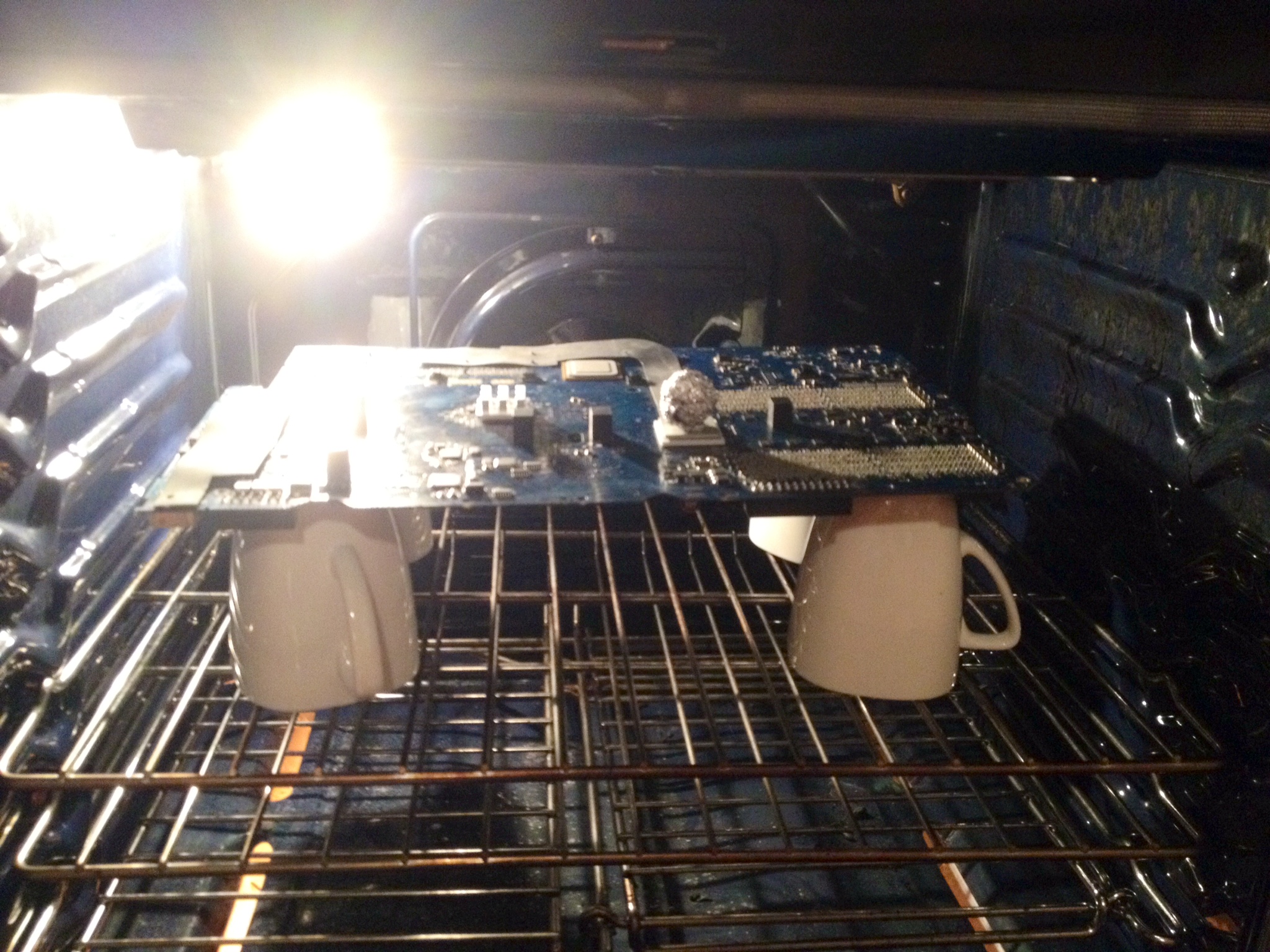

Going to oven it? I did mine for 7 minutes at 300*F with 4 coffee mugs under it. Put a foil ball on top of the chip so it has some weight to push it down. Works great still to this day. But I am still SOL on ram, max for me is 4GB. If I put in anything more it freezes up.
No I'm thinking heatgun method, I have infrared thermometer and I will probably put piece of solder to the center of the chip and use it as additional indicator of temperatures.
