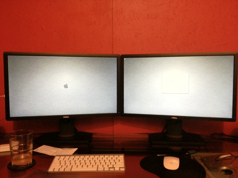

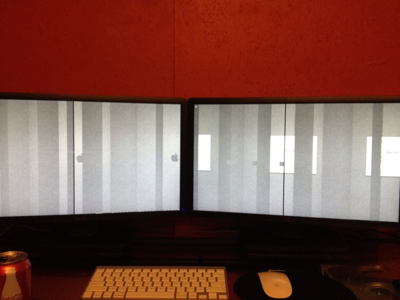

I have a late 2005 G5 2.0ghz with a nVidia 6600LE video card. I got two Dell P2412H 1920x1080 monitors yesterday and I plugged them in and I got weird lines on both monitors. When I log in and get to the display settings and click a random resolution the monitors will go blank then switch to that non native res and it looks fine. After that, I click 1920x1080 and the monitors will display fine. So from the looks of this the computer can handle dual 1920x1080 but why is it on start up I get video artifacts? Thsi post on the apple support communities describes my problem exactly:

Its that graphics card pal, I had the exact same setup as you and the same issues. That card is an absolute joke, as it's only 128mb. It doesn't have the juice to push 2 full HD monitors. I bought a 7800GT off ebay and flashed it for £20, that fixed it. I later updated to a Quadro FX 4500 512mb, which is even better.
I know you say after boot up you can click 1920x1080 and they display fine, but thats a hassle every boot up. Just get yourself a new graphics card mate.
Dont really want to spend any money on this machine and the specs said it should be able to support 1920x1080 on both DVI outputs so I started to look for more problems that can cause this. From my PC overclocking days I knew veritcal artifacts are usually heat or ram related so I took a look at the card and on the bottom of it (opposite side from heatsink) there seemed to be some deposts on the PCB. Possibly from being used in a humid environment mixed with corrosive dust. I took the heatsink off the card and gave the whole card a good alcohol bath with a toothbrush. Re-Applied thermal paste and it works dandy now. Thanks guys!

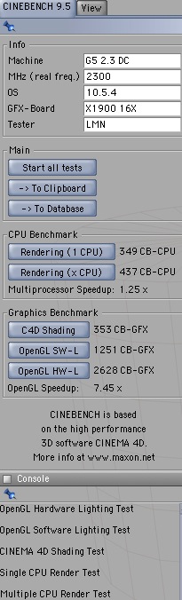

Xbench
512GTX OpenGL Graphics Test 94.66
Spinning Squares 94.66 120.08 frames/sec
X1900 OpenGL Graphics Test 126.47
Spinning Squares 126.47 160.43 frames/sec
CINEBENCH 9.5 (attached)

That makes us 3 then me you and the guy I linked to. The problem is pretty much fixed I must have done over 15 reboots since and it came up perfect everytime. The combination of things I did was clean the corrosion off my graphics card which was probably from high humidity and dust build up. Sprayed my PCIE slots with an air compressor. With the power connected, I pressed the SMU clear multiple times since once didn't work I was getting desperate 😀 and I also did the NVRAM reset. I did all of this pretty much at once so I dont know which actually fixed it. When I was cleaning the graphics card with alcohol (bare in mind you must have new thermal paste to put on the graphics die if you want to take the heatsink off because the old stuff was dried) the computer was unplugged so this could have also reset any other ailments. Good luck to you!
And thank you for the graphics card suggestions And all of those graphics cards I think are good for the era. I had a 7800GTX my self in my gaming pc when they were the best graphics cards out back in 2005 I think. (now I am eyeing that GTX 590)
A wierd thing that occured after I fixed the problem was that the apple logo on the grey boot screen is now the wrong resolution. Before it would be the correct resolution but then the log in screen and everything else would be artifacted. Now its distorted and everything is fine but I don't know why
Perfect now on boot
