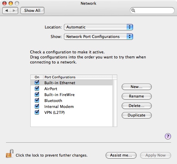

I'm not sure about the PCI card replacement, but check to make sure that the Ethernet port is actually active. Here's a screenshot of my Network Port Configurations. Ethernet is on the list and active (checked). Also, make sure that nothing is ahead of it, like your AirPort card or modem. If it's not in the list, you can click New and select the interface.
cpjakes
duh... i didn't even think to do that. thanks cpjakes! i hope its really unselected. 😱
