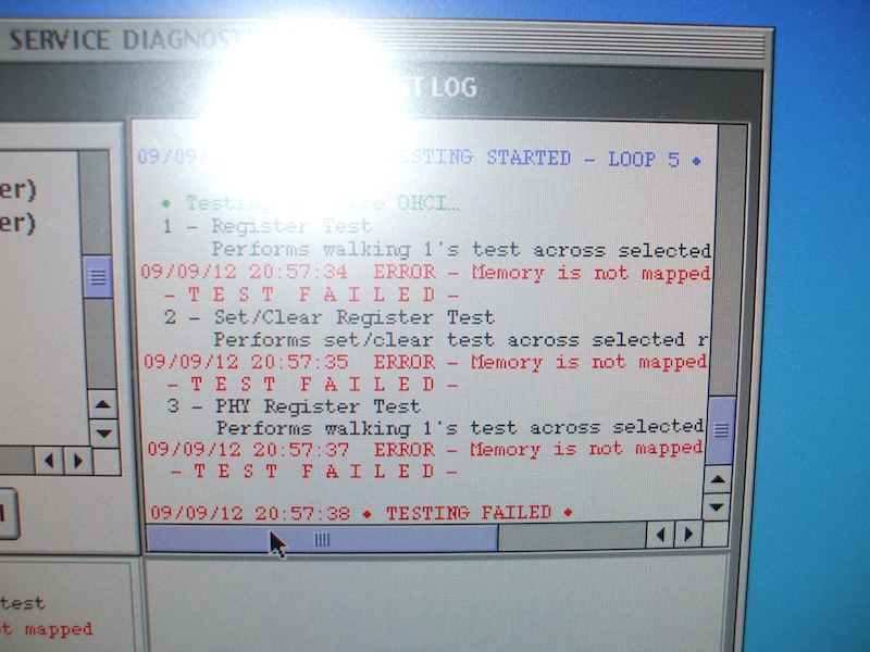

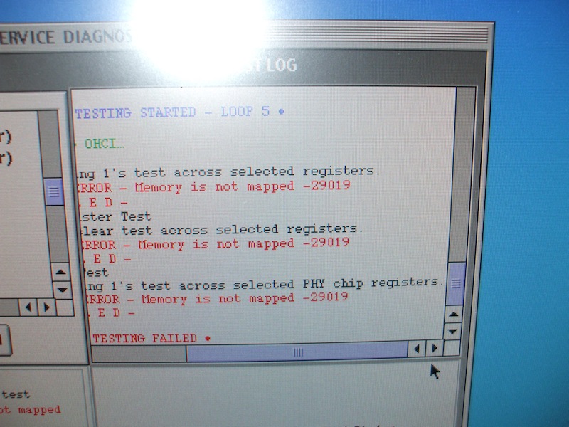

Yes on the reset, disc and chime. Which test shoud I run under ASD?
Here is a screen shot of the failed Firewire

The logicboard's FireWire chip is dead. The only way to fix that is to replace the chip via soldering or replace the logicboard.
The FireWire is the only issue. Everything else passed with 5 loops. I will just toss in a FireWire pic card and call it good.
