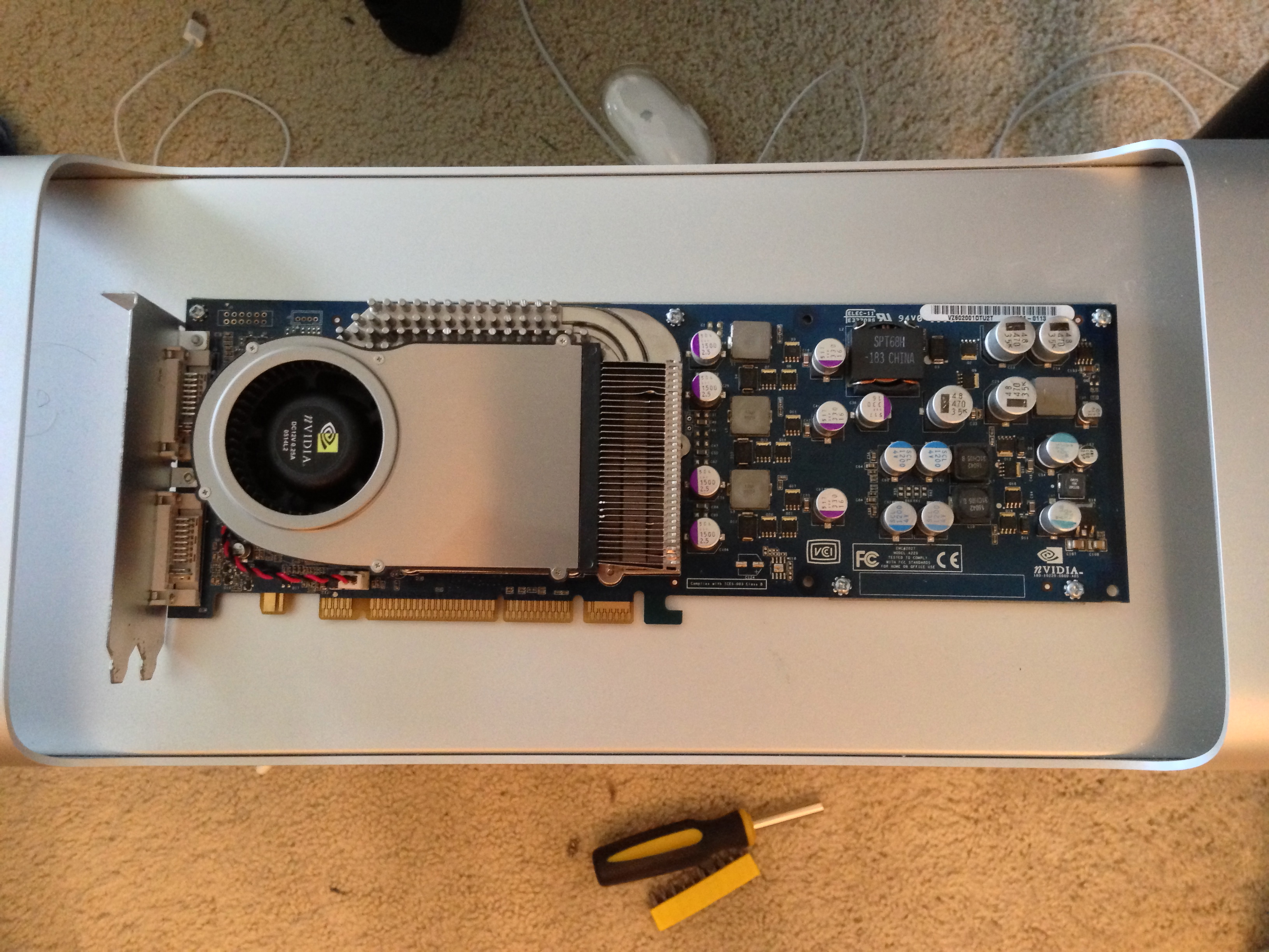

I've got a 6800GT DDL if you want it. It was baked after displaying minor artifacting, but it works beautifully now! I've got a 6800 Ultra in my G5 now so I don't need it, and I always have my 9600 Pro as a backup card if I really need it.
