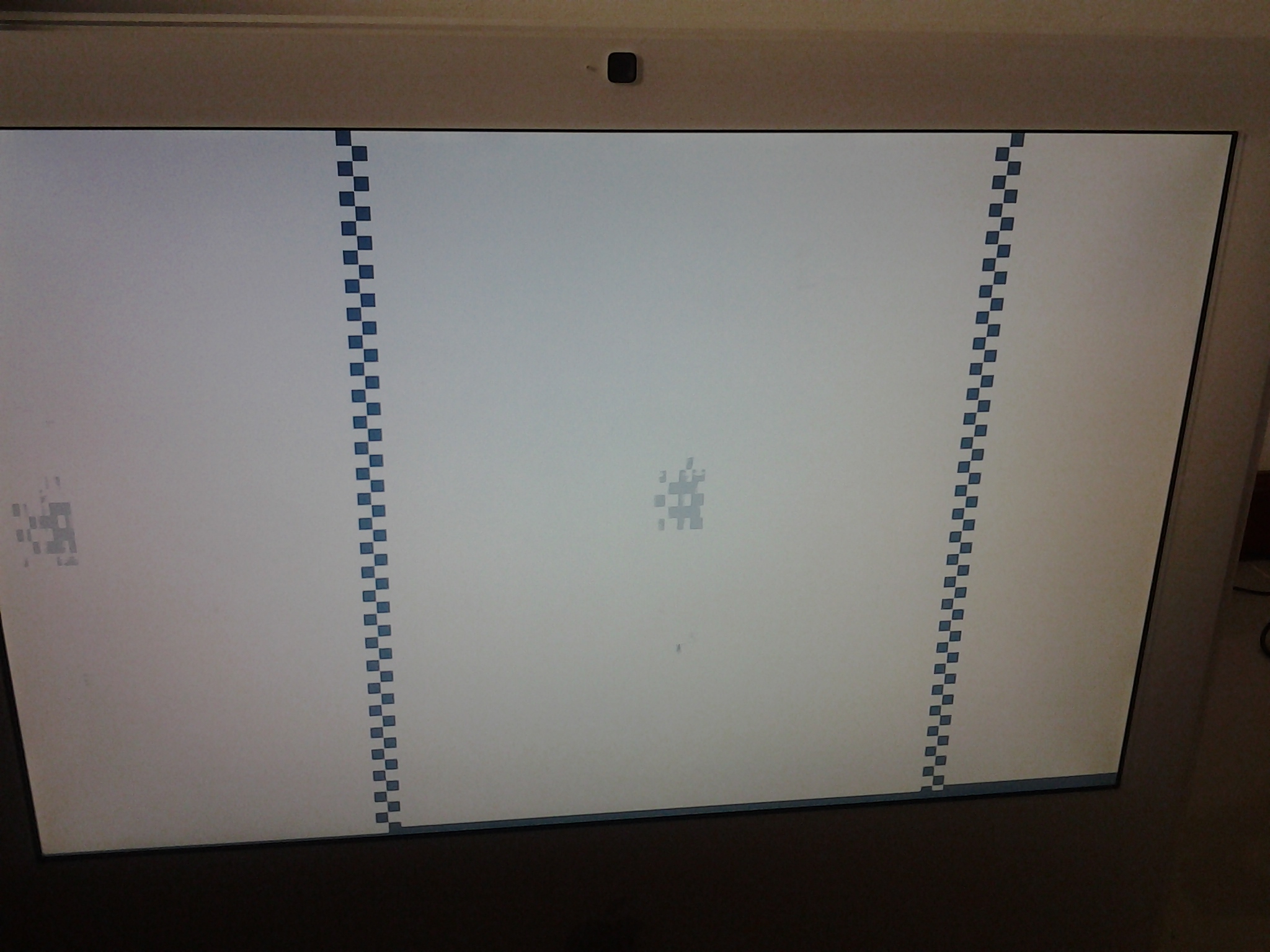

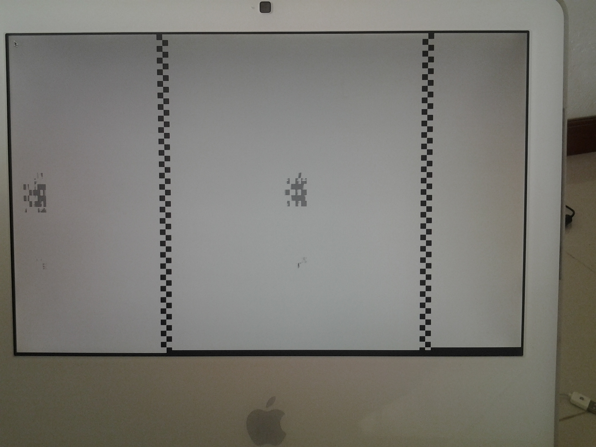

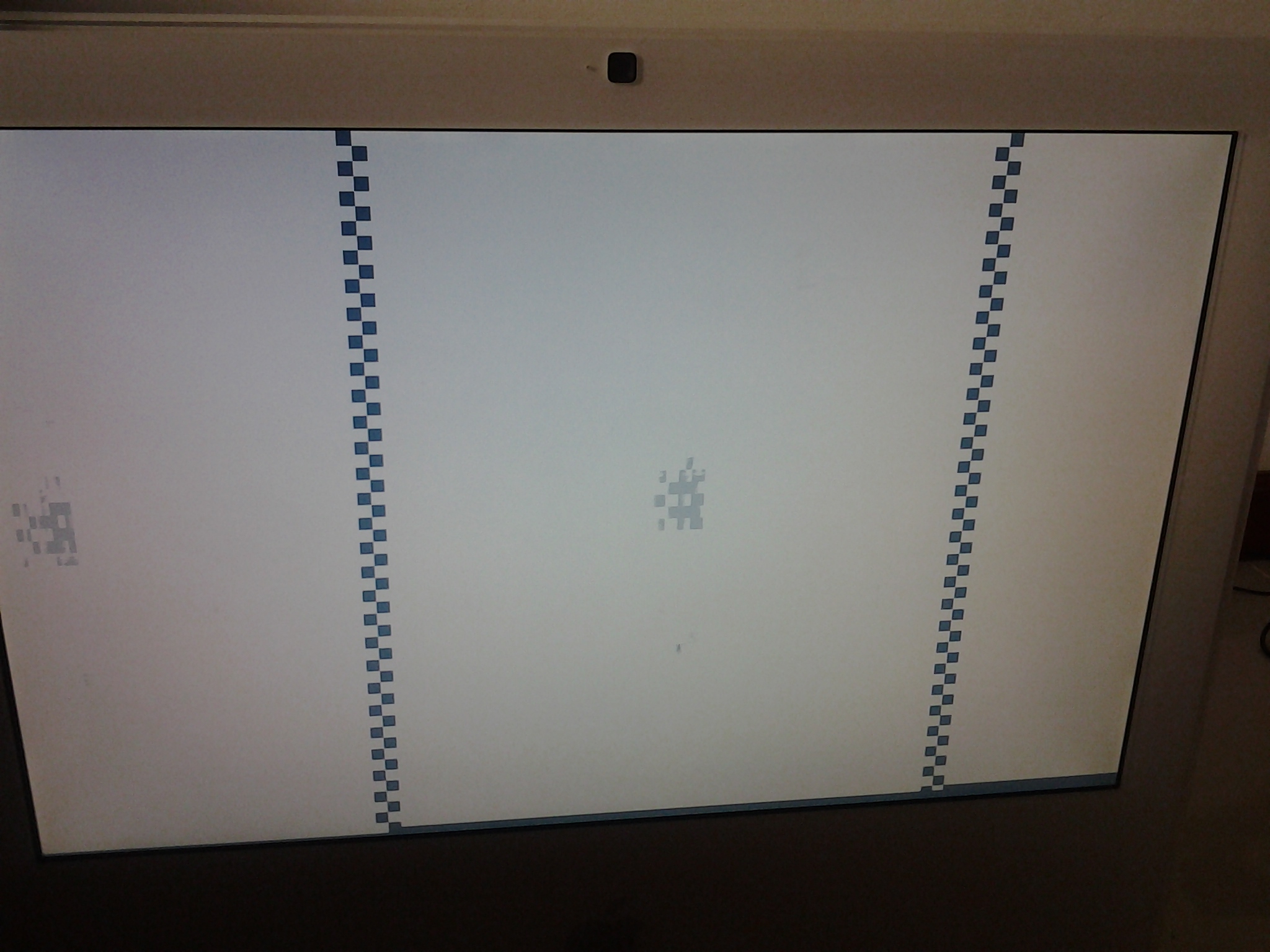

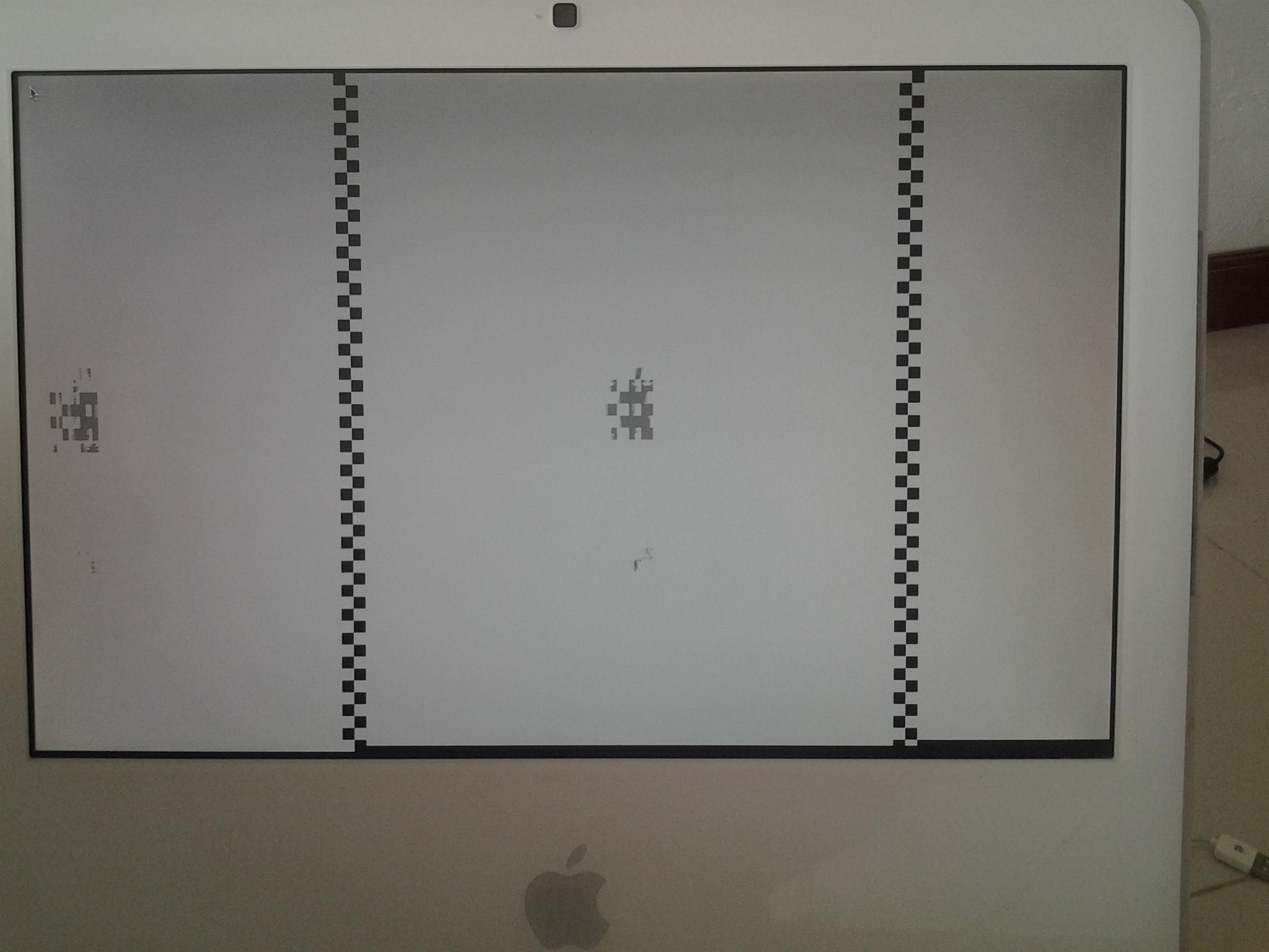

hi i have an imac 17 that wont boot at all tried every command on keyboard on start up nothing work its as if it isnt registering the commands.
the screen stay with with black cubes and can see the cursor but then nothing?
check the photo attachment so you can see what i mean

Looks like your GPU has died.
You could try to connect a different wired keyboard and Holding shift when you start up.
Also, try AHT, if you can.
AHT= Apple Hardware Test.
gpu

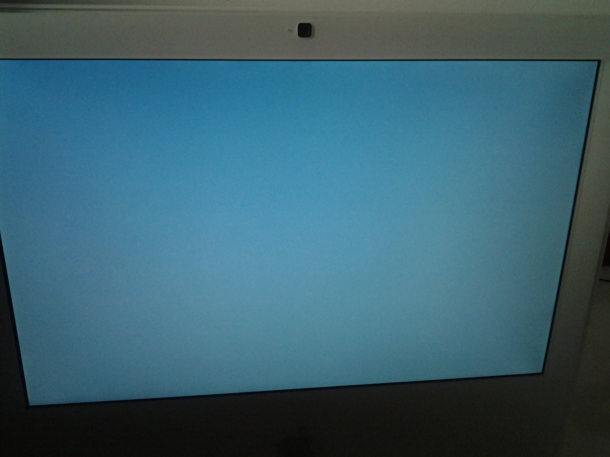

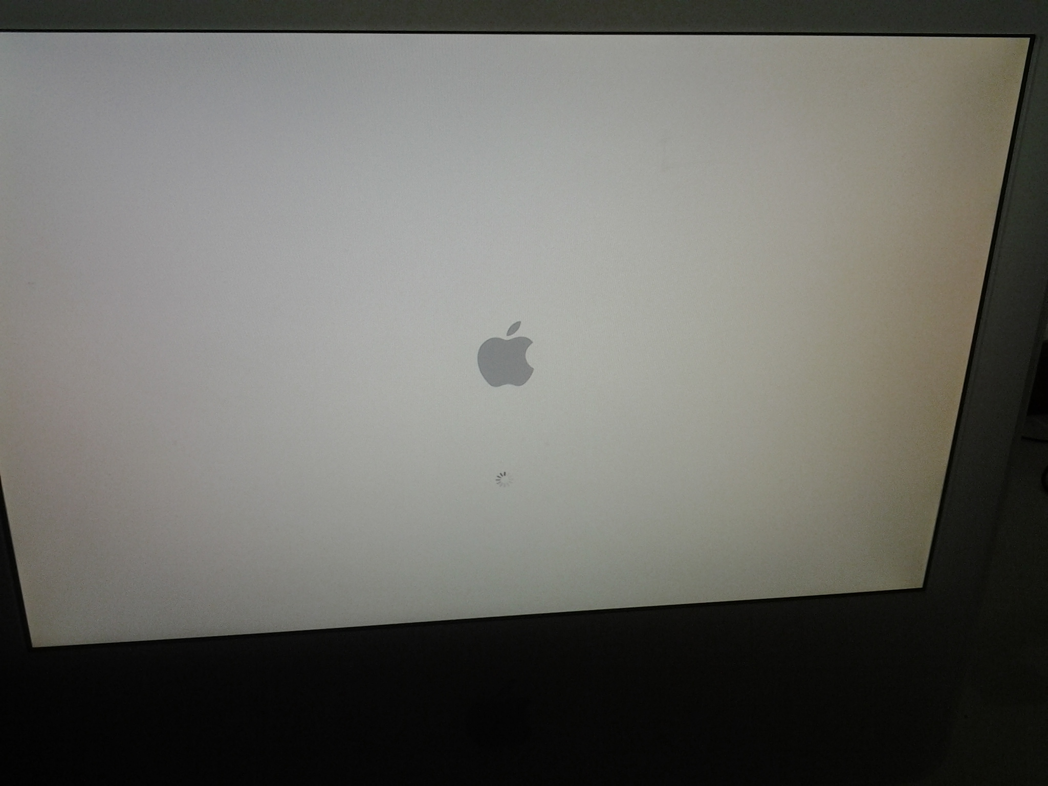

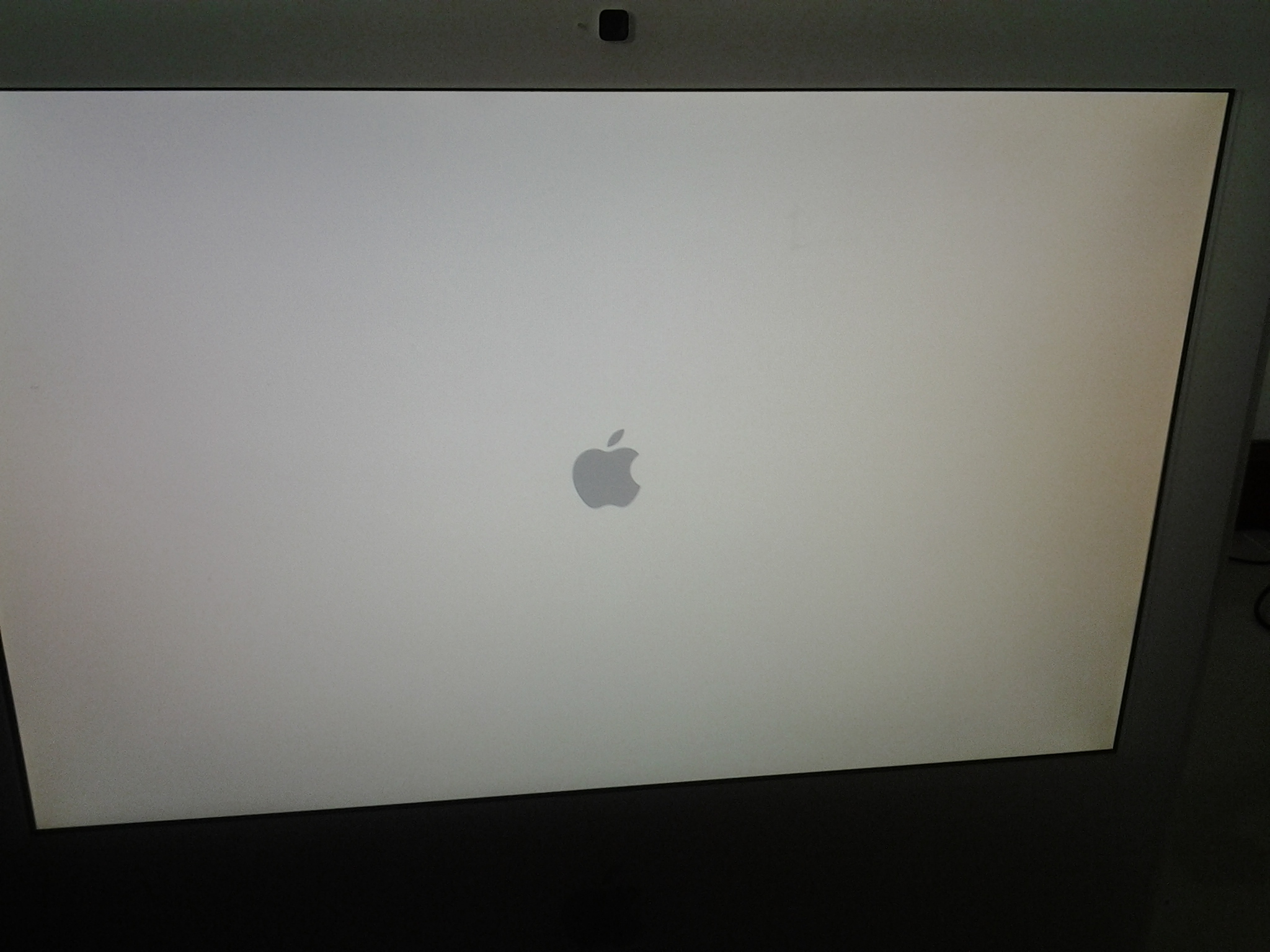

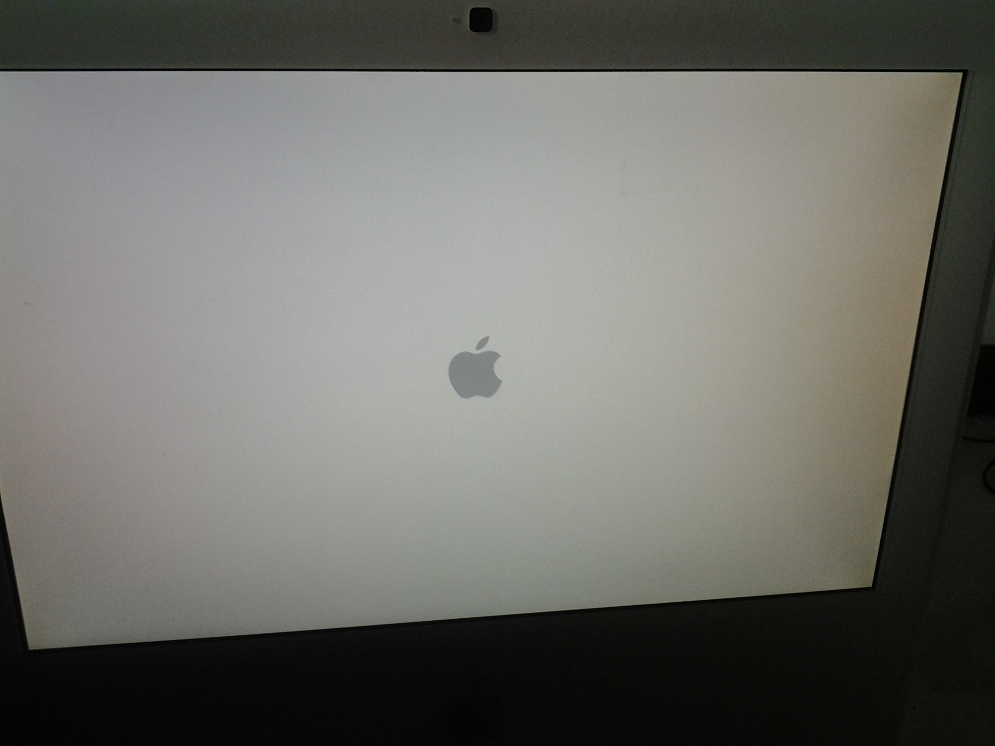

when the mac start it shows the apple on the loading screen after it pass that screen, i get a blue screen the it come to this screen.

here are the screens i get when i start the mac

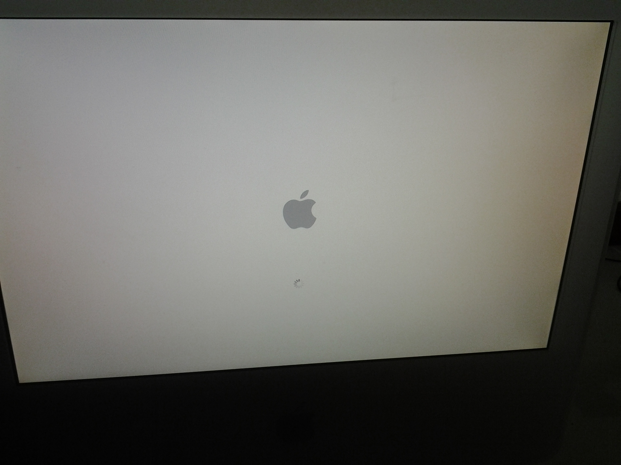

but now im stuck i cannot get to safemode or anything it just stays on the Gray screen with the loading circle and never go beyond that.

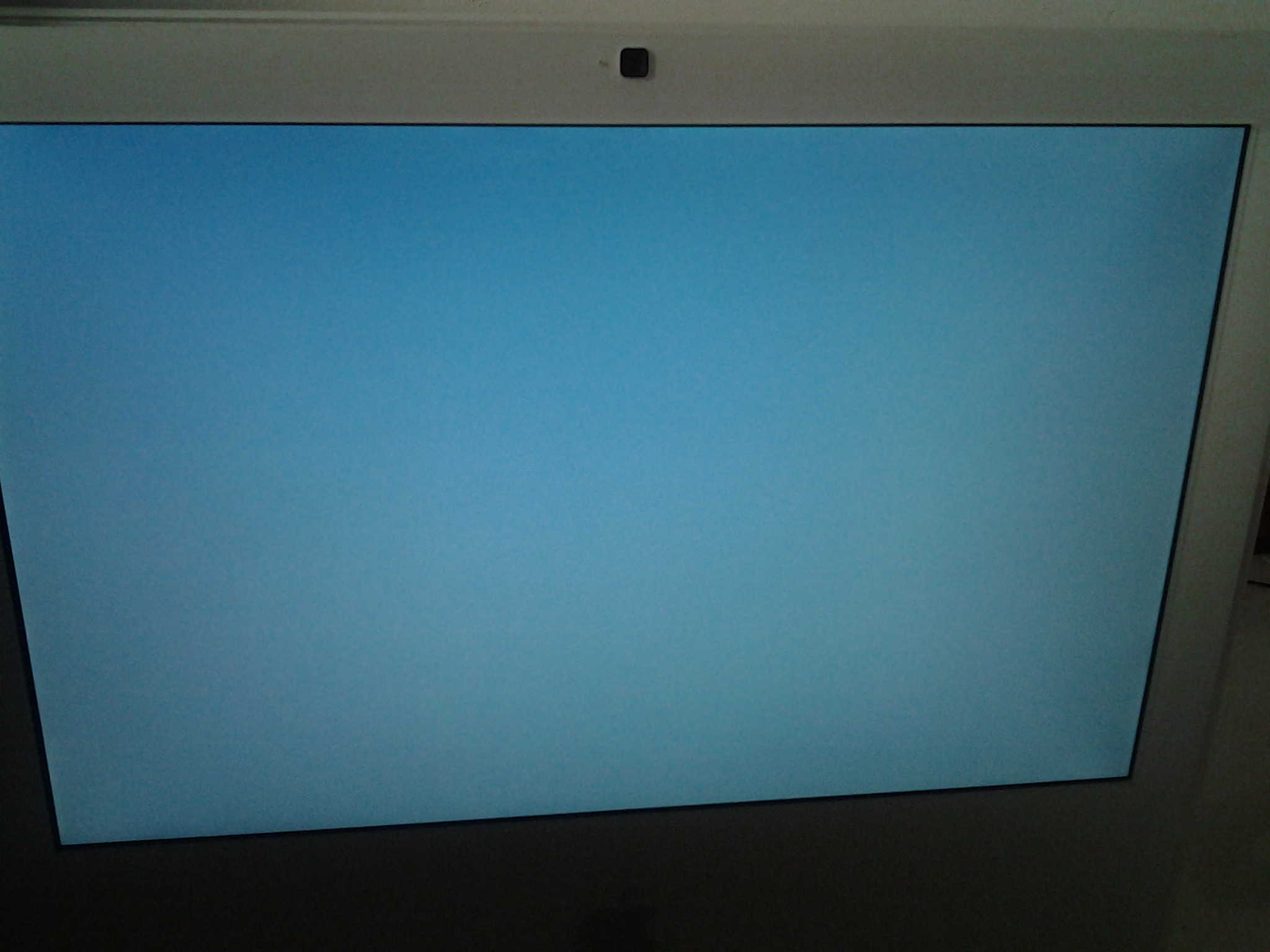

i would reinstall if i could but the problem is that it wont boot the disk. if i press c on start up it boot on the disk but i end up with a blue screen with a cursor that all it wont load anything. i dont no if its the graphic card or what but in safe mode the graphic was loading fine so where is the problem i dont know.
