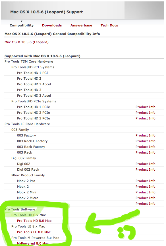

Also.... try restoring from a previous backup... as protools 7 doesn't work on anything above 10.5.4..... I just had a friend who had the same problem... and I had to lend him my copy of 8!!!
Hope that this helps... It may be the time to upgrade to protools 8... it's only like £100
Jack
Just to highlight the point that ProTools doesn't work with 10.5.6....

Haha, wow! Thanks alot guys! I'm new to mac and didn't realize the compatibility issues, I feel dumb. 😛
Is there any way to backtrack the OS into going back to an earlier version of OSX? or would I just have to upgrade to PT8 to get it to work?

I would recommend just upgrading to PT8... as well... it has alot... i mean alot better midi....
However... if you cannot afford to upgrade.... I'm afraid that you might have to end up reinstalling the os...
You can reinstall the OS from your original DVD's.... but... you will then need to install the 10.5.4 Combo Update.... http://support.apple.com/downloads/Mac_OS_X_10_5_4_Combo_Update
It is a little large... but not to bad....
Before you do all of this... you MUST have a whole disk backup... e.g. with SuperDuper or Time Machine... this will save you a whole lot of pain 😀
Once you have done a clean install and installed 10.5.4 just use Migration Assistant to restore your mac's applications and settings and other stuff from your backup....
