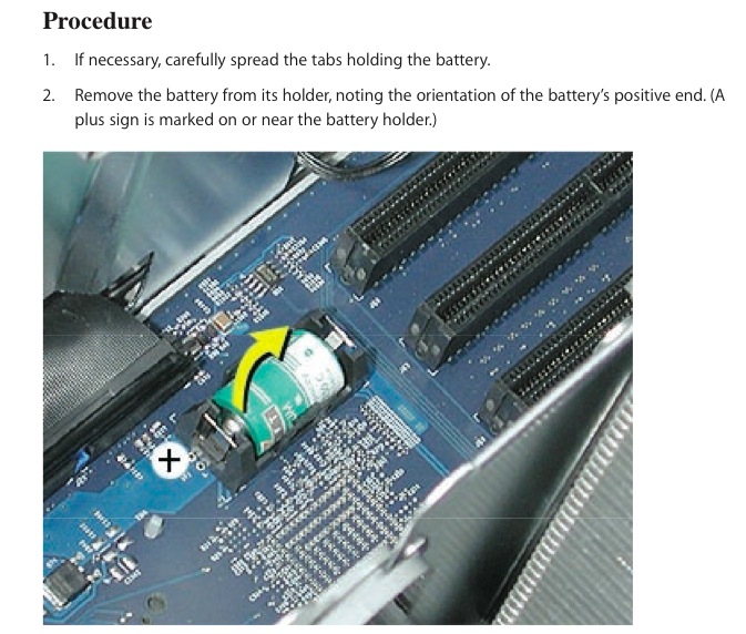

its not a button battery... see attached photo. But this battery can be acquired at Radio Shack as well... a little pricy at like $15-$20
If this doesn't work it may be the power supply. Those had that issue quite often, and is a real bear to work on, even as an experienced Mac Technician.
If it is the power supply, pull the drives and get a replacement on CL... Mac Pros are like $1000 or a put your drives in an enclosure and use a mac portable... even a borrowed one ;-)

walterwhite tnx for your answer,
i'll try to get new battery now and hoping it will fix the problem... if not, i wont get new power supply (couple years ago i had to replace it, and it cost around €400...), since my original plans was to keep this machine until the new mac pro's coming (i hope soon....), i will continue with plan B, connect the studio to my MBP, and with this i can run 80% of the hardware in my studio till the new mac pro's coming....
ps - tnx for the tip about HD enclosure, but i have backup HD's, so i can continue the work where i stop, as soon as i'll setup the MBP... 😉

tried to find new battery, but no luck... the only shop that was open didn't have what i was looking...
so the last few hours the mac was without battery and without electricity (i toke the cable out before i pop out the battery), and now i decided to check it one more time, but without the battery... well, its back from the deads 🙂 working again, just had to fix the clock... even i finished to install all the plugs, made reset and still running normal...
how bad you think it will be to run it without the battery ???
and should i keep it always on 24\7, coz im not shore if it will start next time ???

again the mac not starting... still dont have new battery (yesterday it start without it, and worked normal...), will try to find\order new one tomorrow...
i was checking the cooling system today as well, after i was reading about 'LCS'... and it don't look like there is some kind of leaking...
for now i toke the electricity cable out, will let it sit like that for couple hours (like yesterday,after i toke the battery out...), and maybe when i'll connect it again, it will start... 😕
