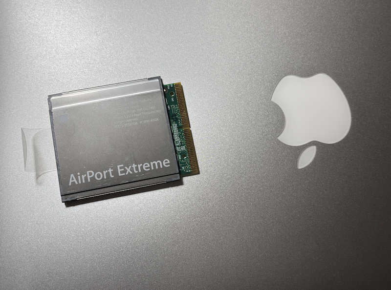

I just found this old airport, which I have here at home, could it be useful?
Should I make the right change to the connection cable?
Thank you Sir.
Yeah, that is the exact type of card I am talking about. It will work with the cable from my Amazon link as long as you trim back some of the plastic and metal around the connector on the card itself. You would then need to cut off the other end of the cable and solder it on to the stock antenna. It can be quite tricky to get the antenna out and also a little tricky to solder a thin coax cable like this, but I managed to do it so I know it is possible. I have a bunch of photos of the process and have been meaning to make a post on it, so maybe I'll be able to get that done soon.
