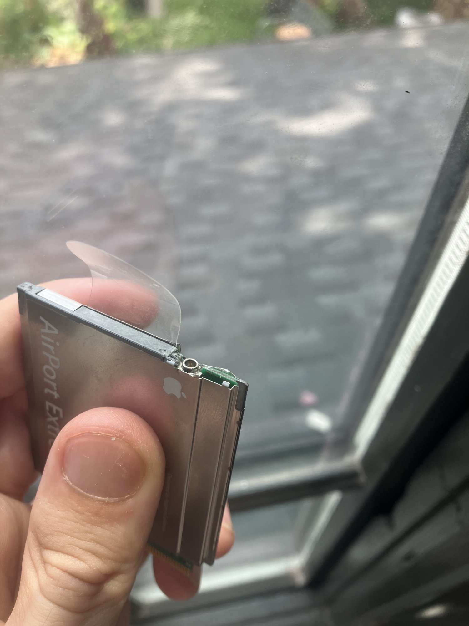

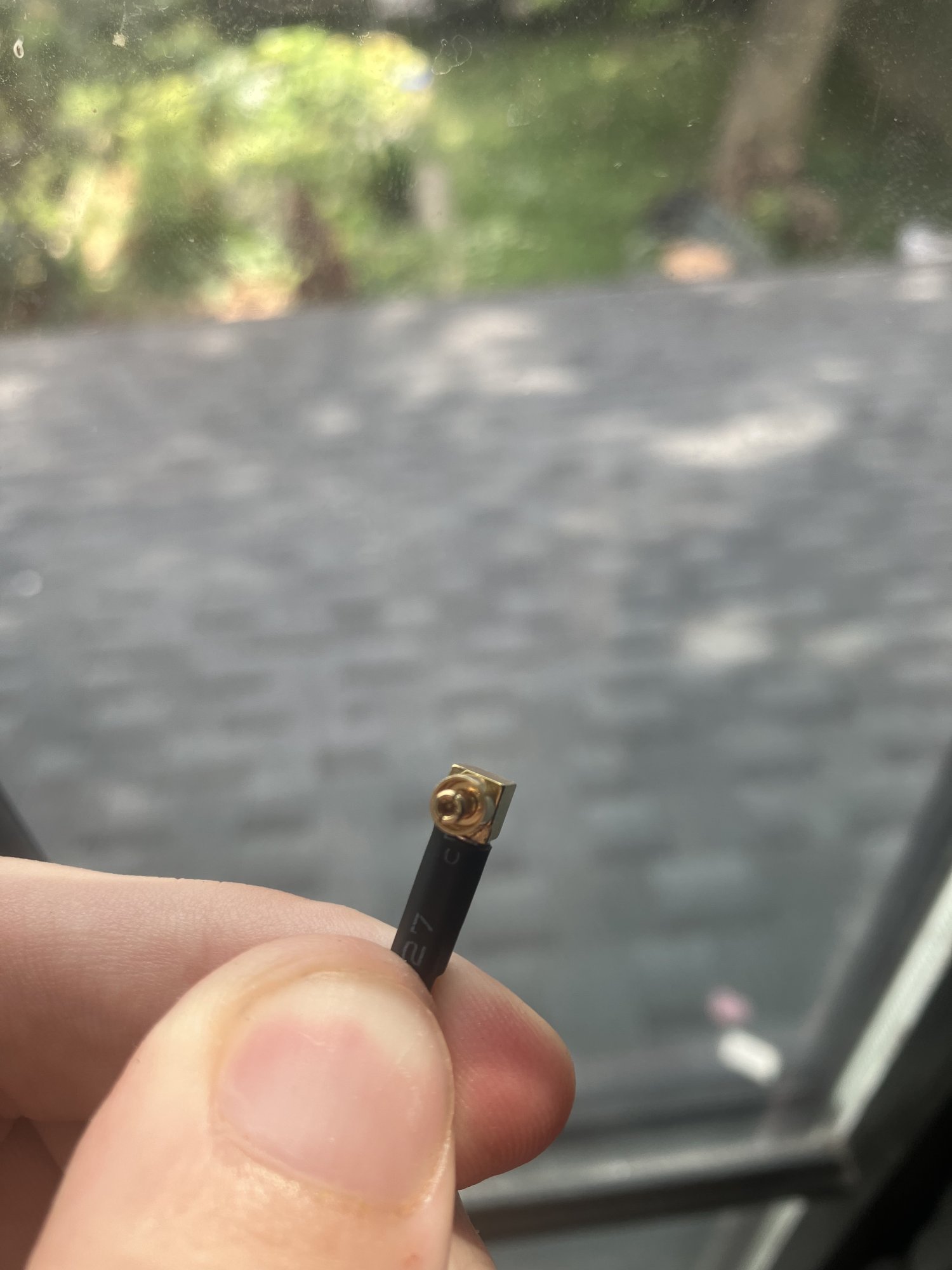

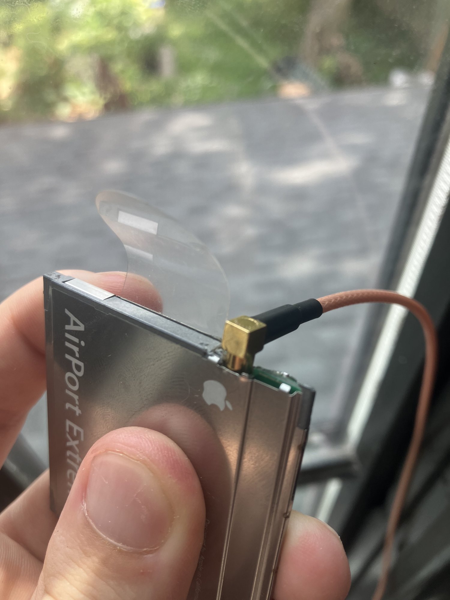

The connector on the AirPort Extreme is an "MC Card" connector. I found an MC Card cable on Amazon that has a good length to it. The exact connector on the AirPort Extreme seems to be a little narrower than most of the MC Card connectors that you can find, so it will require trimming away some of the plastic and metal to make it fit. Below are some photos of the cable and modifications to the AirPort Extreme card:

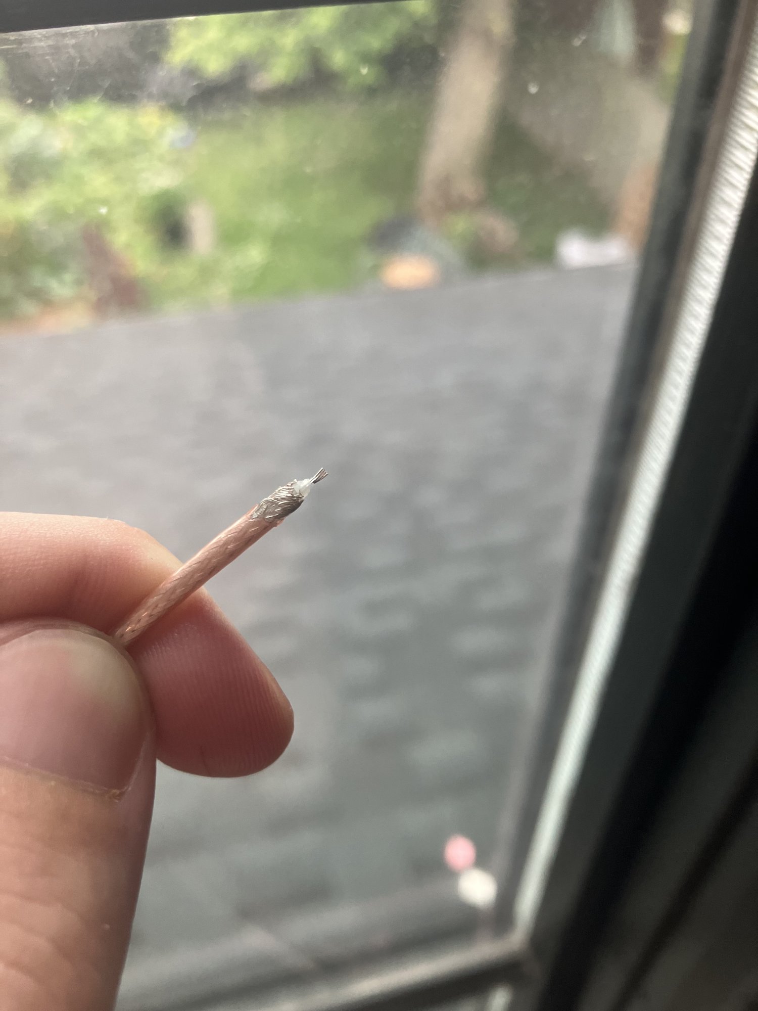

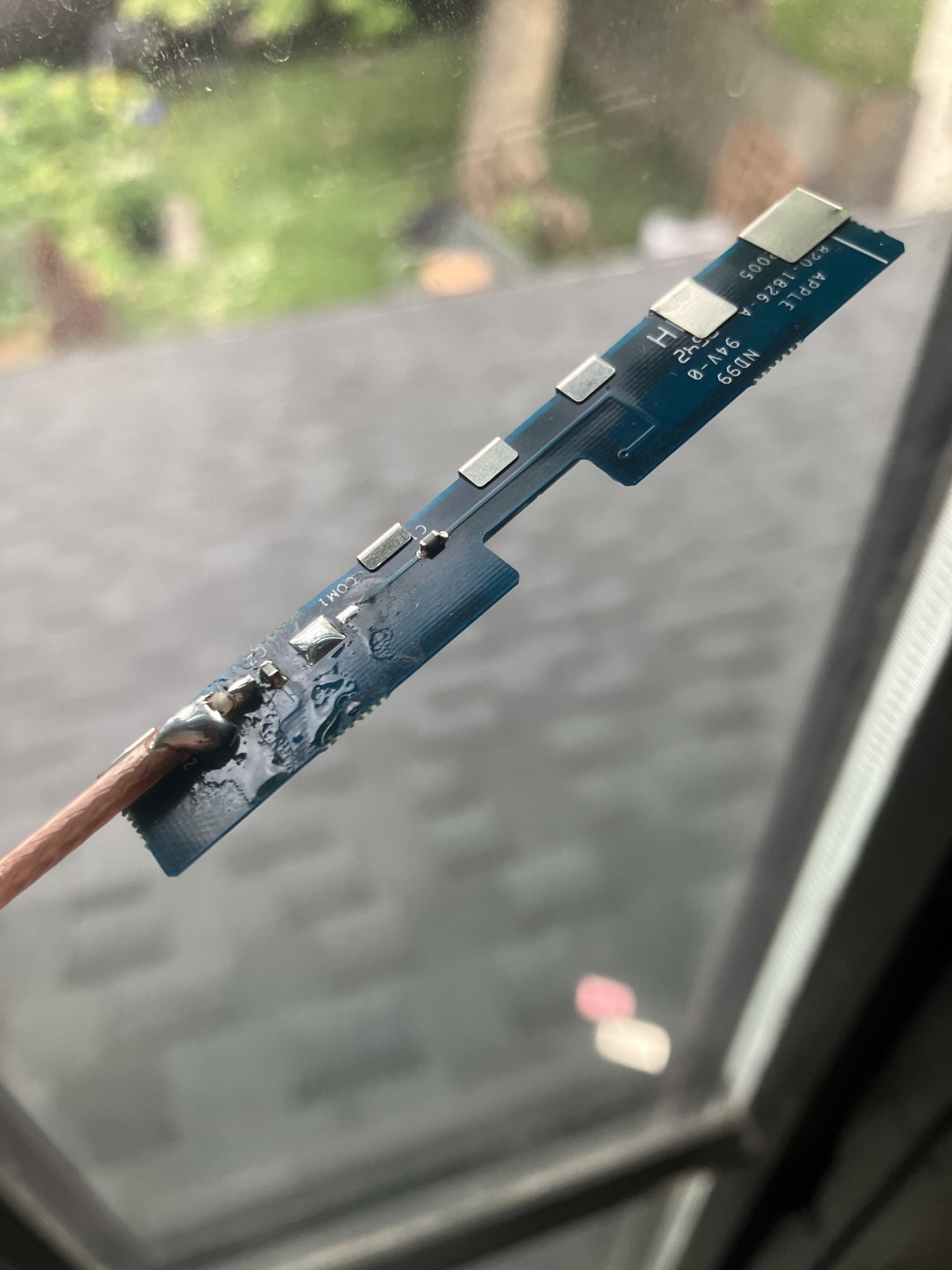

Once your card is modified, you will need to set about removing the stock cable and antenna. Sadly, the cable is routed behind the logic board, so removing it requires removing the logic board from the machine, which is quite a chore in these G5s. Having the logic board out did at least give me a good chance to clean the heatsinks and apply new thermal compound to the chip back there. The antenna PCB is housed inside of the grey plastic strip at the back of the machine. Once you get it out, you will need to desolder the original cable. After the original cable is off, one end of the new cable can be cut, stripped, and soldered back on to the antenna PCB. Be warned that stripping and soldering the coax to the PCB is... finicky. Try to trim the braid back further than the insulator, but not so far that it can't be soldered to the board. Be careful not to create any shorts or the antenna will not work.

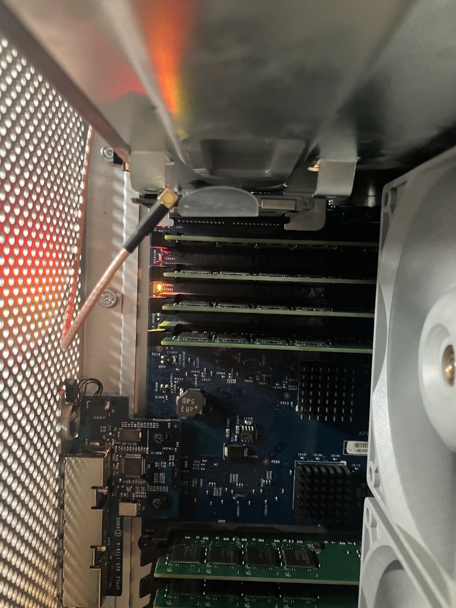

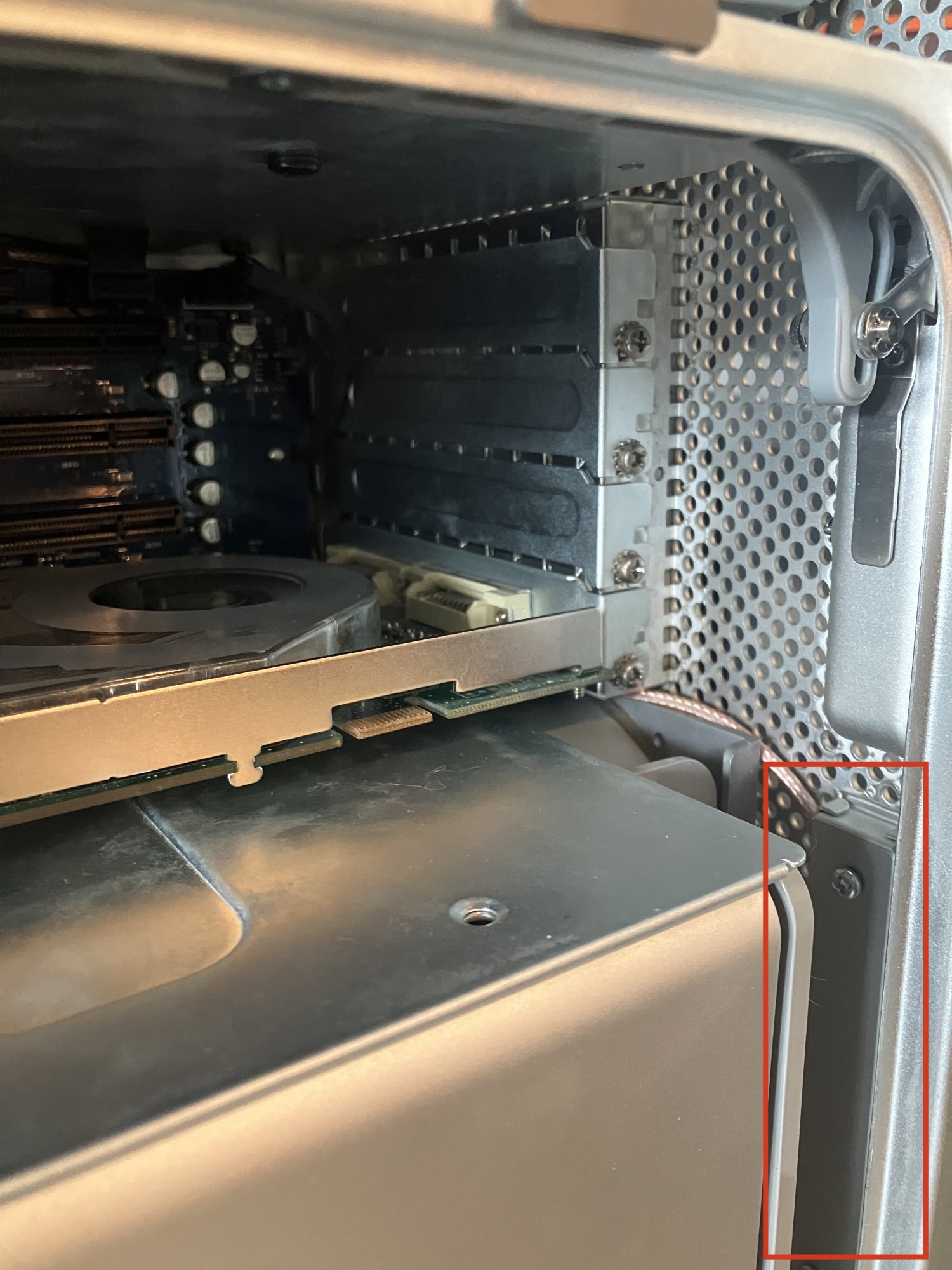

Once you have the modified antenna, you can reinstall it. I put my logic board back in first, then routed the cable above it so that it will be easier to reconfigure in the future if necessary. I have highlighted the location of the antenna in the photos below:

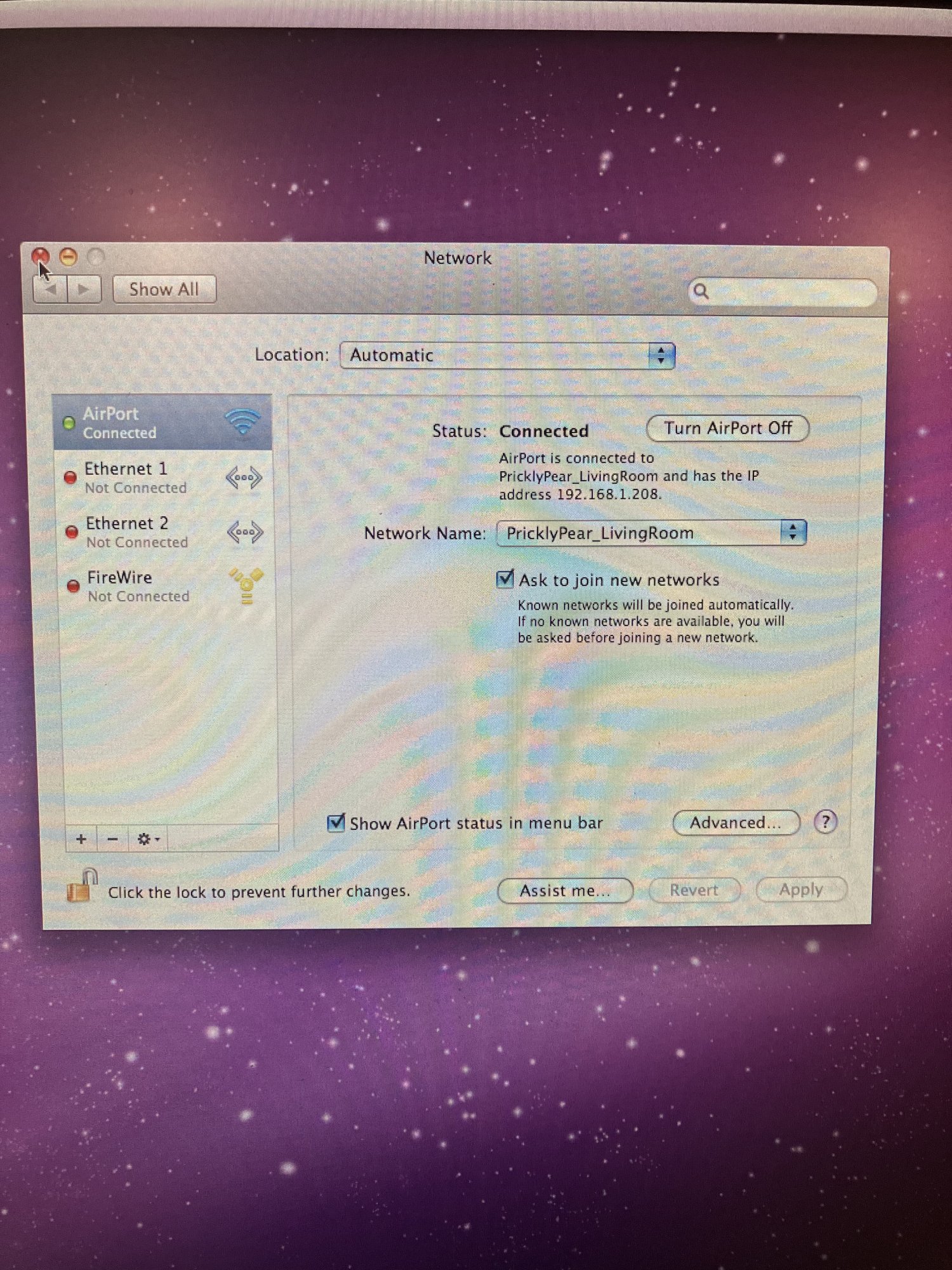

After all that, I have working WiFi in my G5 with no external components required! Enjoy the proof from my horrifically pink ADC HD Cinema Display:
