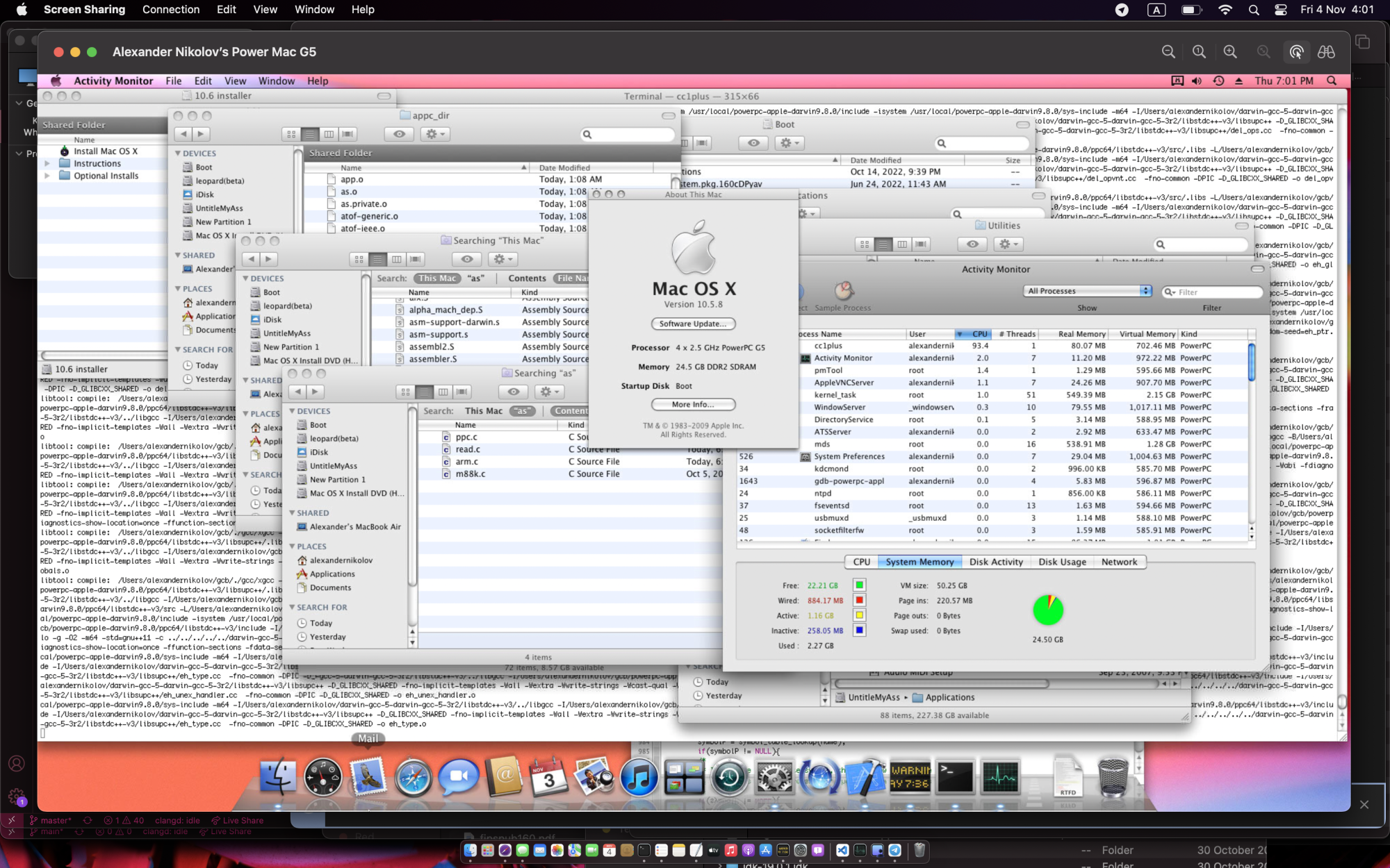

You boot from 2x <4GB sticks (on first 2 slots - which are the one closest to each other on both sides in the center) (hope that succeeds and you don't hear the telephone beep - you may need to try multiple times then - or buy Samsung sticks (or the same on as I have because they worked for me - models here (in the hex dump)- https://forums.macrumors.com/threads/overclocking-the-g5-cpu.2363051/post-31622390 ))
Rest of the sticks are 4GB sticks.
You then have (preferably) a boot-command that runs a script on your disk which extend the registered ram and boot OS.
Then you (preferably) start compiling Webkit on all cores on Gentoo and test if it works (if it hangs and crashes (after you have exceeded your original low capacity sticks size) you probably haven't aligned the offsets and sizes).
