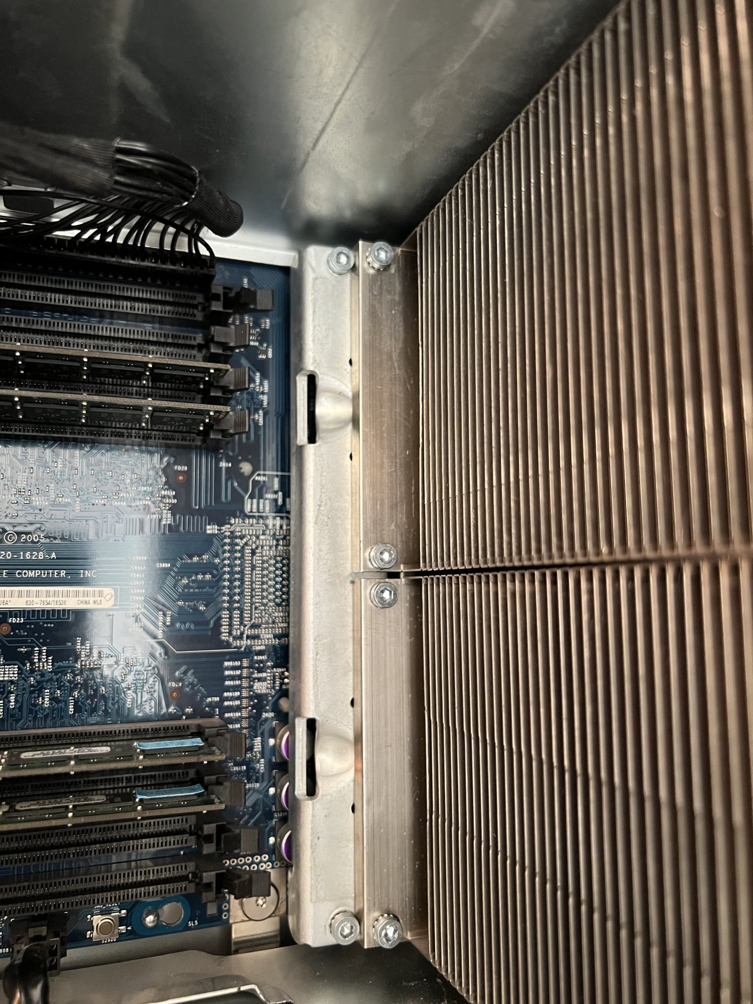

Here's the braket I used to mount the CPUs to the board

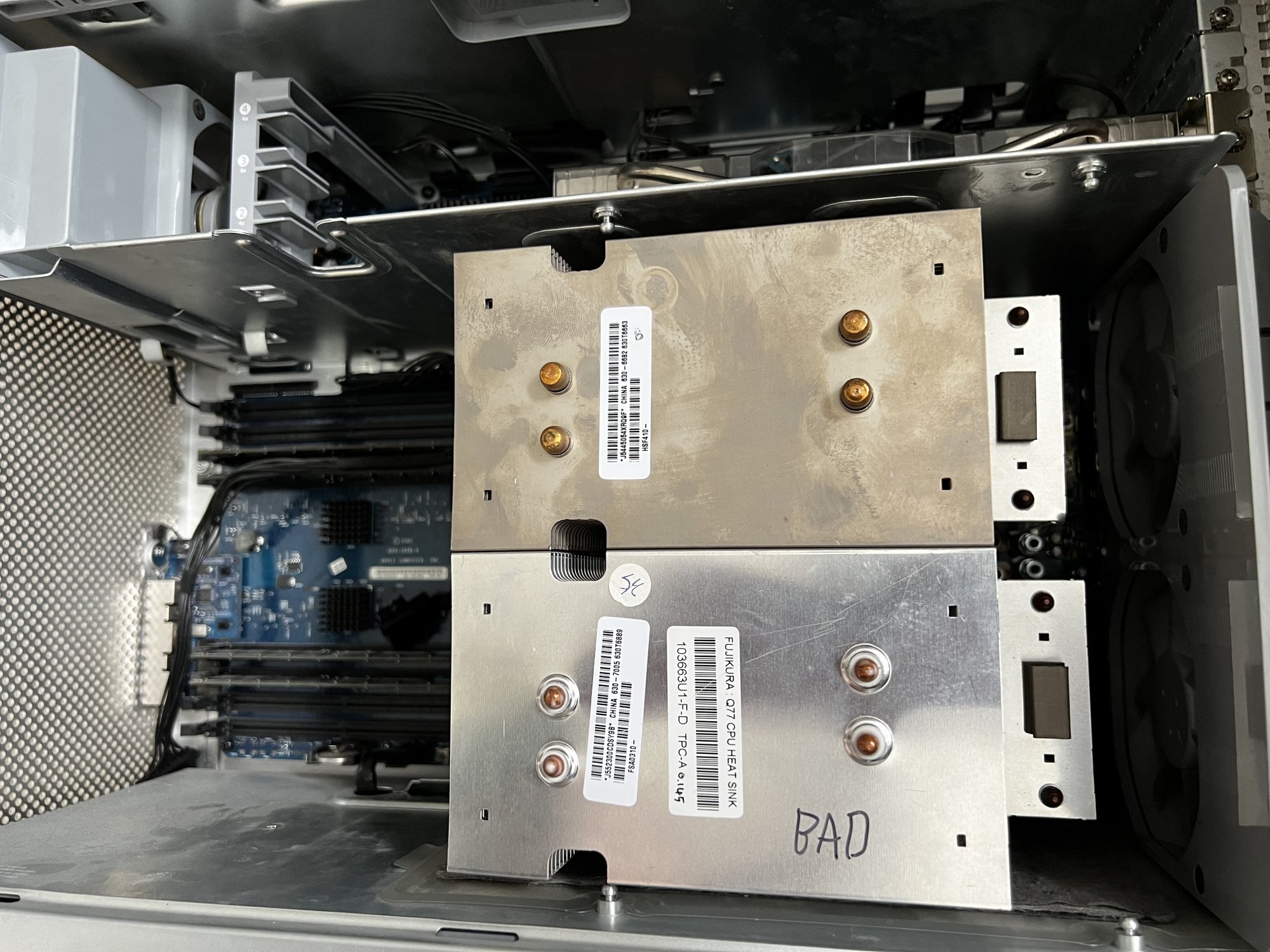

Here's the CPU heat sinks I used from the DP 2.0 (I think it was the 2005 model). Ignore the bad writing that was me labelling a bad 2.0ghz CPU.

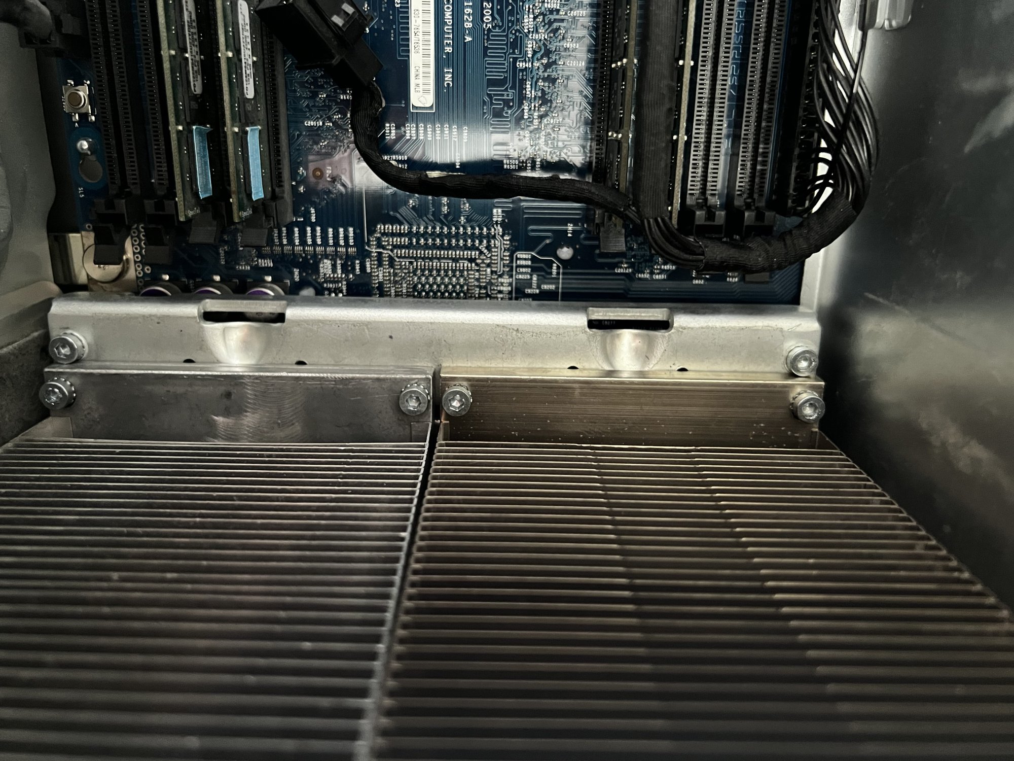

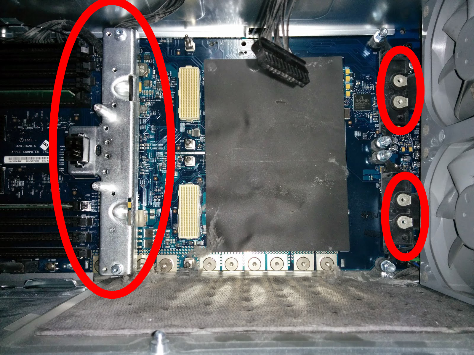

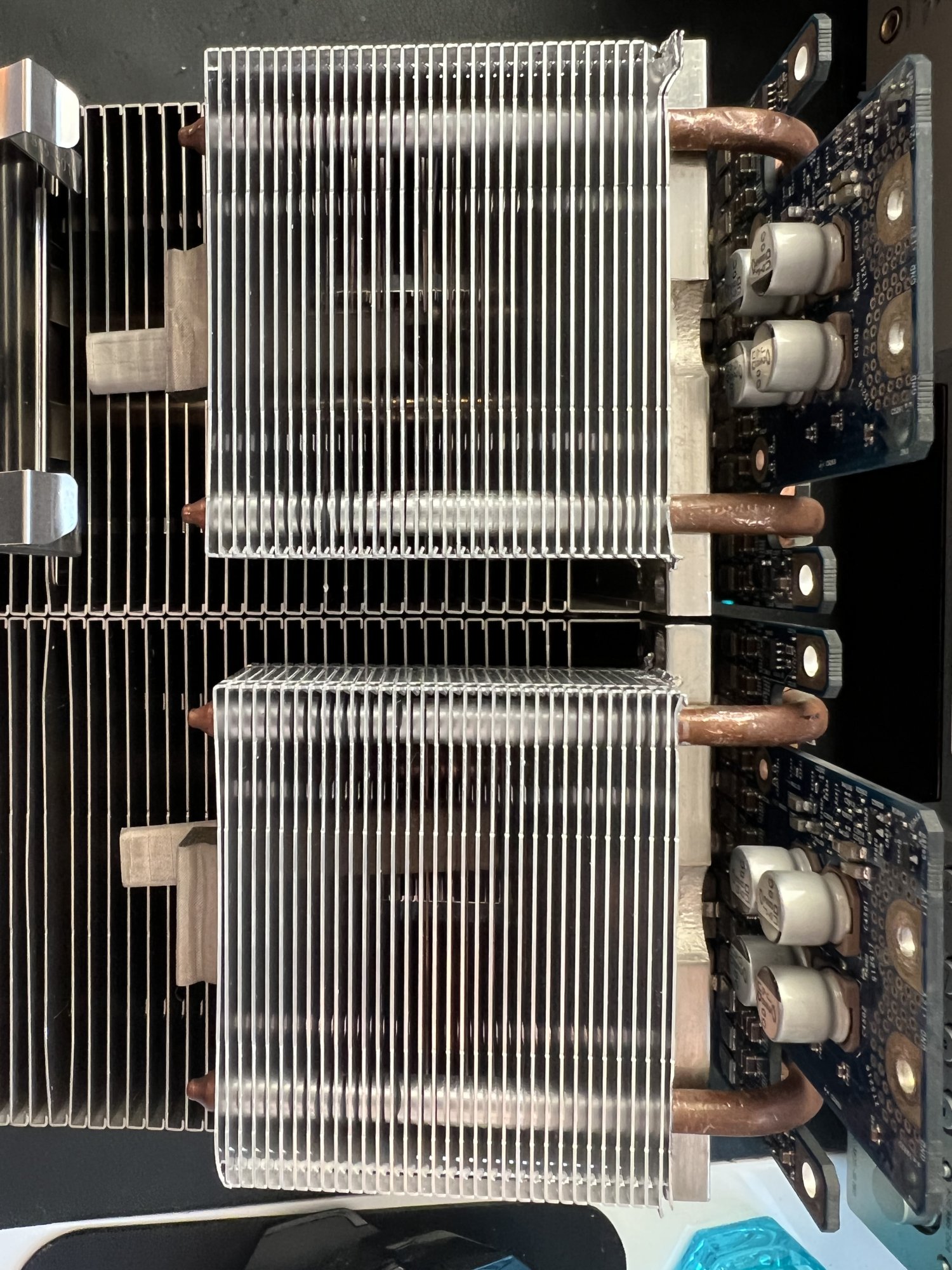

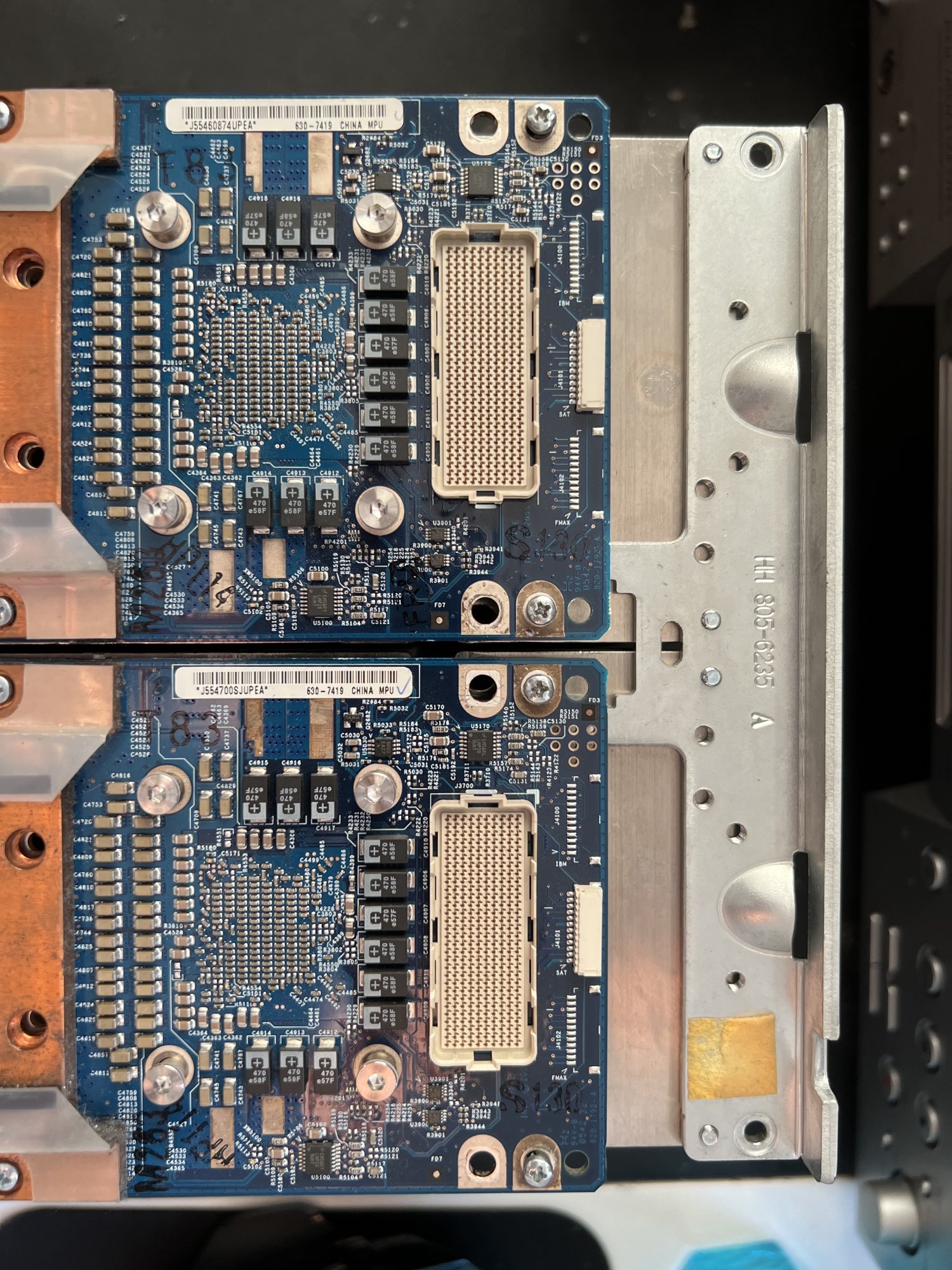

As for the method I used it's easier than most but it's a bit hacky and cheaty as the CPUs are only held on by four screws which is not ideal. I've taken some more pictures to show how I got it to fit. Shown below are the four points that will be screwed in (Photo credit cameron Kaiser).

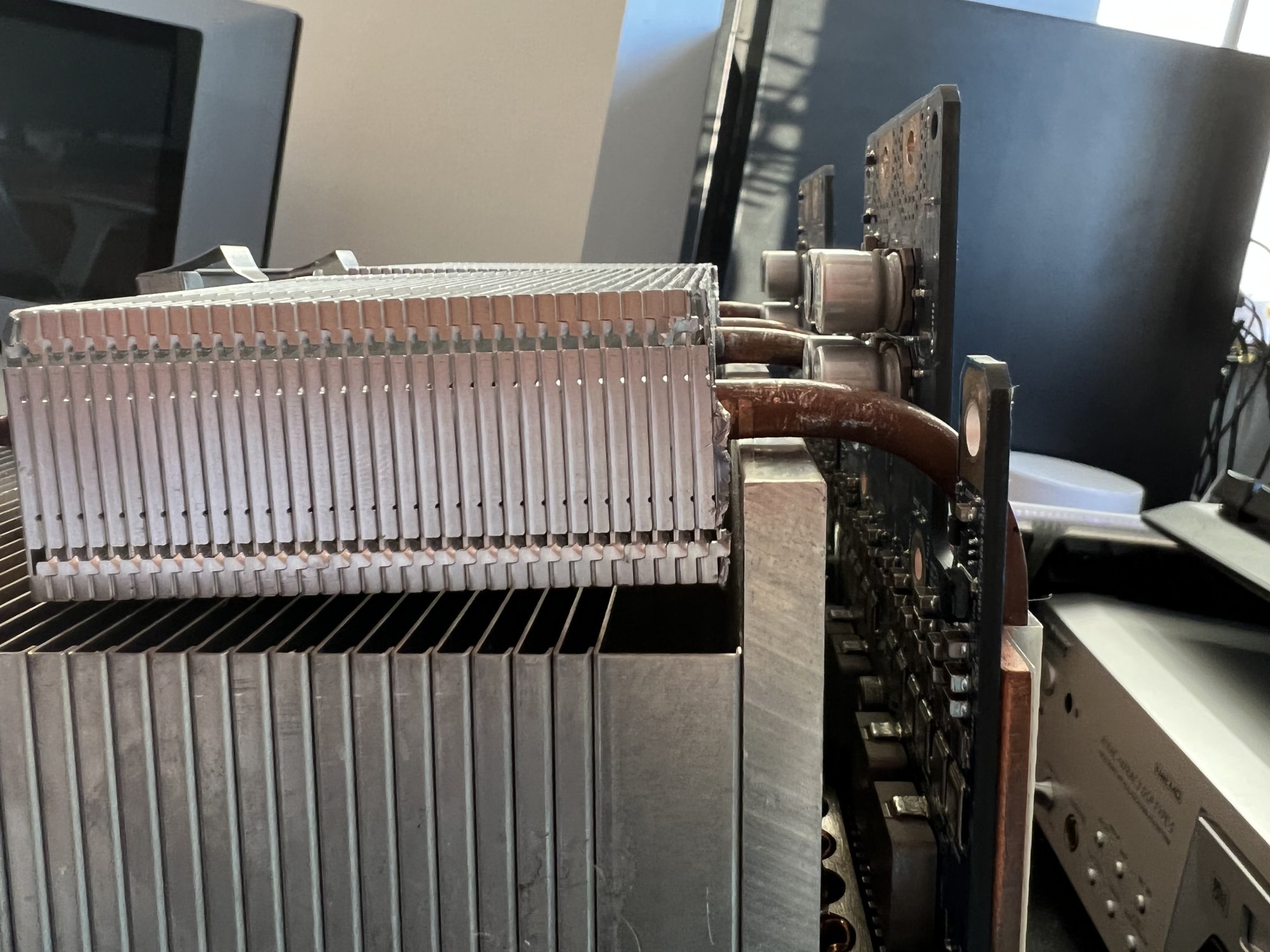

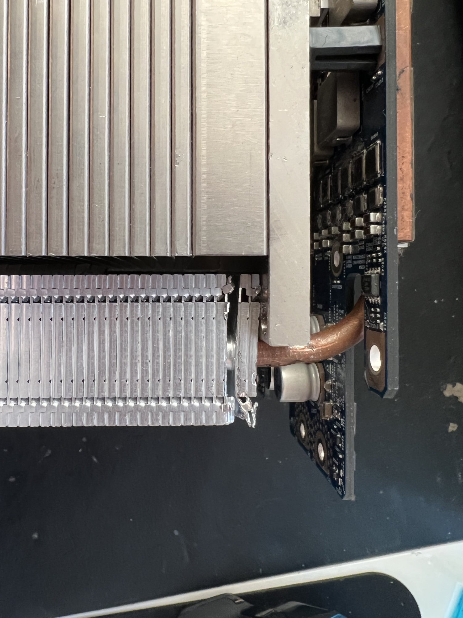

This heatsink attached to the 2.5DC CPU was slightly too tall to fit on the older Heatsink - so if you cut about 5 fins it will fit. (maybe try to do it less messy than I did)
Shown below is how I too the fan socket bracket and spun that around in older to align the screw holes to the board.
When put into the computer they should line up and you can screw in those two screws.
As I said this isn't the best method and you could most likely improve this by drilling into the metal block at the bottom if you wanted to align more of the screw holes. If you're going to do this be very careful moving it and if you're traveling with it in a car for instance I'd remove the whole CPU block first.
This is exactly what I did but I removed the metal frame at all (the front fan still fits nice after you connect it to the cable) and rather than cutting - I just bend the copper tubes a bit.
Yeah I just rest the Mac horizontal and when I went to vacation with it - I just removed the CPUs and put them in a bag with the pins facing up (and the bag being exactly the inches to fit both CPUs tight).

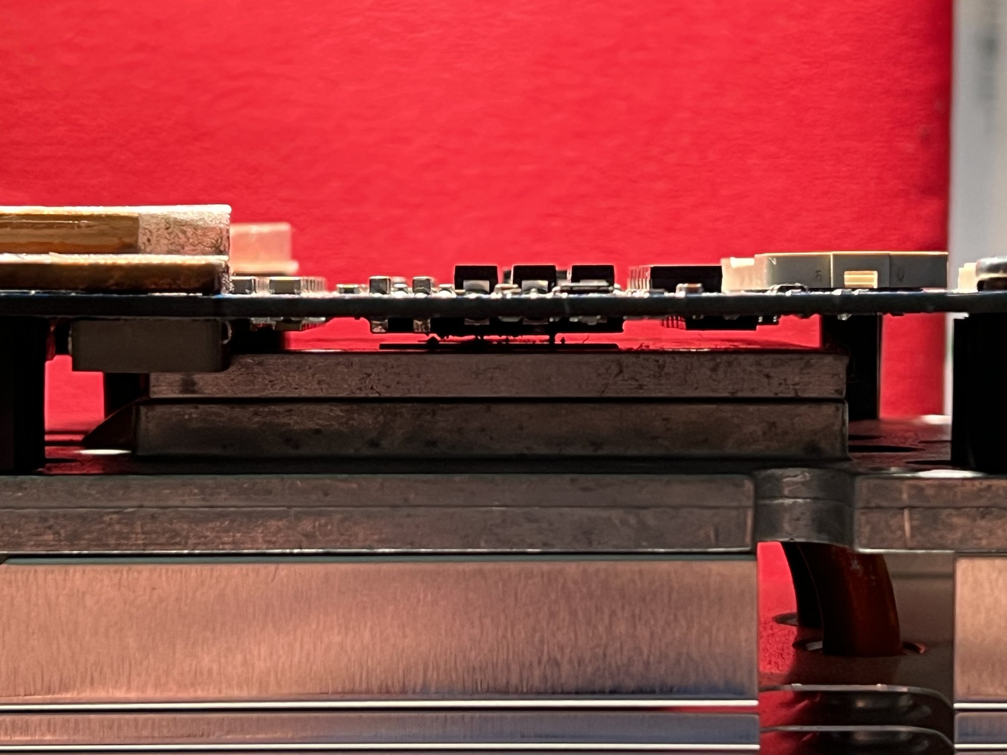

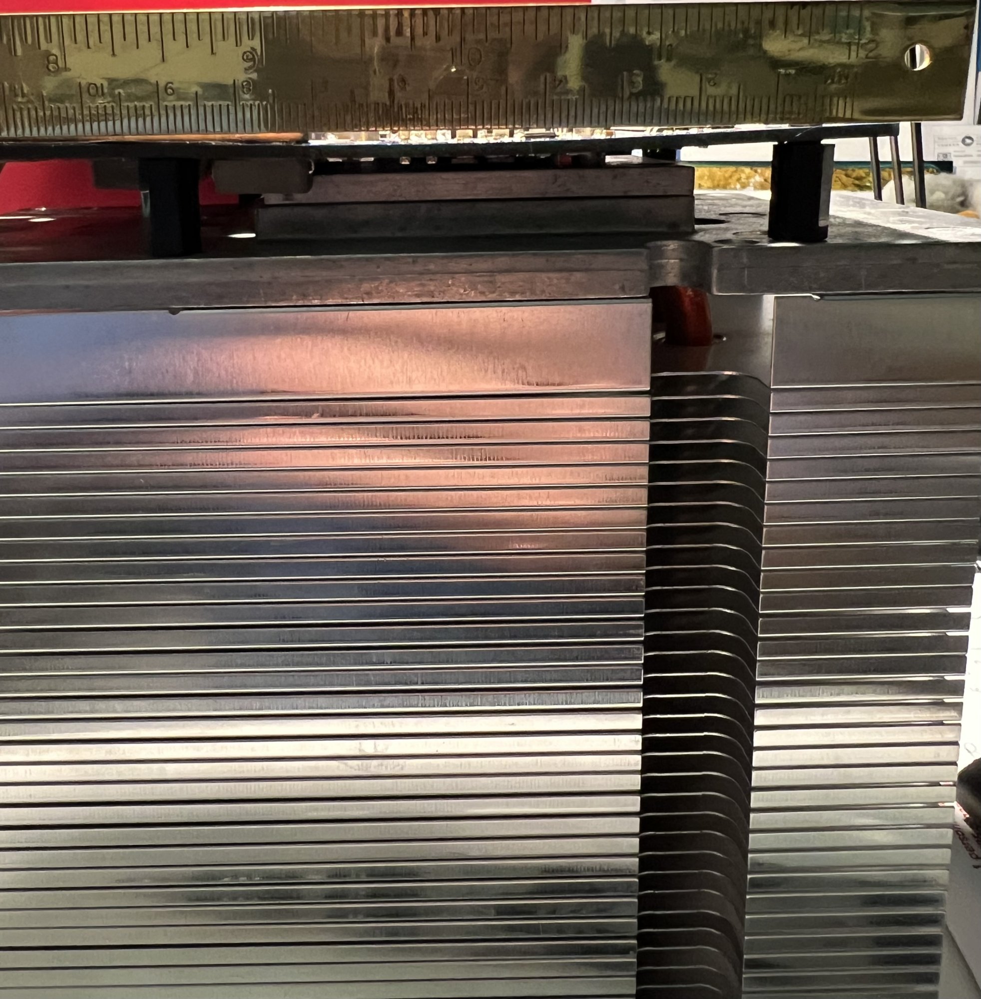

I'm sorry to necropost, but I'm trying a similar approach on a Quad G5 with failing LCS. Upon installing the heatsink on the CPU module, I realized that the plastic spacers are a bit too long and prevent the CPU from making contact with the heatsink. There is a gap of a few millimetres. I can tighten the four screws at each corner of the CPU to force contact, but the PCB get a little warped (I tried with a non working CPU module). Did you encounter a similar problem? If so, how did you manage? Thanks.
Yes I did have that problem. My screws for the CPUs came with spring washers on them. I removed the springs and made sure not to over tighten to screws, I just tightened until it was firm. I’m unsure how the PCB is getting warped. Can you send some pictures so I can see what you mean?
On the first picture, you can see the gap (with some thermal grease) between the heatsink and the CPU when I only use the plastic spacers. Using the four screws on each corners of the CPU to allow contact bends the board, as you can see on the second picture.
I suppose I could use a copper shim.
