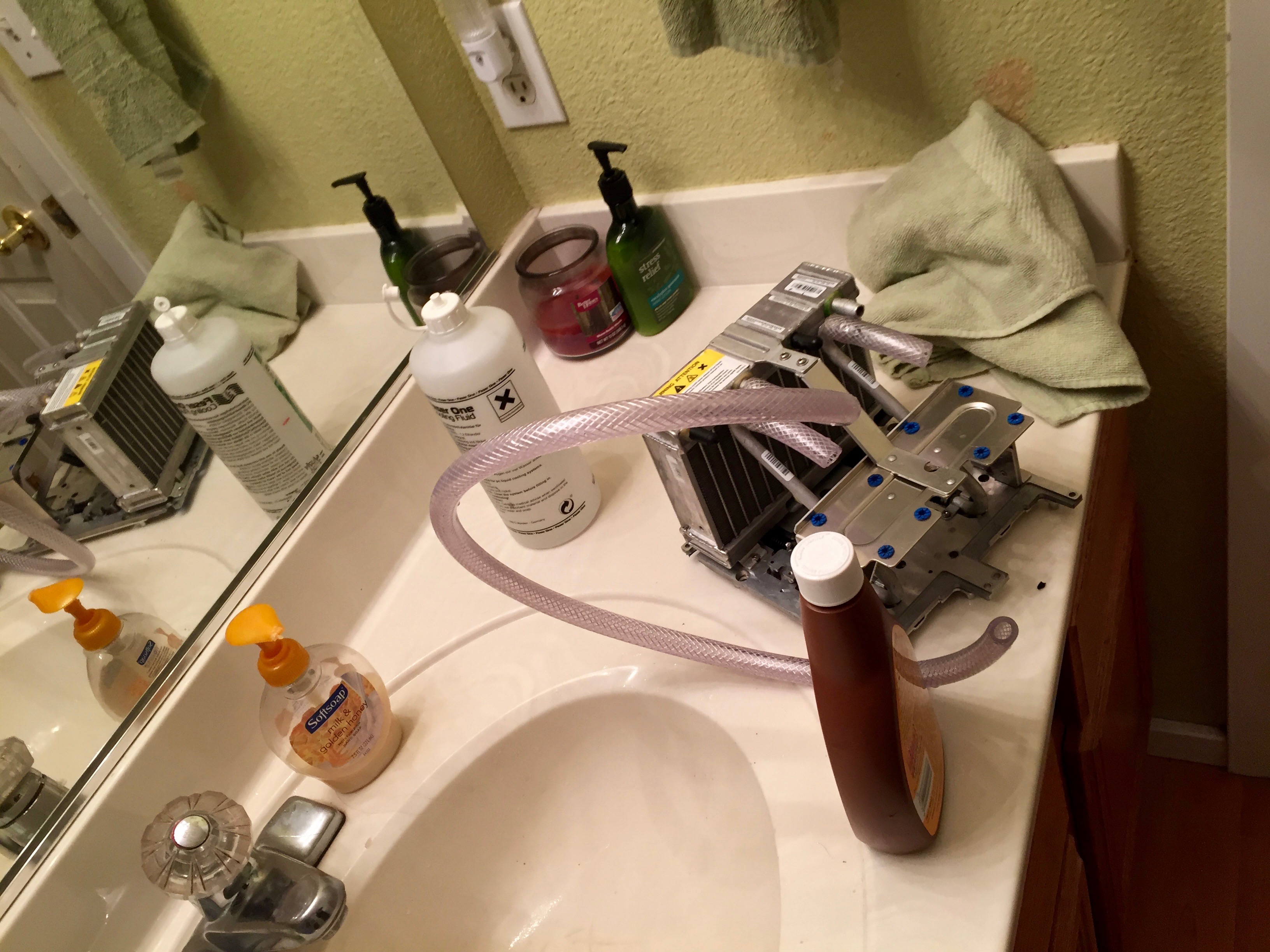

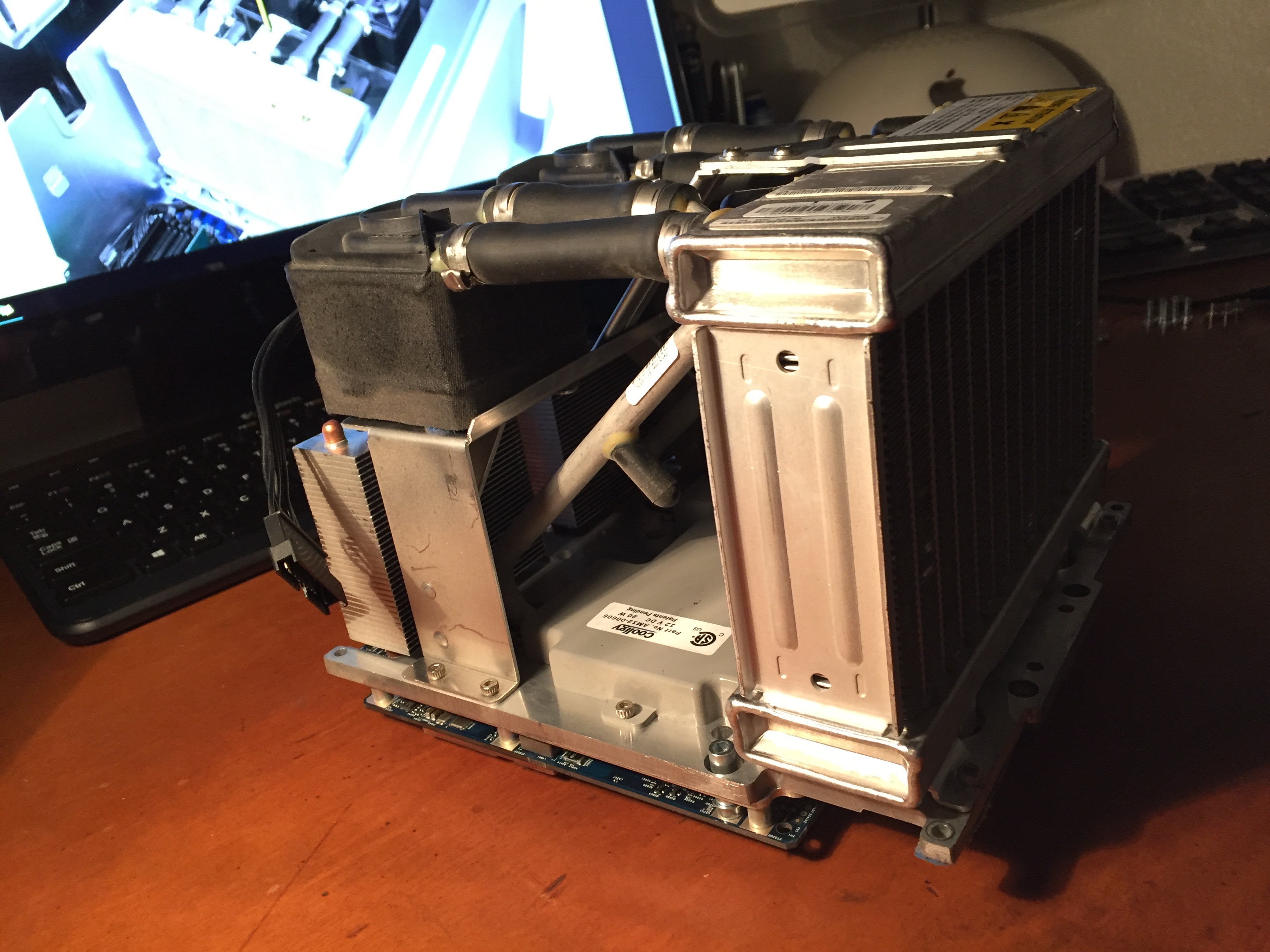

The reinforced PVC tubing is quite stiff. I used similar stuff as temporary tubes for draining and refilling. Spring clamps are better than the worm drives, but silicone might be a good idea if you stick with the tubing. From the looks of it, I think the original unit used epoxy sealant, actually.
Yes it did use epoxy sealant
Thanks for the recommendations @rawweb and @mortar if this project continues to go south I'll look into both ideas. If it really does hit the fan I am making this a target with some tannerite and my ruger .308 hunting rifle.

Maybe I can find something that will eat the s*** out of the LCS if I let it sit overnight, what I dunno. I've heard of water and vinegar but I don't know if that would be strong enough.
Im my younger days we used Muriatic acid to clean old auto radiators. Used it right out of the bottle (full strength) to cook out the crud. You can buy it at Lowes / Home Depot and it's reasonably priced. When your done it's easily diluted with water to dispose of it.
Of course you should *always* read all the precautions and follow directions including wearing rubber gloves and eye protection. Otherwise how will you see the coolant flowing through those clear tubes 🙂

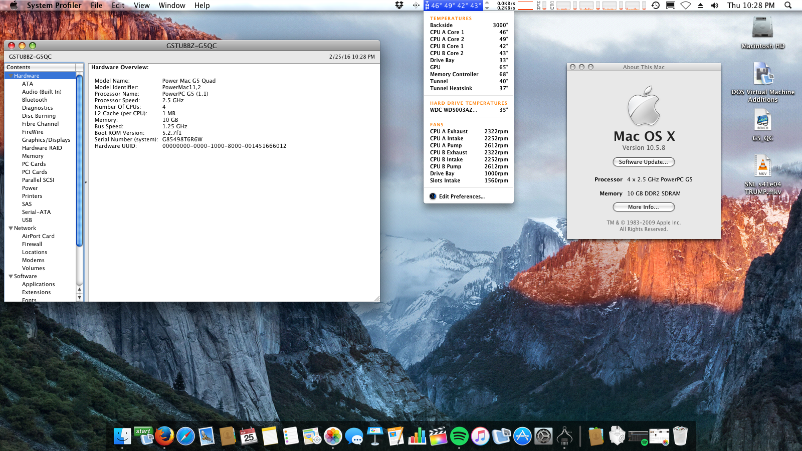

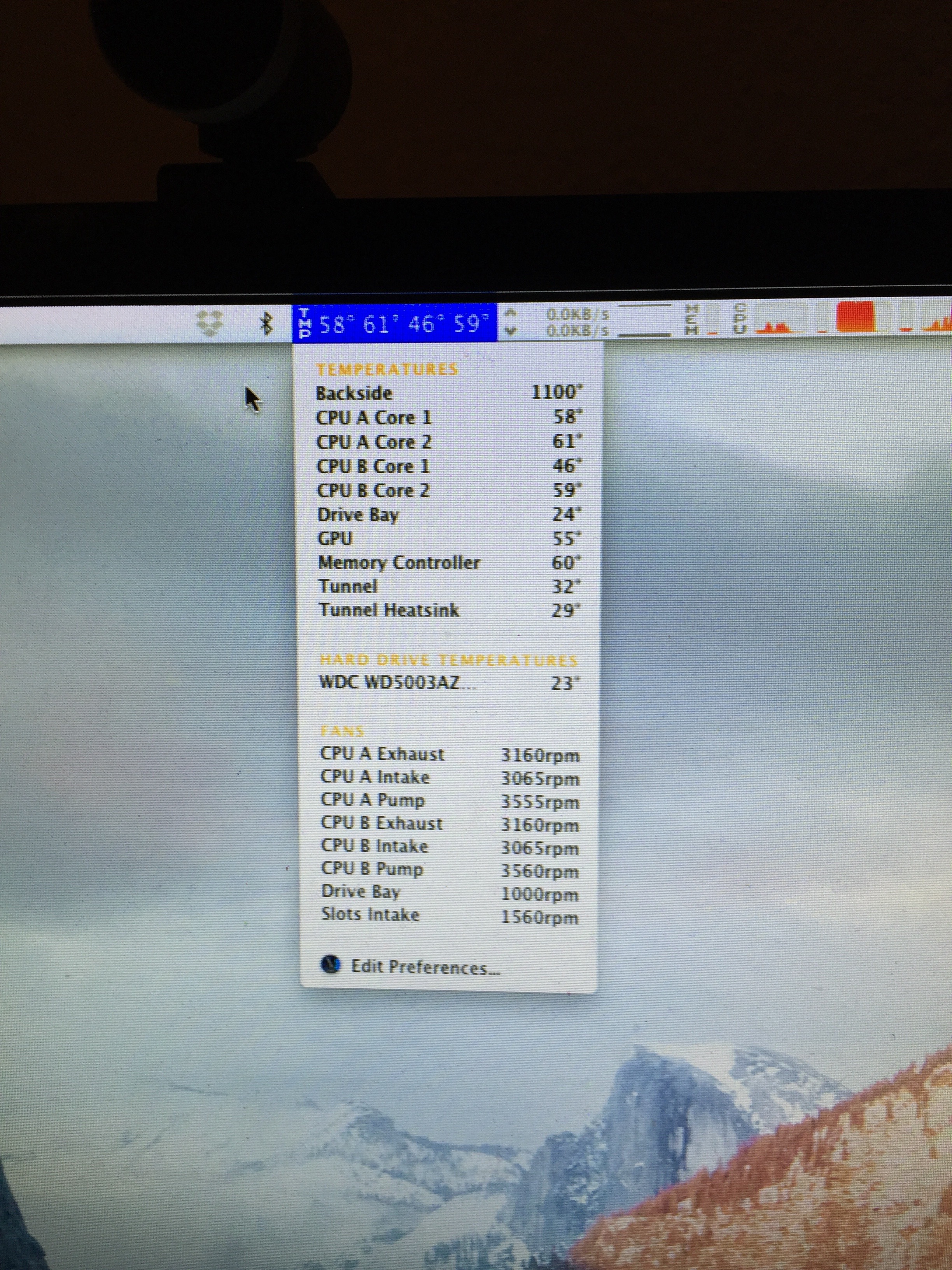

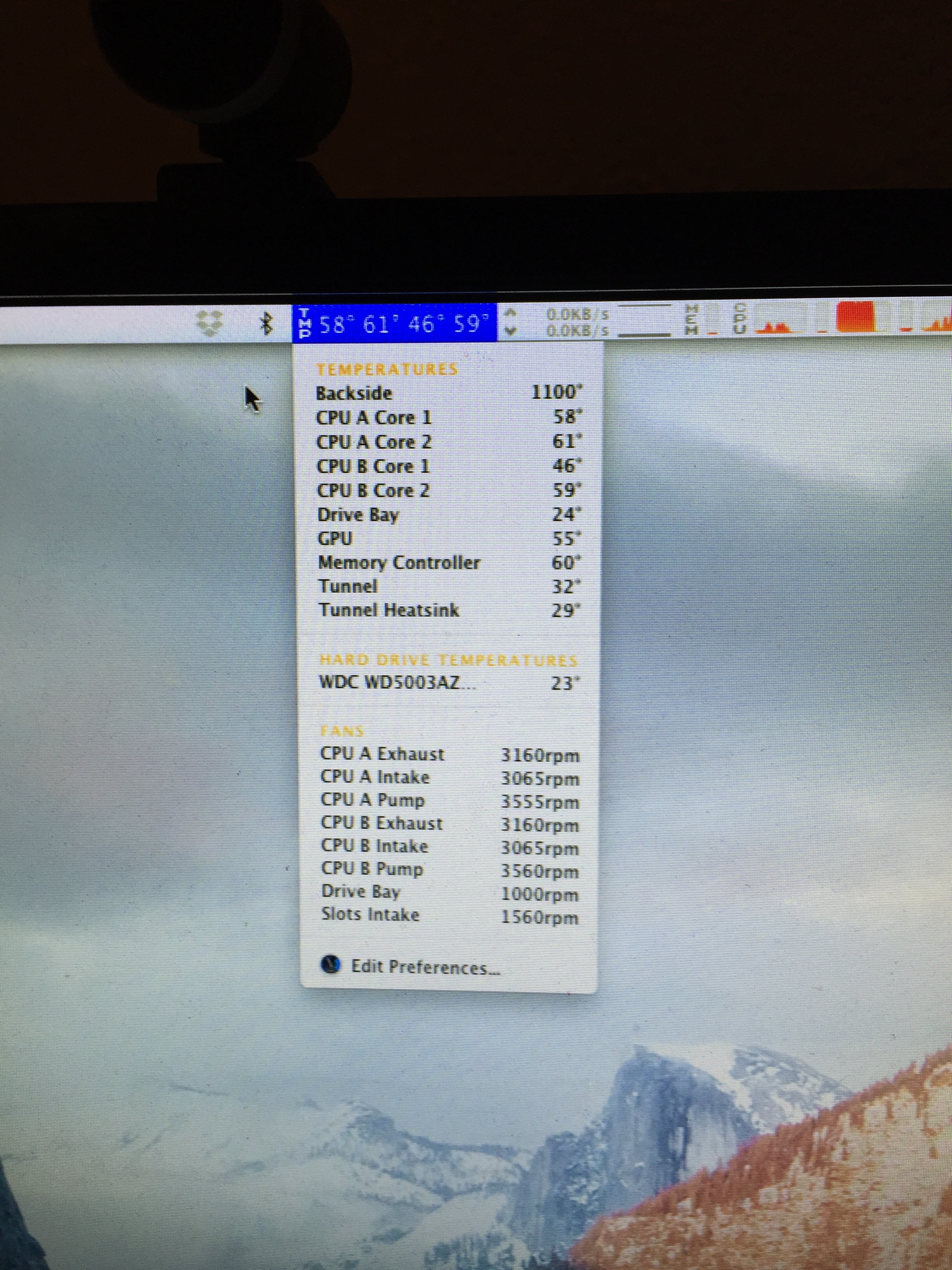

It boots and is usable. Booting ASD 2.6.3 as we speak. Temps are much lower, usually ranging from the 40-60*C range on both processors.

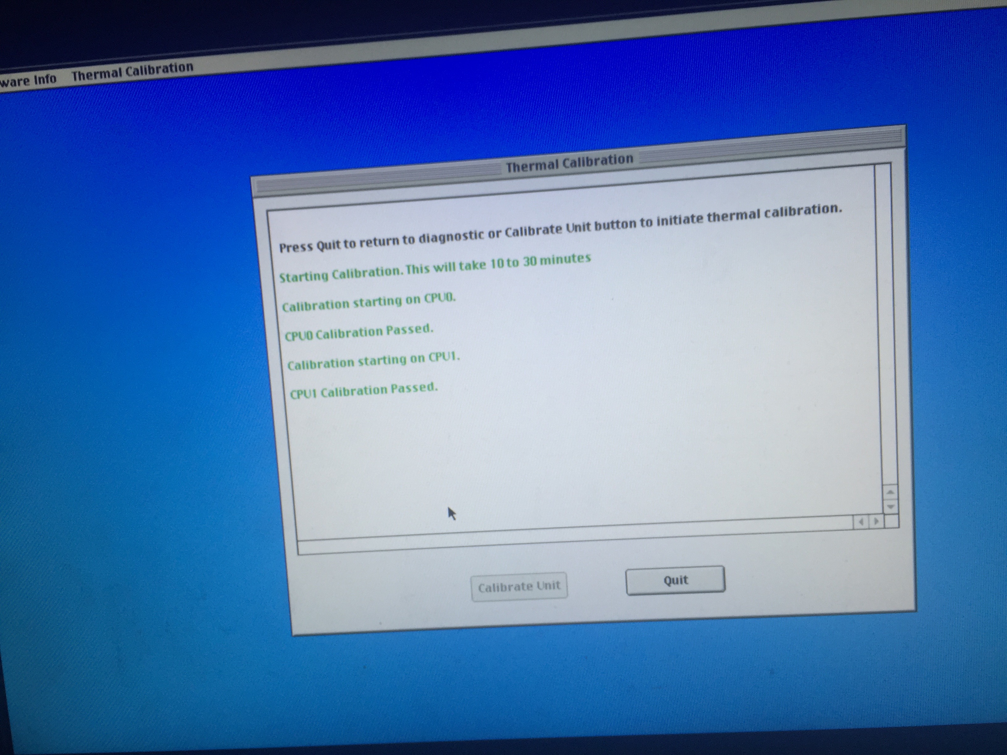

Welp as I was writing that it threw a checkstop, which is odd it didn't throw an overtemp light like every other time the LEDs lit up.
Removed all extra ram, sonnet PCIe USB card, unplugged the hard drive. ASD was attempting to boot into the OS side so I made it boot to the OF side like it should.

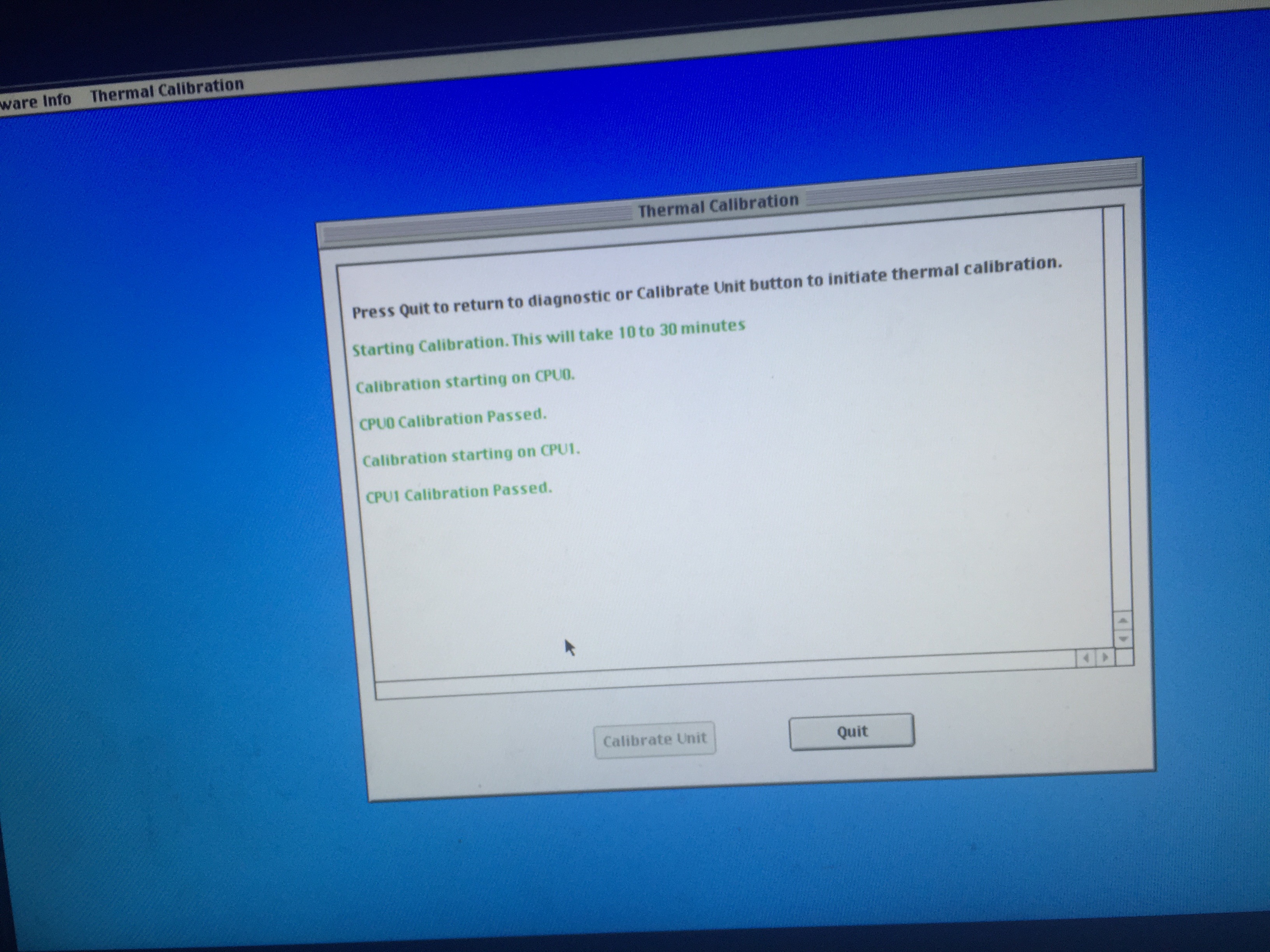

Here we go! Starting thermal calibration...
Both passed! Yay! Going to run the standalone tests on everything just to make sure everything else is okay.
Here is my next update. Running stable for the hour and a half it's been booted into OS X! It's actually quieter than my 2.3GHz which has a super annoying issue where you open any program the fans would rev up. Both of my 2.7GHz G5s did the same. The only ones to not do that were my old 2GHz early 05 and my 2GHz dual core.
And I've thrown a good chunk at this already.
$150 for the G5; $45 for the processors; and $20 for the tubing/hose clamps. "Borrowed" coolant from work lol. I'll have to buy another bottle to replace that.
Thus far: $215. Still have plans to continue building it up, Quadro FX4500; 16GB Ram; and I'm thinking some SSDs to replace the brand-new WD Black 500GB hard drive 🙂
Now for a second I was ready to kill this thing but stuck with it and made it work. I was super tempted to find a 2.3 board and processor then just use that, but what fun is that when I bought a Quad for one reason, quad cores! So I made things happen. For the past two weeks the damn thing was stressing me out.
I'll write up a rebuild guide soon to add to the knowledge of other LCS rebuilds, how I bleeded it, materials, stressing, etc. This guide helped me a lot and is the dual pump G5.

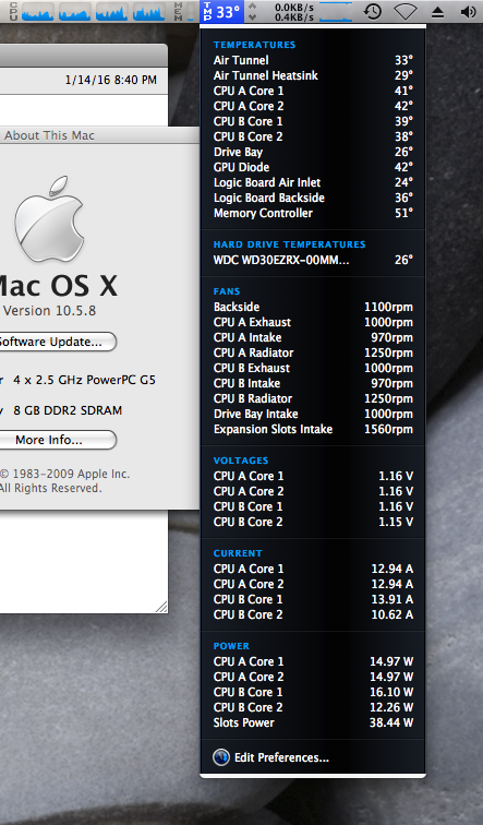

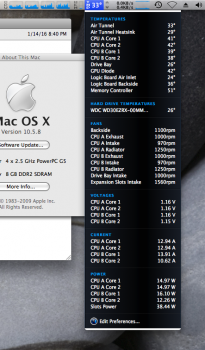

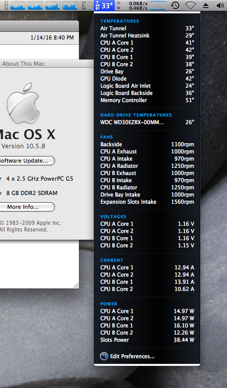

Nice work! It looks like things are running OK temp wise, but your fans look to be doing some of the work. Was that screengrab at idle? Or was that taken before you did thermal cal? For reference here's mine at idle:
That was at idle. My MP runs about 30-35 when at idle too so the G5 is definitely pushing out more heat. I checked the coolant levels and the bottom one is perfect, top one has a teeny tiny air bubble at the top of the inlet tube for the fan.

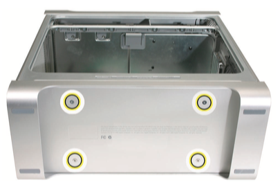

[doublepost=1456522652][/doublepost]Another thing, the orange tape that is usually on the LCS was missing. The screws on the bottom of the computer did seem off centered too. I think that I could have been a possibility that this computer was used in Apple's service manual take apart instructions

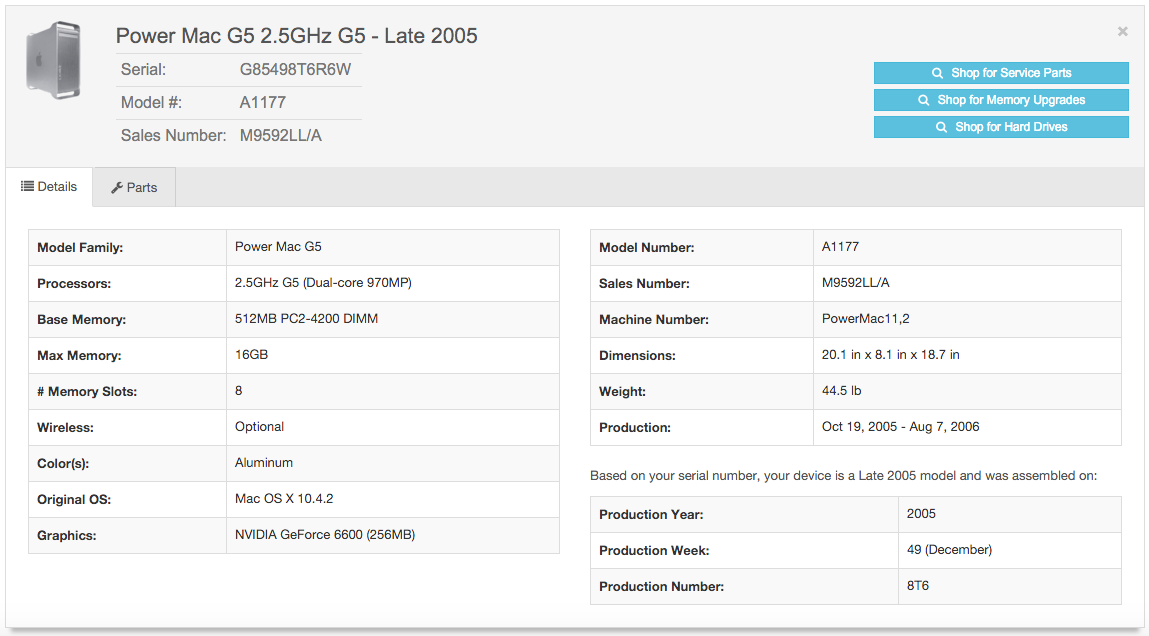

Fascinating sir, my dual pump is also a December '05 baby. Interesting if you think about both of our rmachines and the identical issue 😉

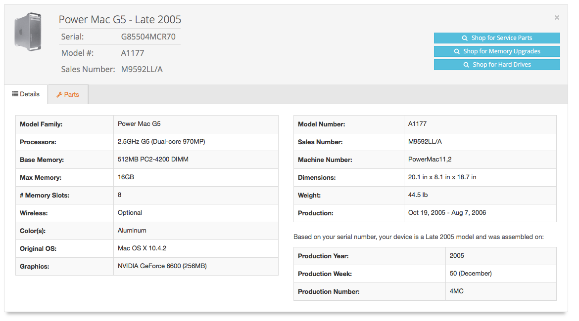

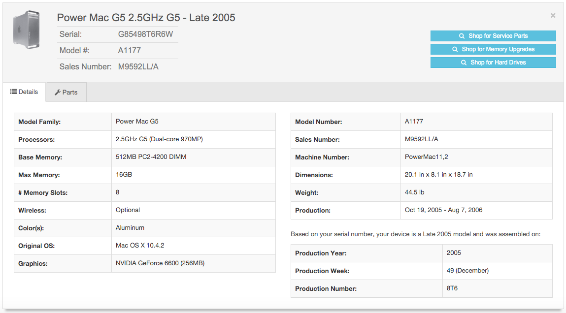

Here are the details on mine, I wonder how far off yours is 🙄
Certainly interesting. Too bad the service guides don't have a closeup pic of the serial number 😀 I wish to own a prototype of something at some point!

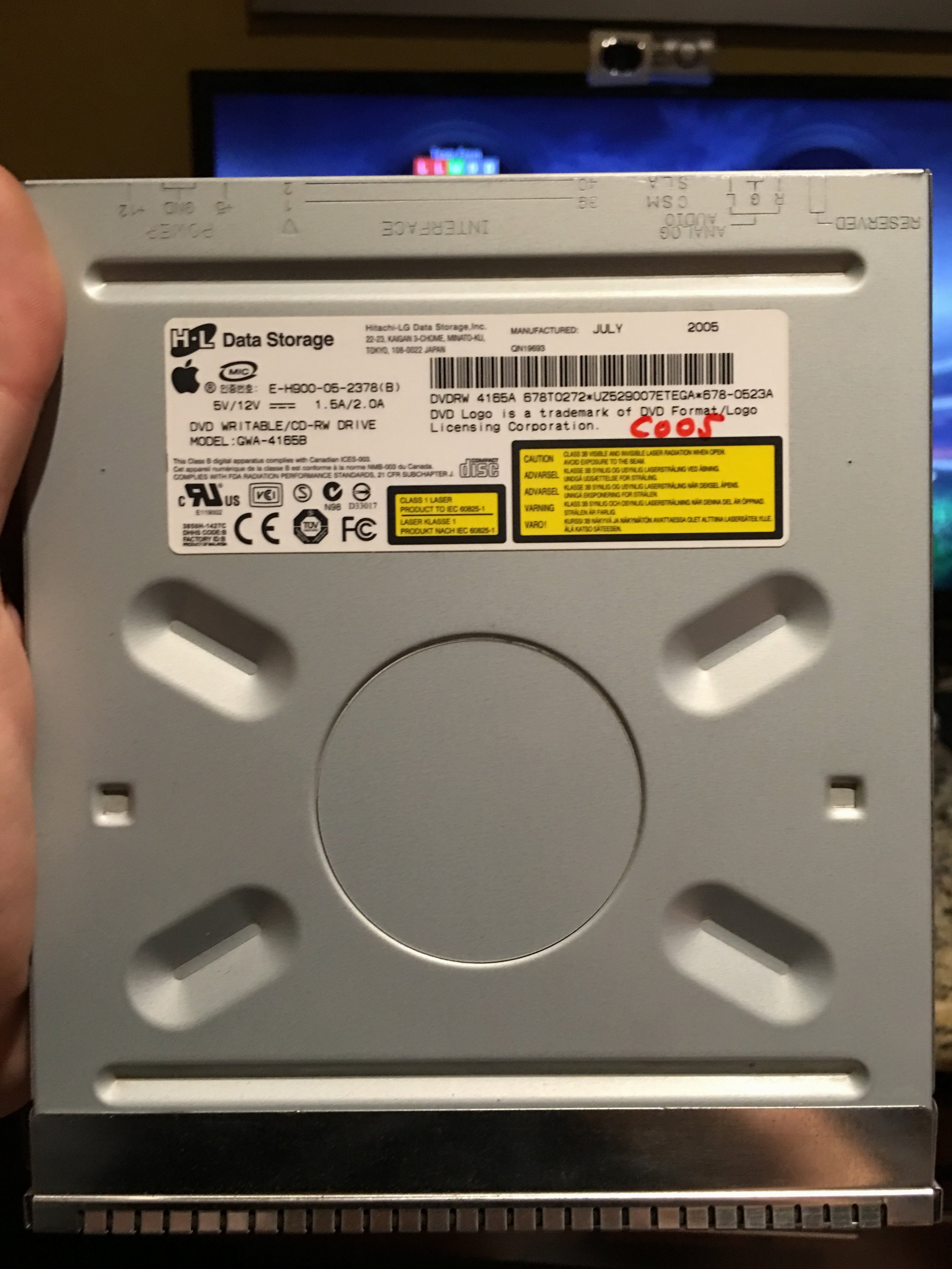

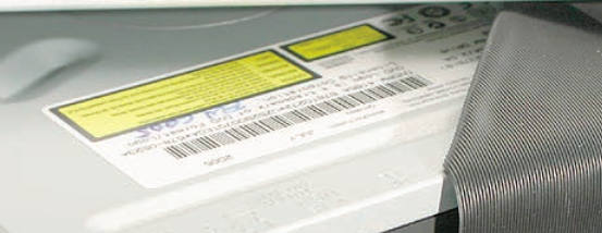

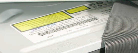

Does it happen to say this on top of the optical drive? @MacCubed

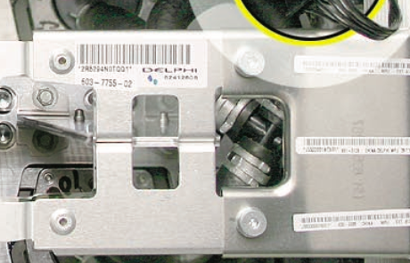

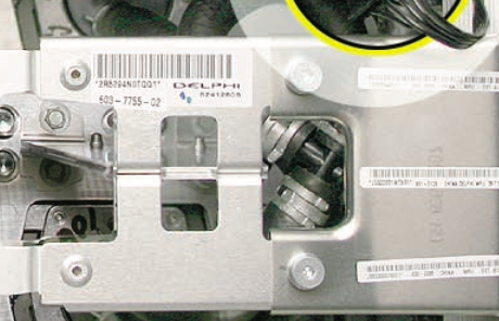

Then saw this on the LCS

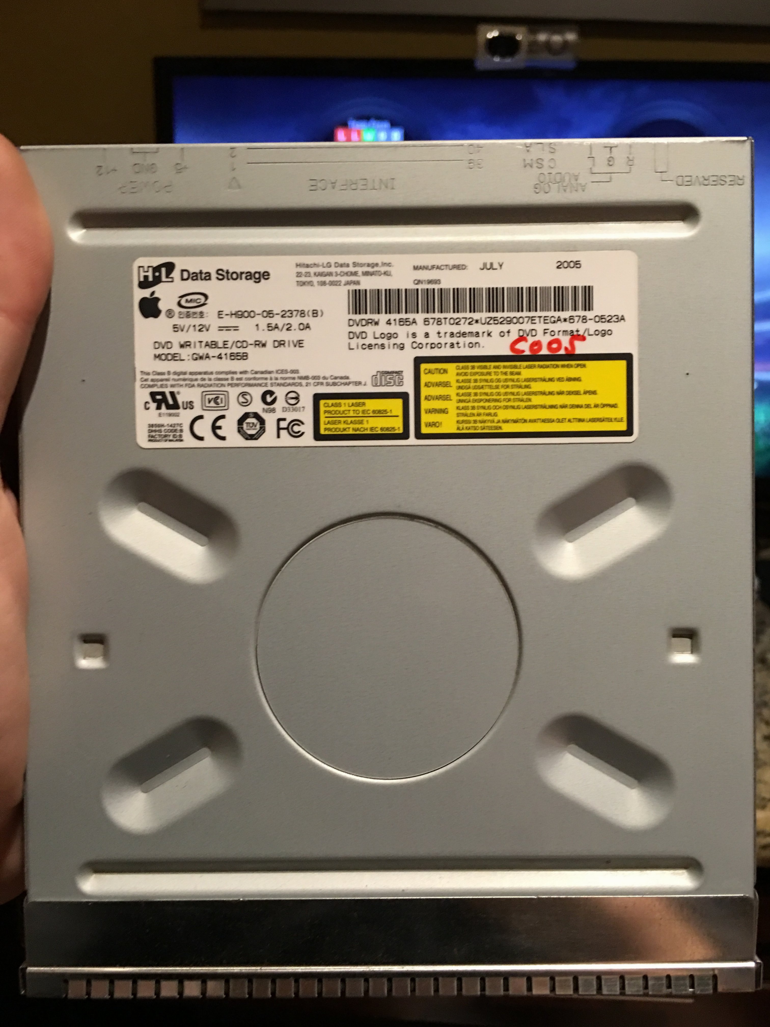

Extremely close! Both were manufactured in July of 05 and say C005 on them. I know 2 Quads were used in the guide, on with the FX4500 and another without, mine didn't have a graphics card so idk
