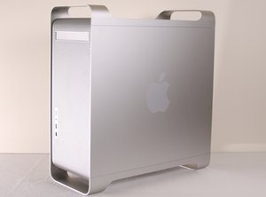

I’m playing with a Quad Core PowerMac G5 (A1117). So far everything was fine, I’ve reworked all the thermals and the machine worked well for more than a week under high load, compiling non-stop.
Today I’ve turned it off and after several hours tried to turn on. But it doesn’t POST anymore - checkstop led (led #7) blinks twice after power on, then waits, then blinks twice again. I’ve tried to pull out the RAM and graphics card - no change. Tried to power on without CPU module at all - well, as expected it turns on CPU leds.

Nope, I've figured out what was it. CPU B passed away. The system posts without it. Still wondering why did it happen...
That post was about power led codes, though in my case I got checkstop blinks. There are no explanations for checkstop led (led #7) codes - according to all the manuals it can be either on or off.
Though now I figured out that double blink means that cpu b is dead and single blink means that cpu a is dead (when I put cpu b into slot a it started blinking once).
