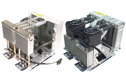

Was looking around and found a G5 Quad that has 2 pumps on it compared to the 1 that's on mine. Anyone know if the 2 pump model is the later rev or is it the 1st rev? Would they swap around with one another?

I remember that Dual pump LCS was later rev. Seems also, that it was less reliable than 1 pump version.
There is nice thread with some info http://discussions.info.apple.com/thread.jspa?threadID=1940728&start=0&tstart=0. Look at xlr8yourmac for more, there should be something about it.
Thanks for that thread. The Feser One Cooling liquid looks very tempting, non-corrosive and non-conducting. Found a 1L bottle on ebay for a good price. Gonna swap that out. Thinking I will need to figure out the pinout for the LCS pump so I can bench test it for leaks first before I reinstall the CPUs.

This is a box that hasnt been used much at all, btw, its a dual Delphi pump system, but there is no evidence of leakage on the pipes, clamps or any thing. There is however, on the paper (thats below the pumps) kinda like a catchment paper for spillage i guess without having a better term for it.
The paper looks ruffeled up, but once again, its dry as a cork and there are no discolouration or wetness on it at all. But it is ruffeled up like its maybe been wet a long time ago....????

Read thread I linked above. There are described symptoms which are indicating LCS malfunctions. If you don't have any of those, you shouldn't worry.
If there is no discoloration on "spillage catcher", then tere was no leak in this place. Coolant is corrosive and always leaves stain or other marks.
