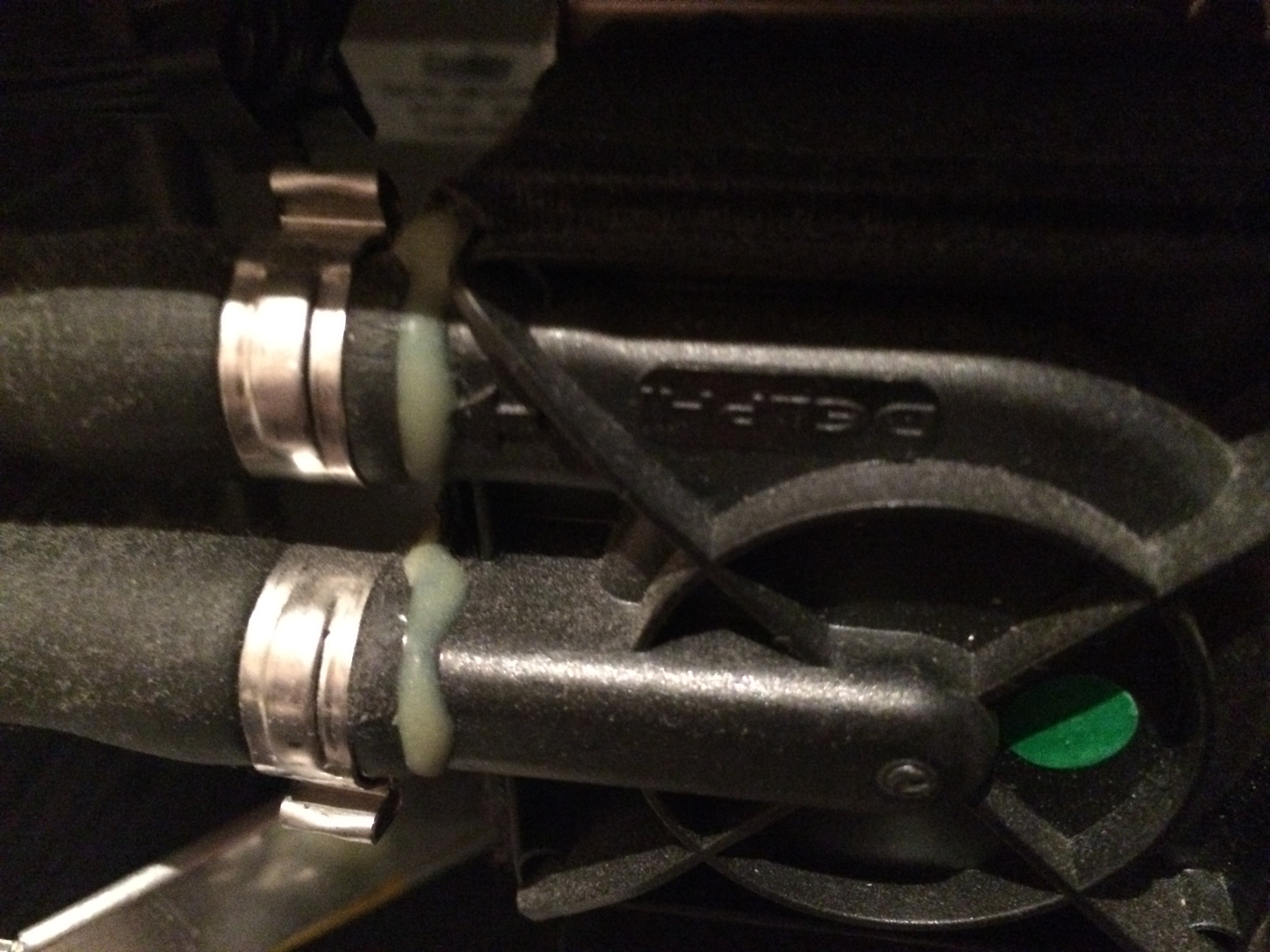

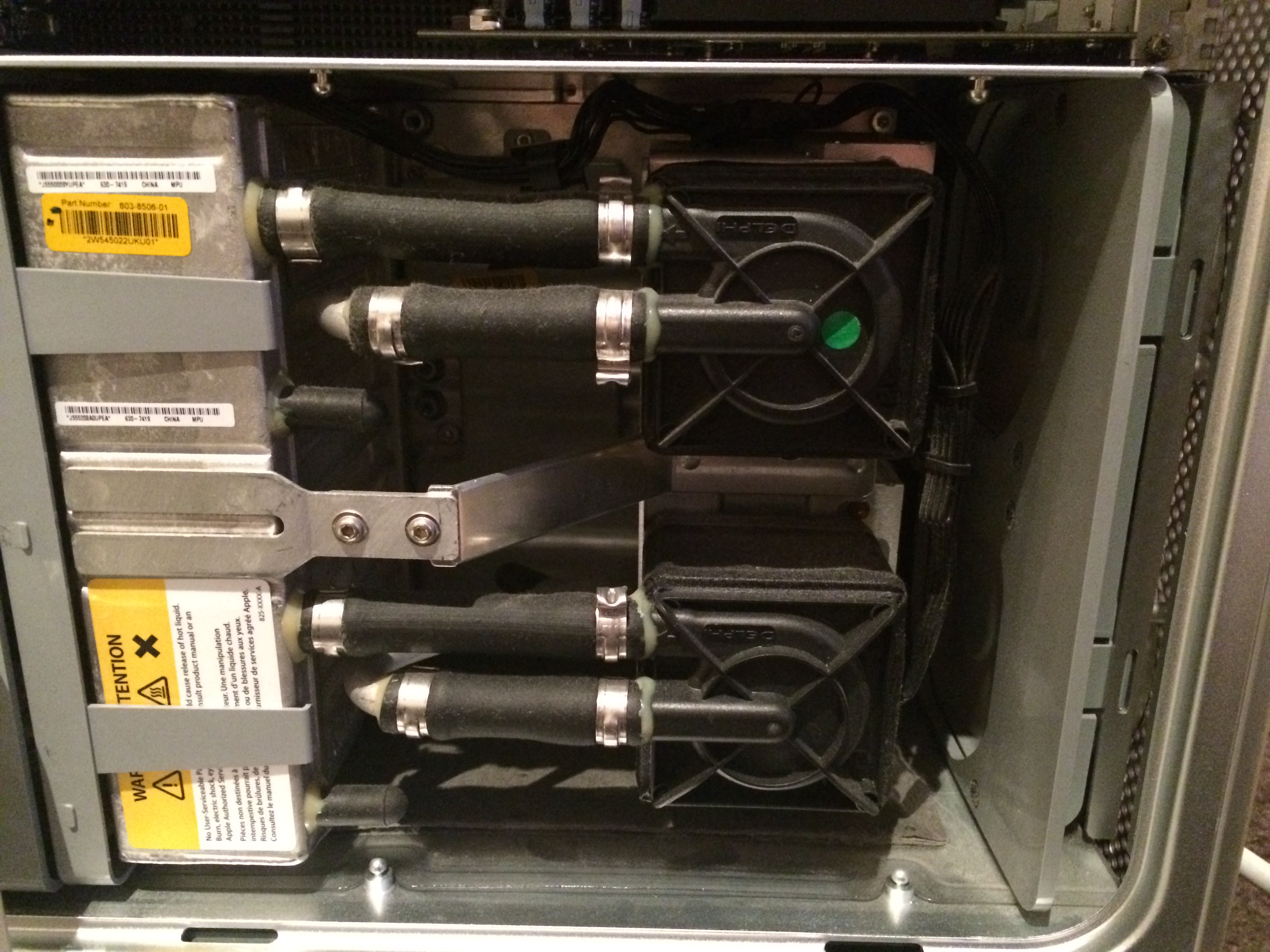

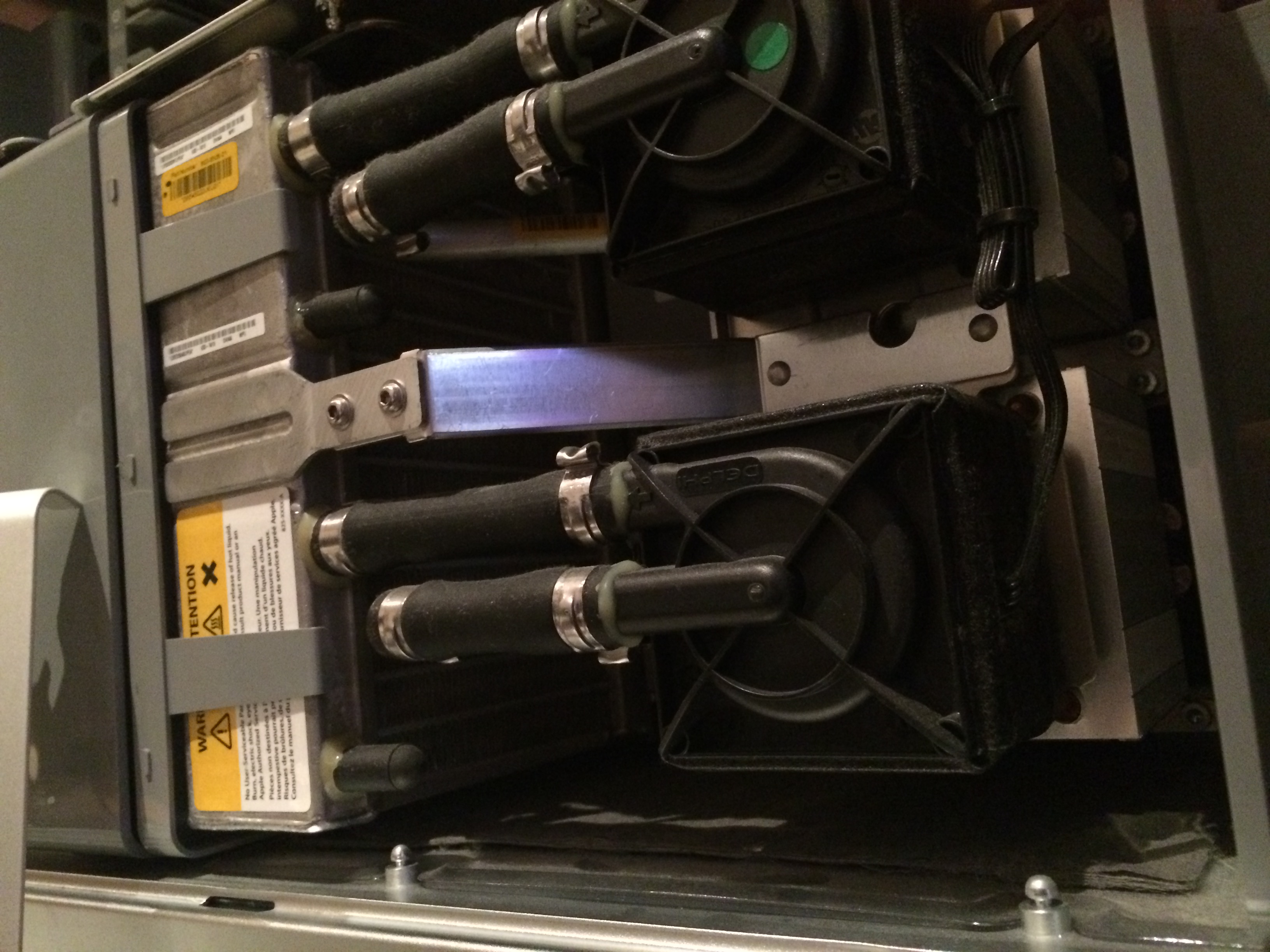

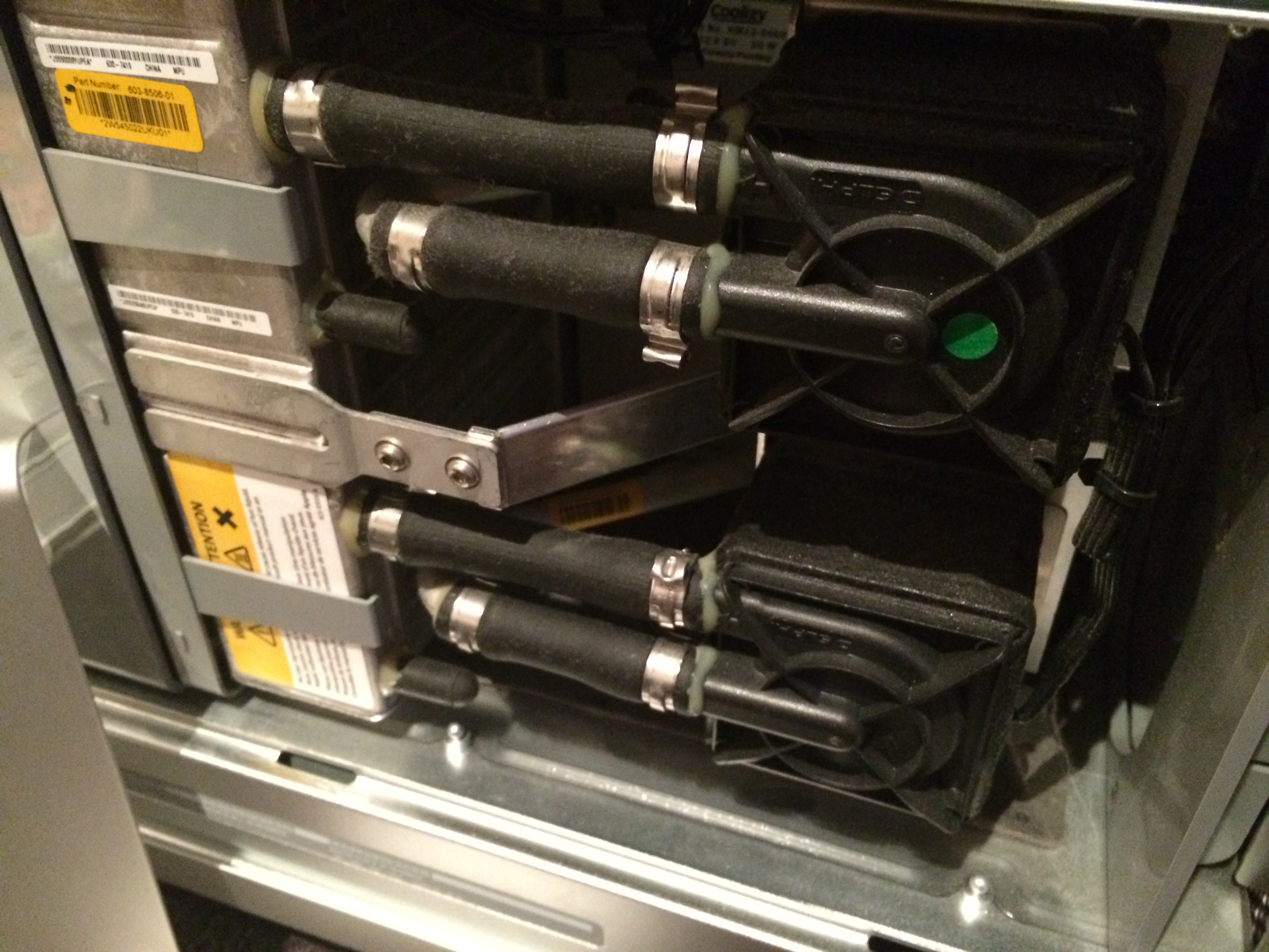

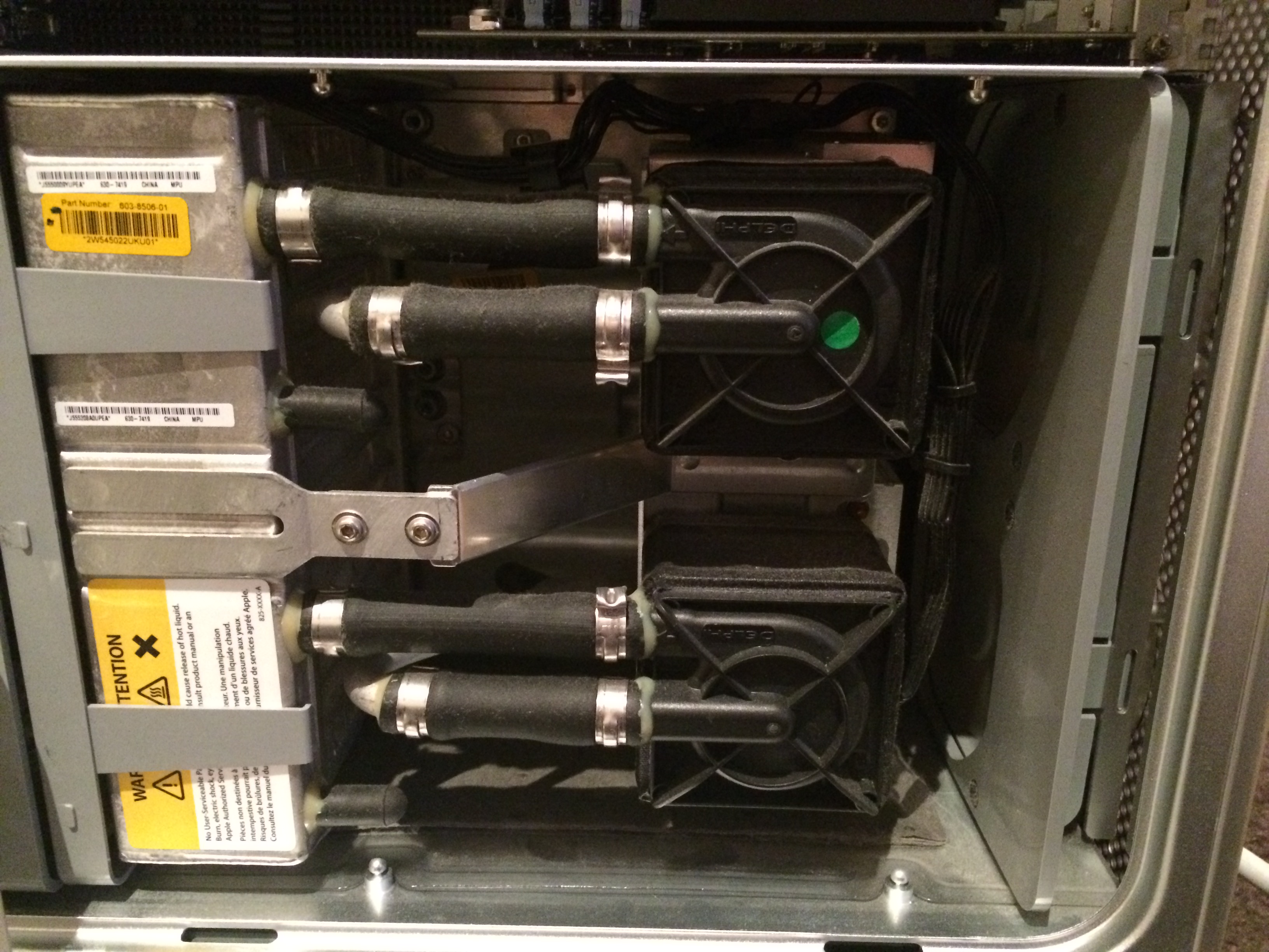

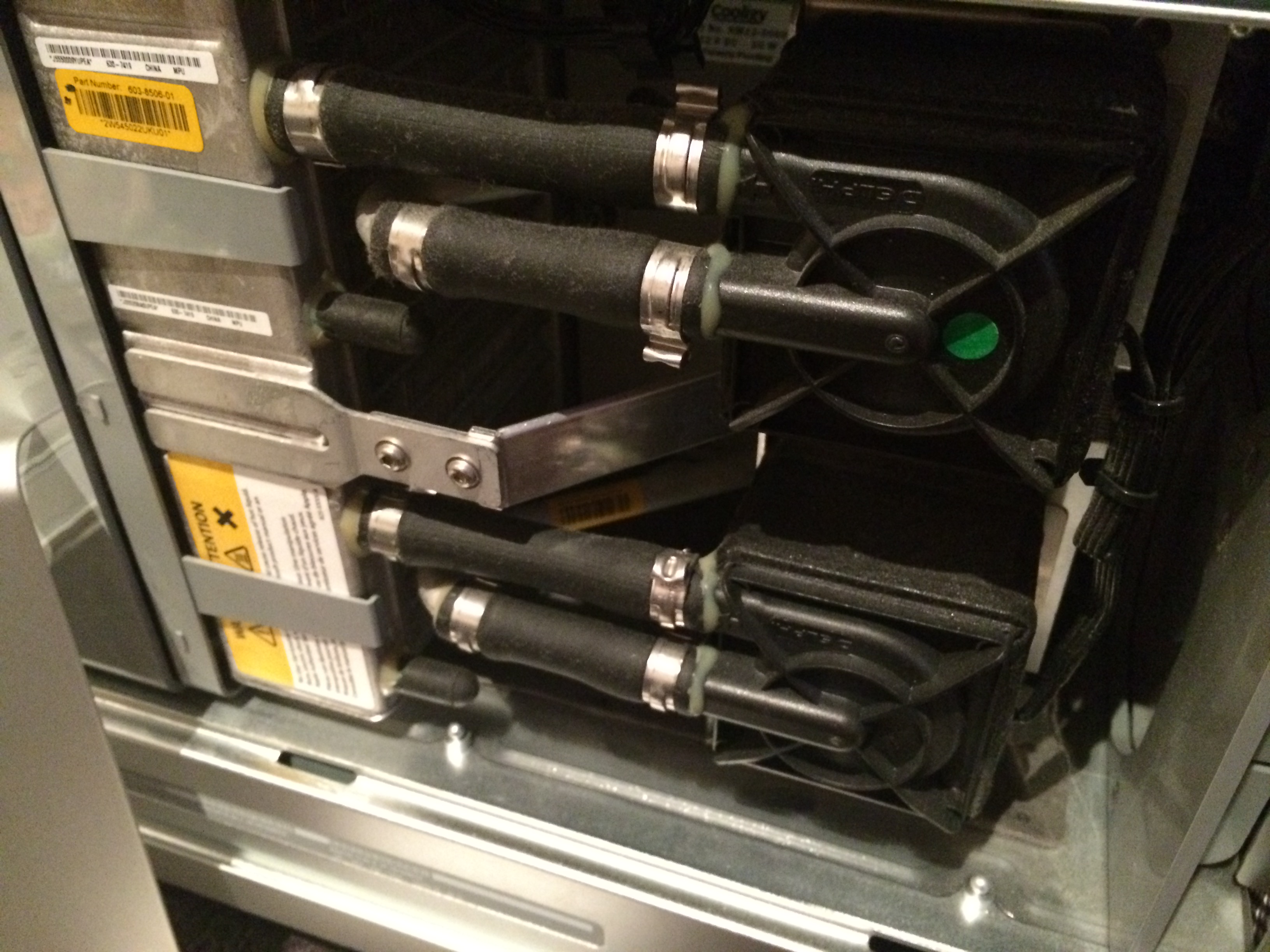

Hi, I recently got a Power Mac G5 Quad and upon taking it apart I realised that the grey CPU cover screw/pin was not there, meaning the CPU had been opened up before, possibly for a repair.
I was wondering if anything has been modified/replaced visibly or not? This is a UK model. I, personally, don't have a clue.
The LCS has the Delphi logo on it. I thought the Delphi LCSs were the unreliable ones that were prone to failure and the Panasonic ones were newer and more reliable? If this is a Late 2005 G5, why doesn't it have the Panasonic LCS?
Also, I have heard about dual and single pump LCSs. I think this is the dual pump. Which is better? And why were there two LCS models? (is one a newer revised version??)
Thanks everyone!

Don't take this as definitive, but I'm pretty sure all the quads shipped with better LCSes than the previous generation (the non dual core models). It was the dual 2.5 and dual 2.7 that were the most notorious. I use a refurbished dual 2.7 with the improved LCS.
Yes that looks the same as mine.
Those pipes are araldited and clamped looking as it does in the photo its is unlikely to have been touched
Mine however has been by me and it is not an easy job so I would say its original. The unit may have been removed to replace a CPU maybe?.
The grey plastic thing is called a "Click Rivet"

I know, but then why does the LCS have the Delphi logo on it? Pretty sure Panasonic made the improved LCSs. Hmm...
Strange. All the YouTube videos showing the Quad LCS have single pumps:
https://www.youtube.com/watch?v=FLTyA1iSyg8&spfreload=10
(16:50)
https://www.youtube.com/watch?v=ofKAHa2xSMY&spfreload=10
(1:25)
The G5 Quads never came with the panasonic lcs. The claim is Apple decided the panasonic was unreliable, and stopped using it.
They came with a single or dual pump version like you see on yours.
The dual does seem to suffer problems a bit more than the single.
Overall the G5 Quad had the least lcs problems of any G5 version, but they are 10 years old now, and problems shouldnt surprise anybody.
That is correct, only Dual 2.5 and more oftenly Dual 2.7. Plastic inlet frame is different with Panasonic LCS (922-6393-Delphi, 922-6394-Panasonic).

The LCS system found in the Quad is much better designed than the systems used with the 2.5/2.7 DP. Some quads shipped with the single pump but I believe later in time (2006) they started to have dual pumps where the radiator is split into two separate reservoirs.
For the trouble of air cooling a Quad there would be really no point. If this was a 2.5/2.7 it would be much easier to convert with heatsinks off a 2.0 or a 2.3 and the system would work fine. I converted one of my 2.7s to a 2.3 with the air cooled heatsinks, helped with heat quite a bit.
Thanks, that's exactly what I was wondering! So the dual pumps DID come out later than the single ones...
