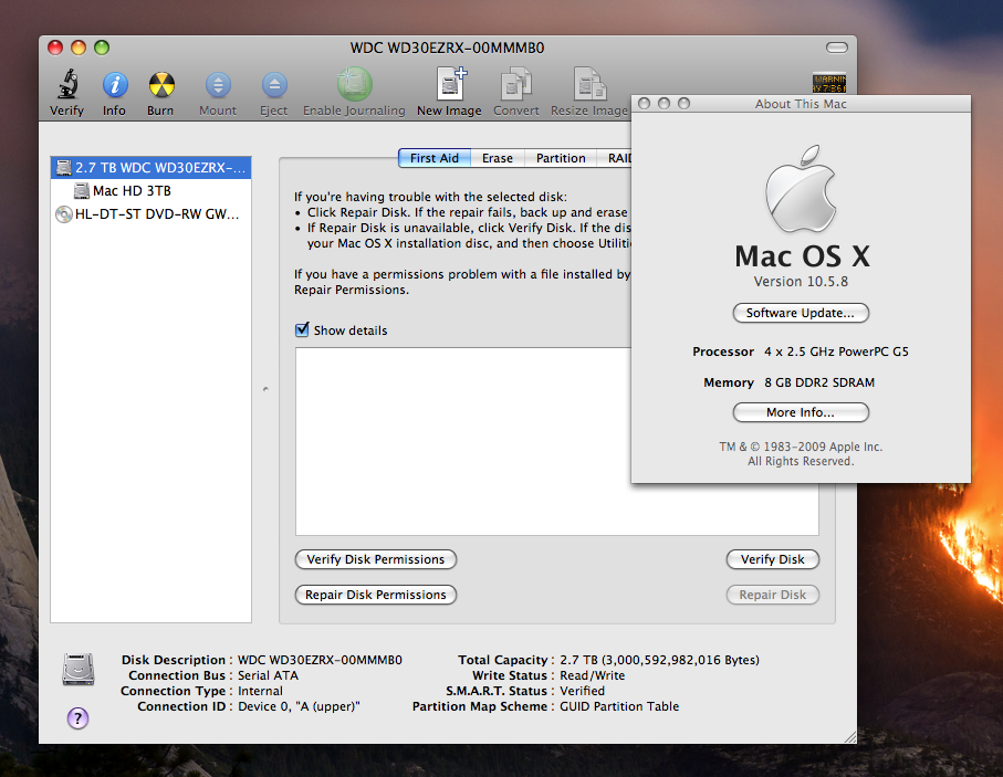

After some futher reading I am happy to say, one can use 3Tb drives as a boot disk in a G5. But no single partition is allowed to be over 2.2 Tb and the system must be running 10.4.11 or 10.5.X. 3Tb drives when partitioned in GUID can be accessed in full over FireWire or USB on any Mac running 10.4.11 or newer. A simple solution to the OP's problem if the drives have already been purchased is to partition one of the drive into two 1.5Tb partitions and formats the other with GUID to be able to use the full size.
A friend of mine bought a 3TB WD Green drive and put it as the second drive for storage in his G5 PCI-X but he had to use a Sonnet/Seritek card to do so. Formatted it as GUID and put all his files on it.
I have setup 3TB drives on a couple of my clients G5 towers. One on internal SATA and one in a USB enclosure. Both worked fine with GUID in one partition.
Tetley is right about the 2 TB limit in APM but the limit ends there. It's not a PowerPC limit.. it's a APM limit.

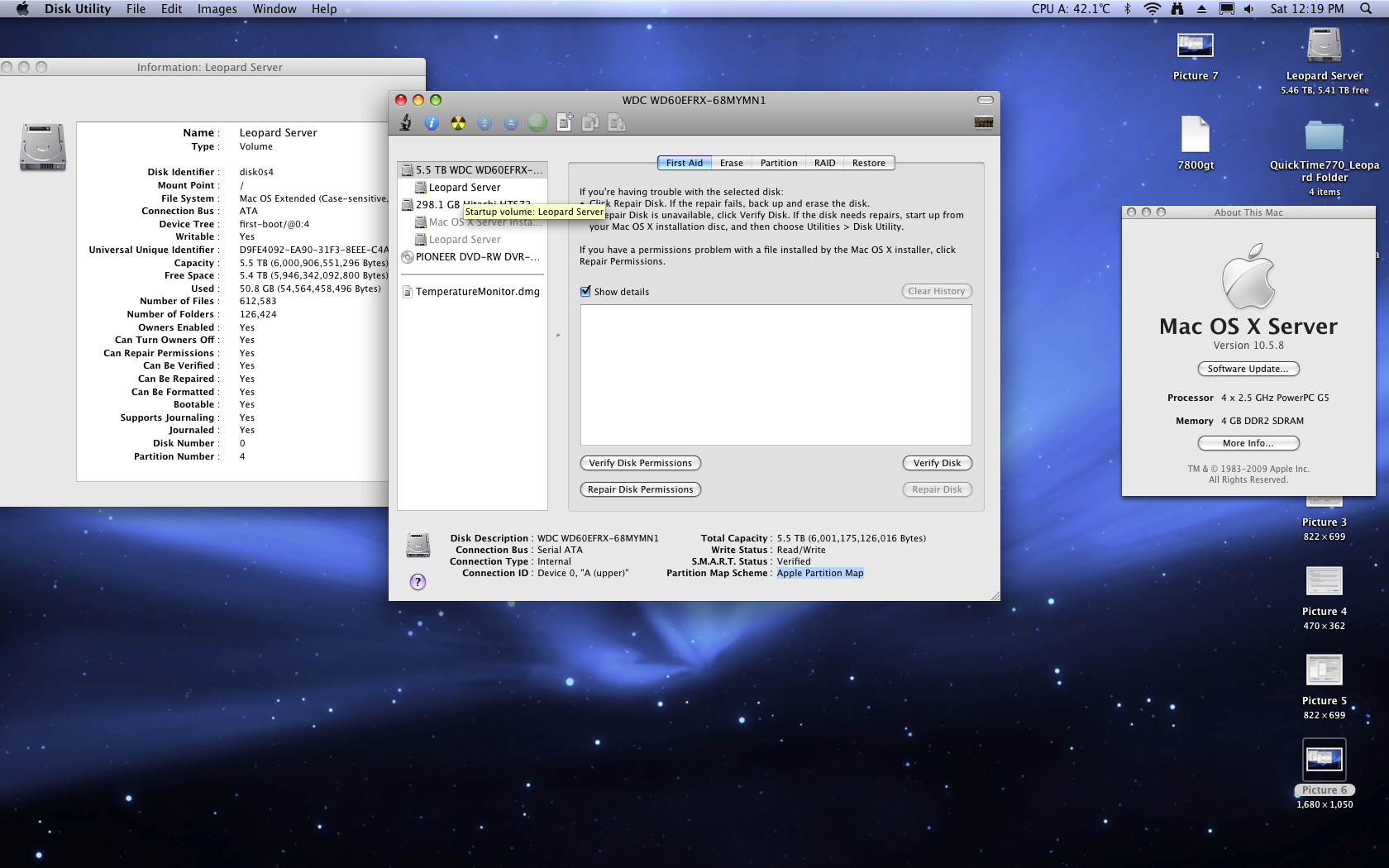

Just to test this out, I took a 6TB (Western Digital WD60EFRX) drive out of my NAS and into my Quad G5. It had no problems formatting it to APM (5.5TB usable) and booting from it. I don't plan to leave it in, but I just want to leave proof that larger hard drives do work and you can boot from them.

Proof is in the pudding...
