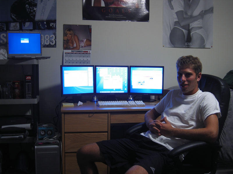

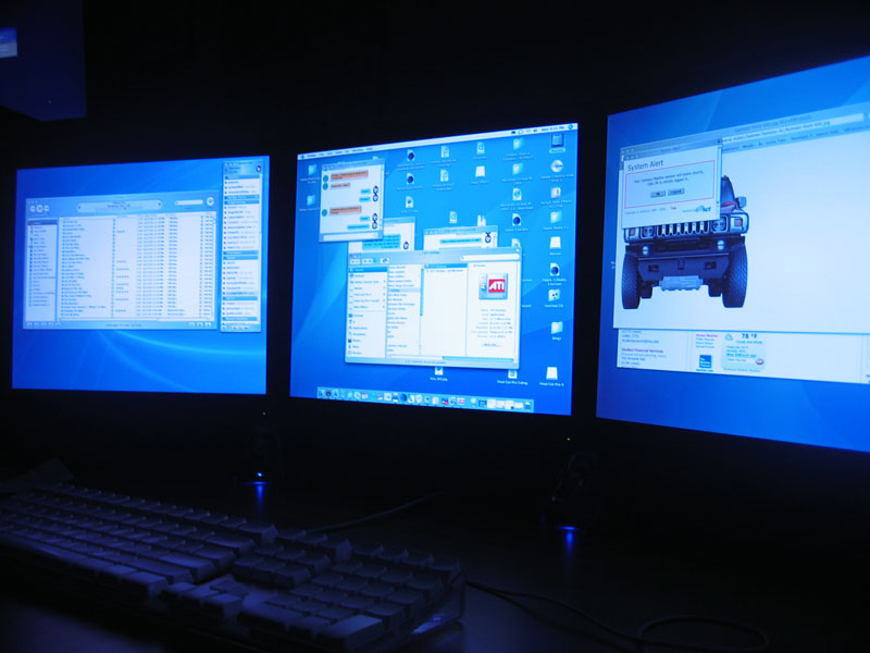

just as a follow up: i got one of the monitors. it works great, one problem though. sometimes itunes gets a little choppy if i move windows between video cards. not sure if i can adjust the settings to account for this.
you from Pepperdine?
damn. thats pretty pimp. I thought you wanted to hook up for monitor not three tho? Can you watch movies on one screen, do work on another and have websites open on another without any slowdown?

my 4th is coming in a few weeks. Samsugn doesnt make these anymore so they are hard to track down
