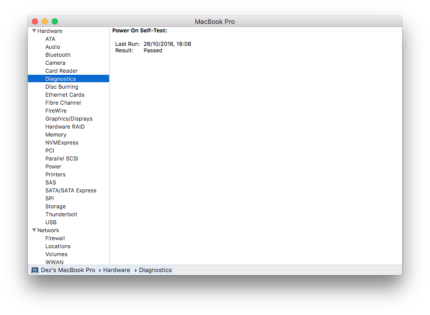

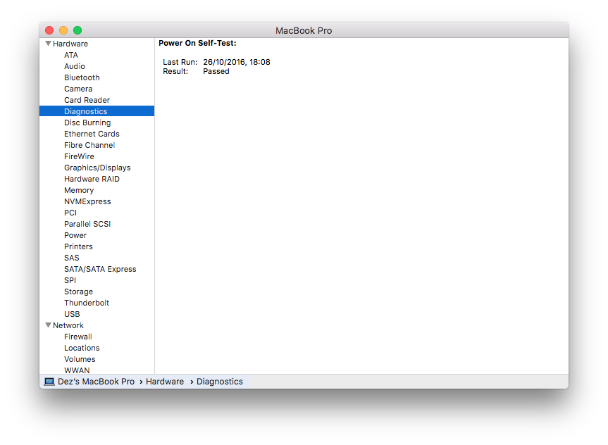

Does this report anything? (being it chimes tho I think it will just say passed) also have you tried replacing the PRAM battery and or trying completely different RAM sticks and or GPU(s)?
Yeah it says it passed. PRAM battery is brand new and I have tried different RAM and a different GPU.
