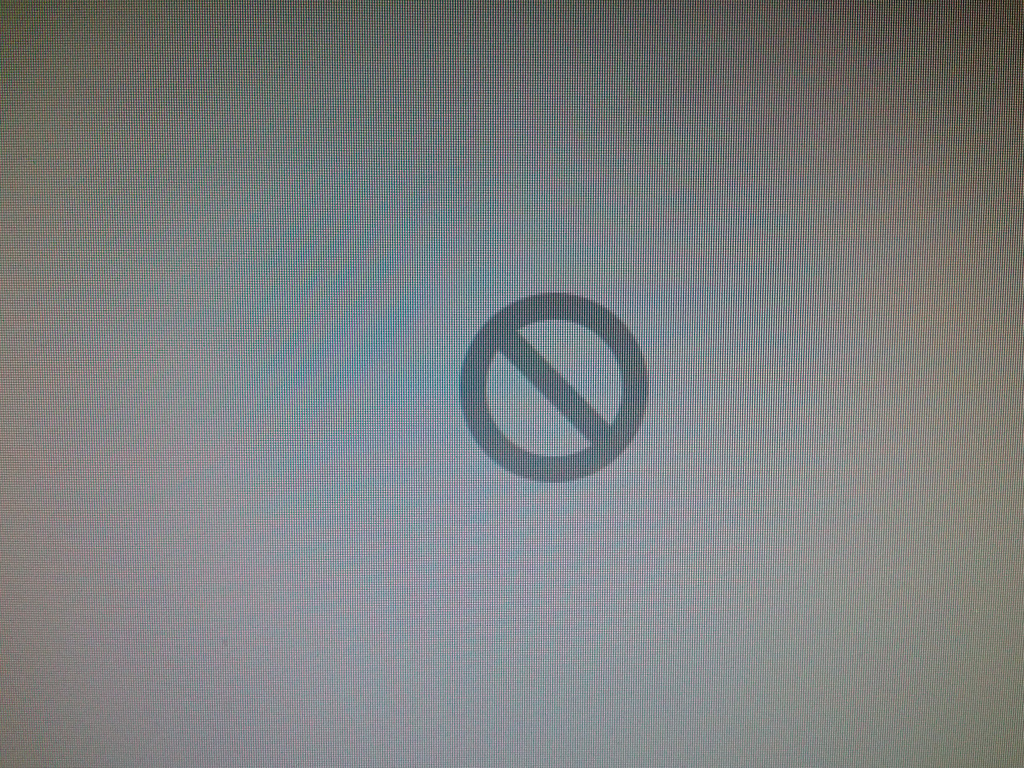

My G5 Quad has been collecting dust for years now. Last time I tinkered with it I got this and the computer would freeze. Red LED, loud fans, etc. I took the whole thing apart and it looked fine. Most users responded saying the logic board had failed. Some said it could be a processor.

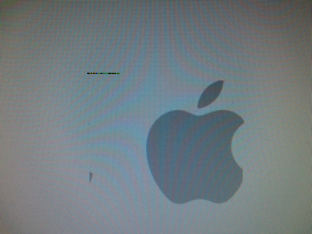

I put the 2 working sticks in the G5 today and I managed to boot the ASD CD! I ran the thermal calibration test and this is what I got after 30 seconds. I am now running the full 47 test. It's on ram and seems to be working.

I tried CPU 0 and 1 tests together and it froze. I left it for 10 minutes and there was no sign of progress. I tried CPU 0 by itself and CPU 1 by itself, still froze. So after all these years I am lost. The computer boots the ASD, the red LED stays on, and the fans blow loud as hell... Nothing freezes until I run the CPU tests. I have no hard drive for this system or I would try installing Leopard.
