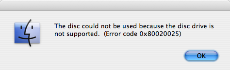

BTW is this the drive error, because I'm getting it also now.

Mmkay, the "Drive not supported" error is COMPLETELY different from any problem they may be having writing data to the hard drive (though again, I have a feeling that half is a user error, not a computer problem).
The solution to the "Drive not supported" error, according to what I've read (I just now looked it up haven't tried myself yet) is to either force quit the Finder, which apparently resets something and causes it to start working again, or to reset the PRAM. I'm pretty sure MacFixIt said that there was a cache or plist file that needed deleting, but I can't remember what it was and apparently the force quit works just as well. If none of the above work, you could also try resetting NVRAM.
That's for the CDR problem; otherwise your troubleshooting list looks pretty good, though I'd be interested to hear if it's actually a disk problem and not user confusion on the HD front.
