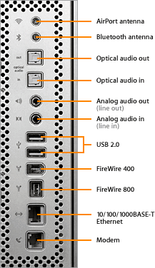

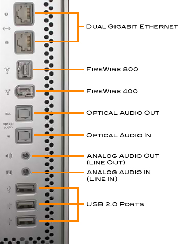

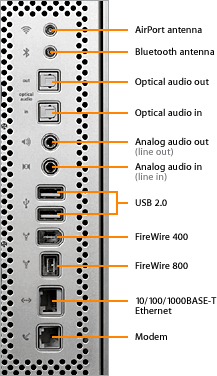

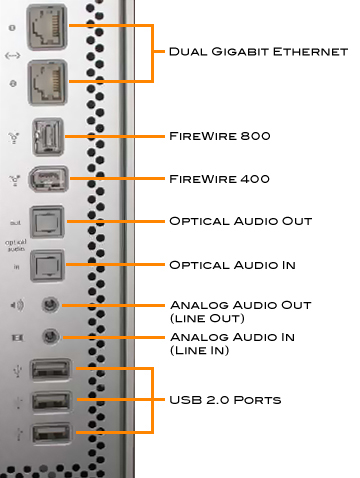

On the desktop G5 the dual core G5s have a different logic board from the dual processor G5. Dual core is on the left. Stands to reason that even if the pin out on the processor is the same that other changes including firmware will make DC processors incompatible with earlier logic boards.
