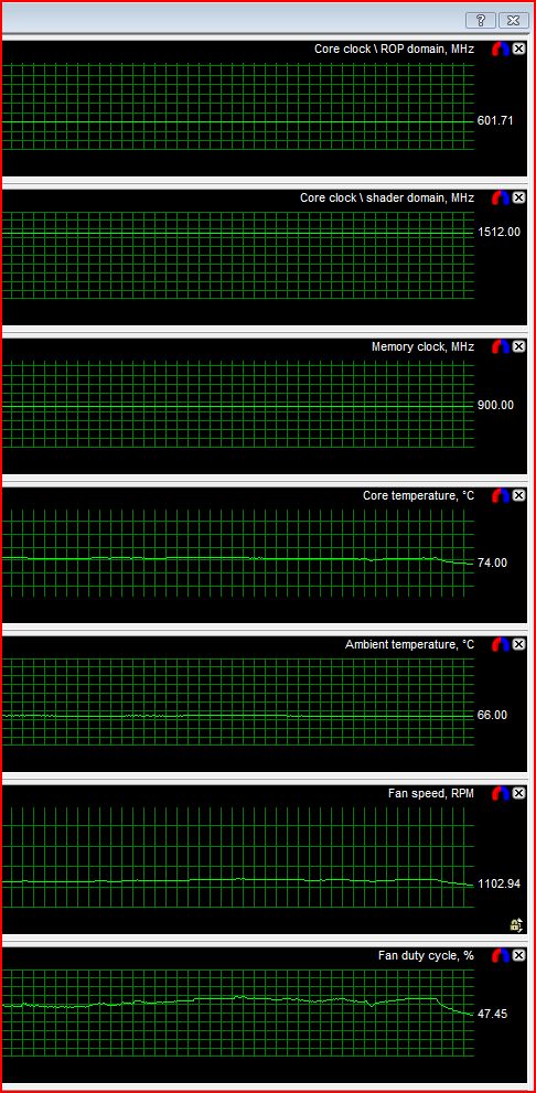

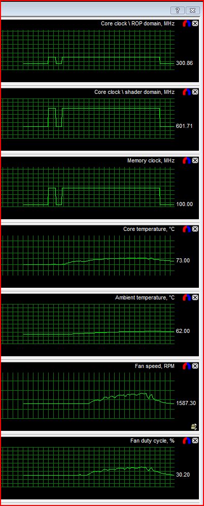

The attached pix are from running Rivatuner Hardware Monitor whilst launching and playing some Halo2 in Vista 64. You can clearly see the EFI64 card raising and lowering clock speeds in concert with demand, temps rising and fan speeding up to match.
The EFI32 pic shows flatline clocks on all three measured levels. This is the equivalent of driving your car everywhere in second gear all the time with engine racing. You wouldn't expect the car to last long.
