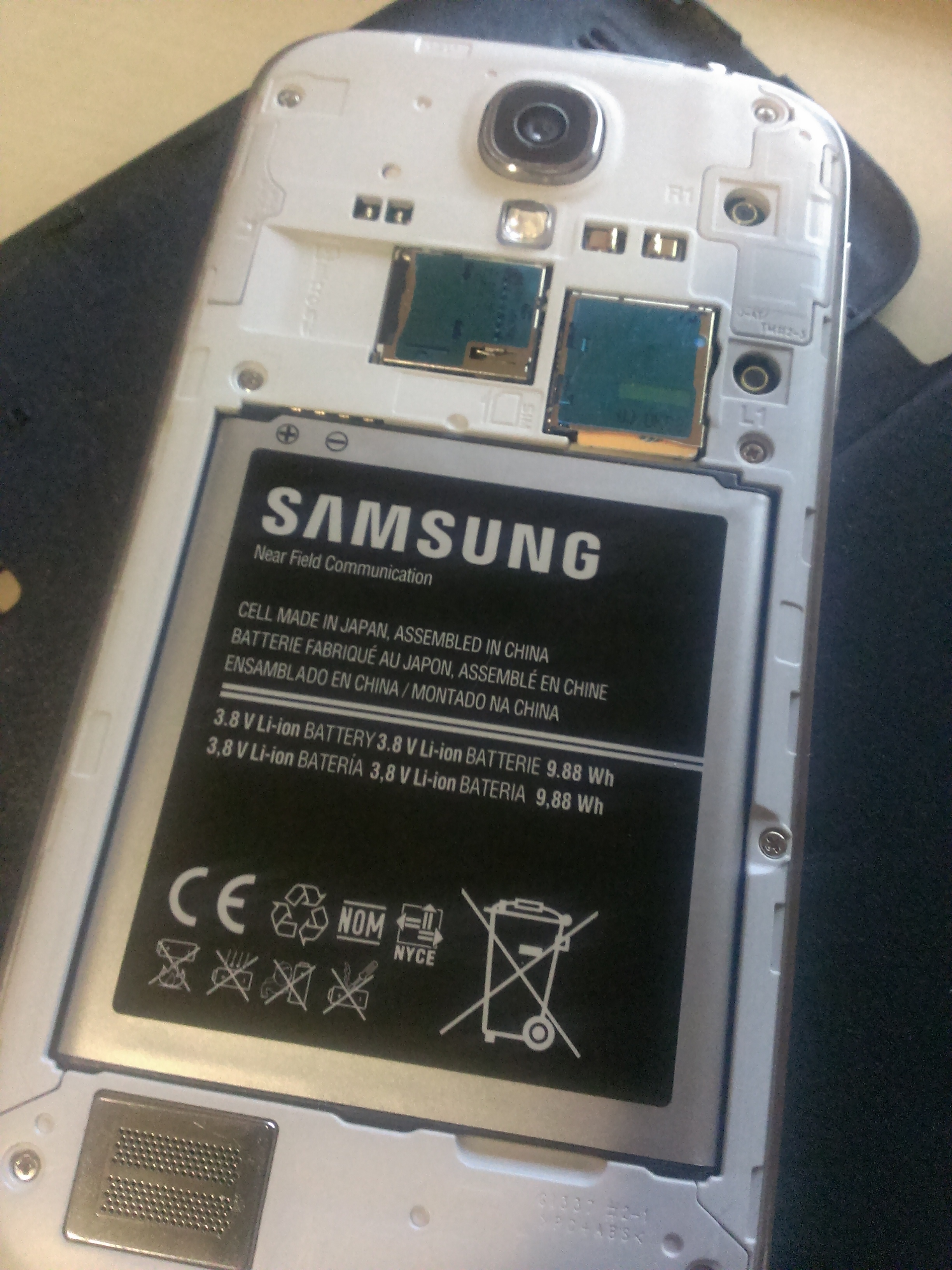

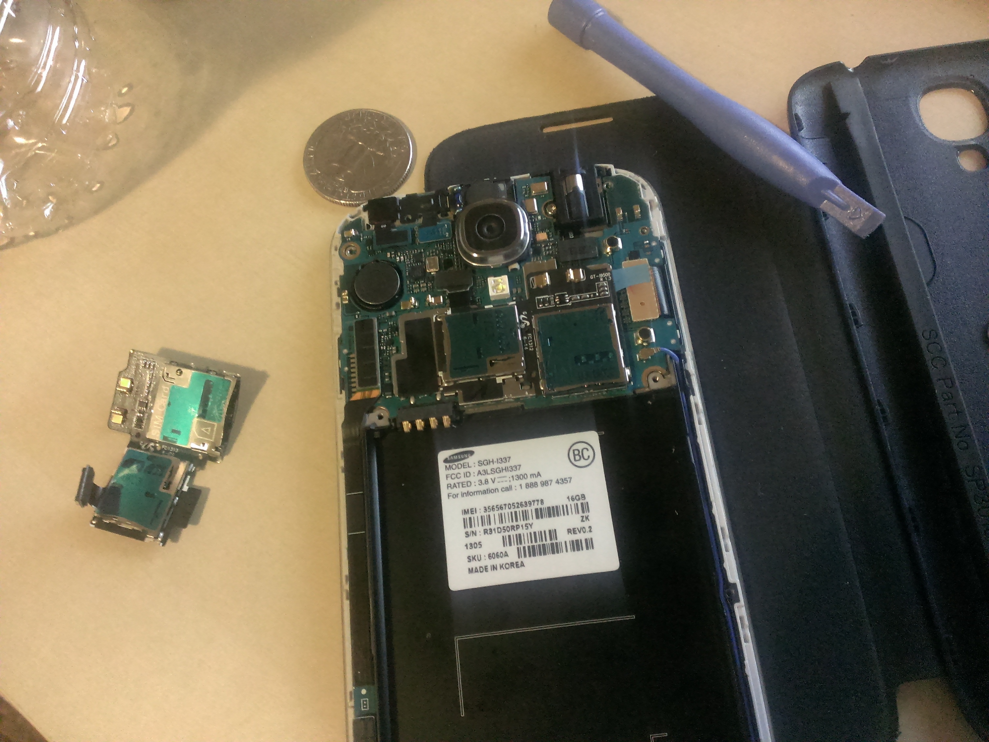

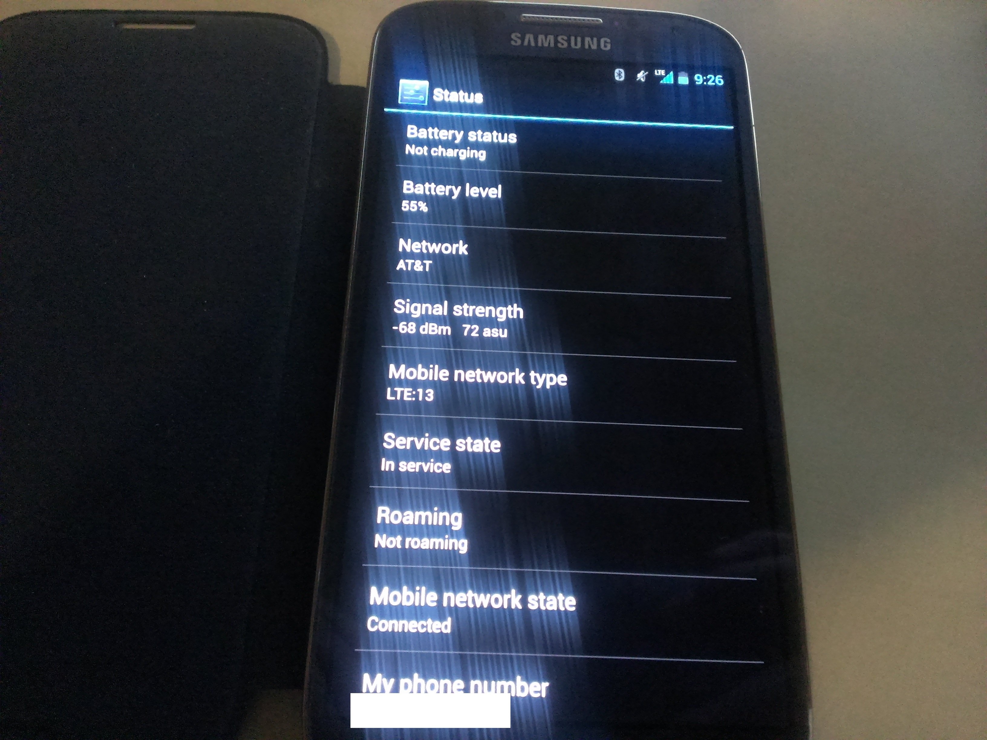

I broke my Galaxy S4's SIM reader (pins) when I inserted a badly cut "micro-SIM" while traveling in China. Thanks to this phone's abillity to be disassembled, I was able to repair it for only $12 by purchasing a new SIM/SD card reader. I bought it on eBay and received an i9500 reader (though the listing said i337) and it works fine as you will see in the pictures below. I'm able to receive LTE on AT&T and calls work great. Taking apart the phone was as simple as removing a few screws and lifting the frame.
The only negative thing about this is that the S4's SIM reader is actually held by an adhesive, unlike the S3 (which was held by a screw). It wasn't too big of a problem, though, as the adhesive on the bottom was still sticky enough to hold the new reader.

Ouch! That sucks man. When I had my old Nexus S and a badly designed microSIM->SIM adapter damaged my pins, I had to buy a whole new motherboard. :/ Basically a whole new phone.
Never again. Not in my S4.
The sim reader was faulty in mine, I sent it back to Samsung to repair. Took nearly two weeks to do what you did in 30 mins... I don't think I'd have the nerve myself though 🙂
Nearly botched my SIM reader too. Was migrating from an S II and my shoddily-made "micro" SIM was too small and became lodged in the reader. As the phone was not reading it, I had to get a pair of compasses(!) in order to extract it.
Then I realised I was too clumsy for such delicate tasks so I went to my carrier and asked for a proper micro SIM.
Never again. But hey, at least I wouldn't need to trim it further down to a nano SIM. 😉
