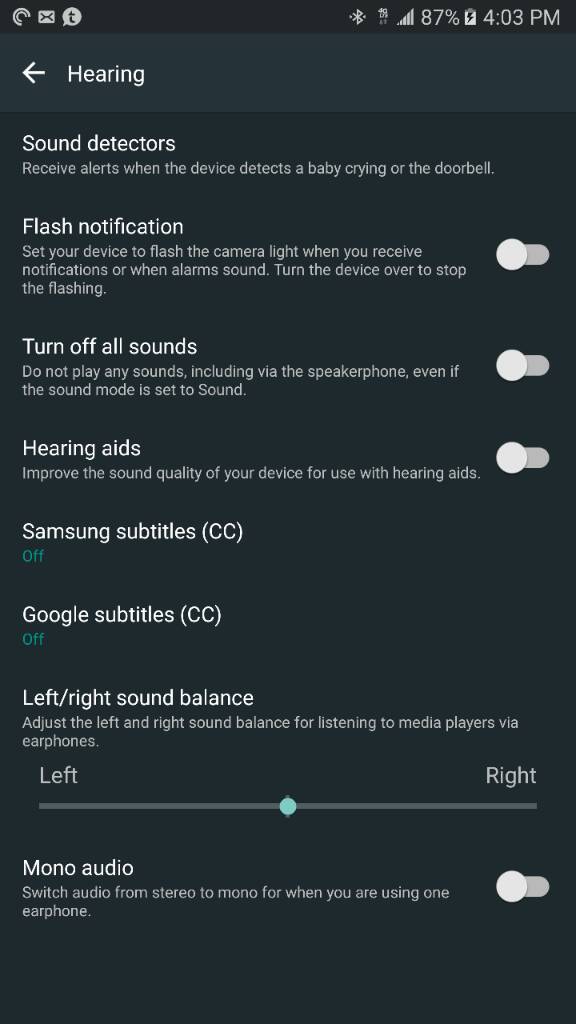

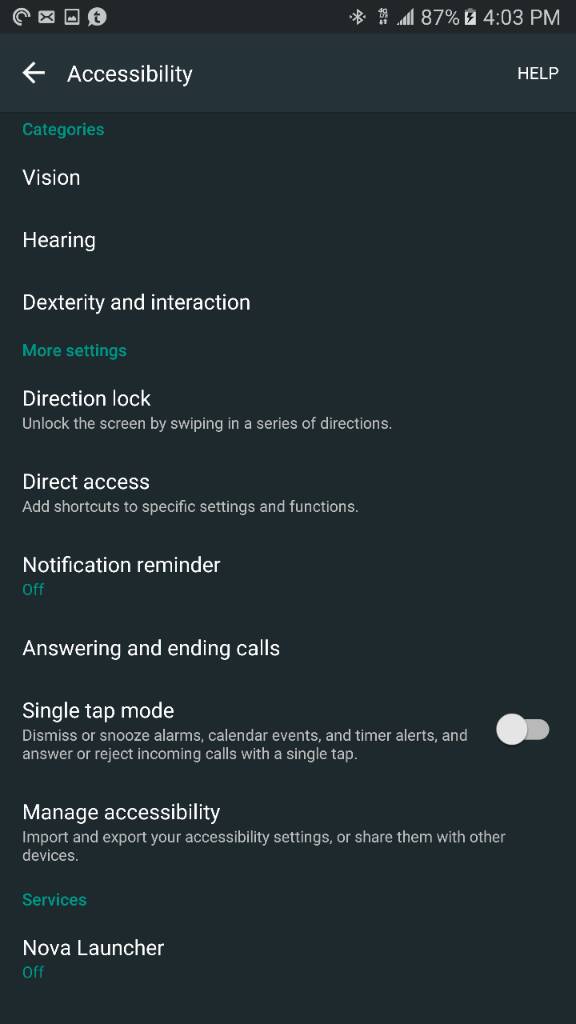

While this might not be exactly what you want, you can go into the accessibility settings and under hearing there is an option that says it'll light up the camera flash when you get a notification, but it also lights up the screen. So if you don't mind your camera flash lighting up as well, you could try that.
Thanks for this. The camera flashing is a deal breaker. So close.

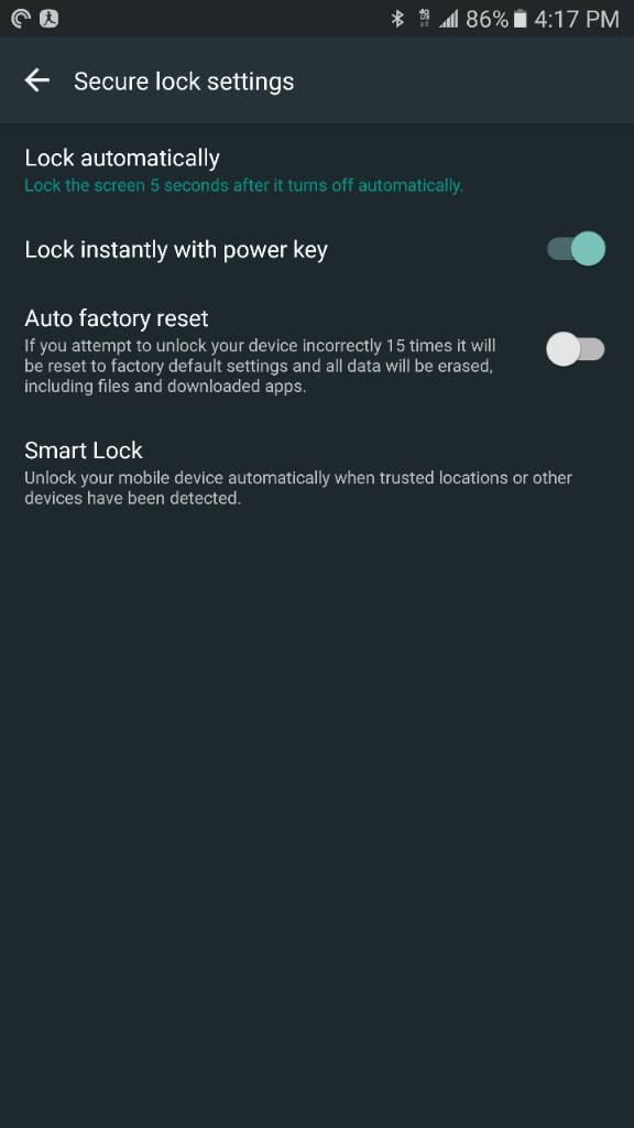

Hmmm. Have you tried changing the lock automatically settings? Maybe if you give it more time it will work without requiring the pass code?
Crap... it might be the Screen On Notification app. It hasn't happened since uninstalling it.
But why... why would that app cause the need for additional security measures? All it does is light up the screen whenever I get a notification. I've allowed it in the settings, too. It should know everything is perfectly safe...
It's clearly 'waking' the device fully and hence triggering the need for security authentication.
