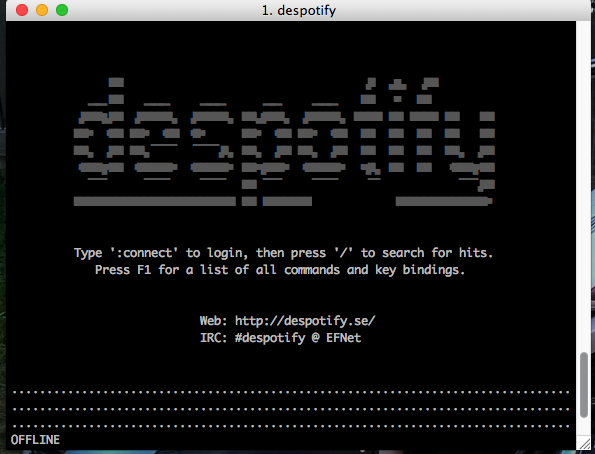

I built a bunch of stuff via macports and figured i'd share. I didn't see most of these when i did a quick search of the forum. Anyway, most everything is terminal/console based as i like to use less resource hungry software on these old machines. There's a few SDL games, the newest version of pianobar, cmus audio player, elinks text web browser, irssi irc client, nmap port scanner, openssh and some other stuff. Everything will install in to /opt/local to make these easy to remove should you want to. Everything *should* work on Leopard.
You can browse / download from my google drive here: https://drive.google.com/drive/folders/0B0swufWcvcjlMjFYd1lwR2dyXzQ?usp=sharing
Cheers.

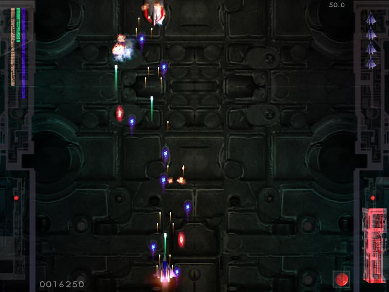

Added another game. Chromium B.S.U, an arcade-style, top-scrolling space shooter.
Cheers

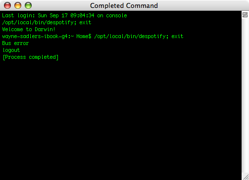

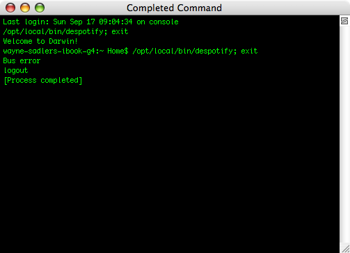

These don't work for me, my G3 iBook returns a bad CPU type message - which I guess means G3 isn't supported which is no surprise.
But on my G4 1.33 iBook, I get the following error:
Guessing by the timestamps on Google Drive, the ones from 16september including despotify haven't been repackaged yet ?

@Dronecatcher, hmmm. Everything uploaded has now been repacked and built on an ibook g4 running leopard. Could you try something else small like say elinks and see what happens? I did try on my other ibook g4 running tiger and nothing seemed to work, but i did try despotify on my powermac g5 running leopard and it worked.
Cheers.
