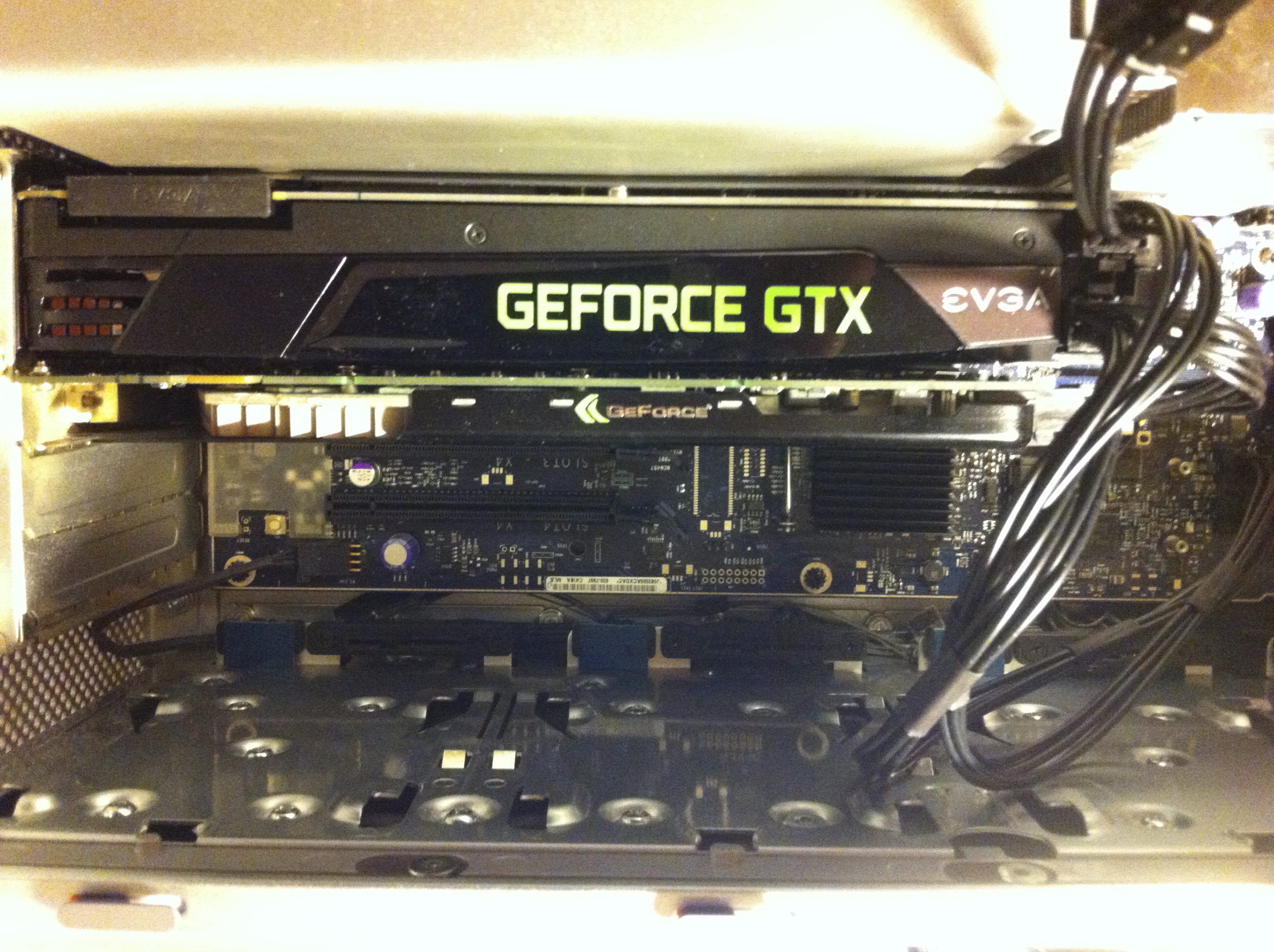

Hi Bo, there's NO PROBLEM running games on a MAC PRO 3.1! See my signature for more details. For the video card I used a EVGA GTX 670 FTW 4GB :thumbup:, this can be a PC VERSION (full driver support in MAC OS X 10.8.2) no matter what.
I used (2x) MAC mini PCIe to PCIe PC Y-splitter cable's and cross-wired both my NVIDIA GT8800 MAC-EDITION and the EVGA GTX 670 FTW PC VERSION for maximum logic-board PCIe power balancing!
These cables are both connected to the onboard PCIe power connectors: See image below
https://www.dropbox.com/s/2357wpm1g20vv0k/Onboard_PCIe.jpg
http://www.moddiy.com/products/Appl...Dual-PCIe-6%2dPin-Video-Card-Power-Cable.html
Hook-up your monitor to the EVGA and keep your ATI-MAC edition with a (added) simple TFT monitor for bootscreen and/or admin tweaks!

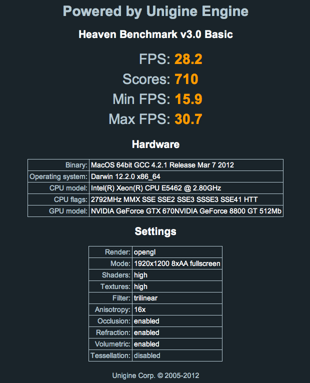

Screenoptions in MAC OS X 10.8.2.
https://www.dropbox.com/s/3mpdg6w172oa51y/BOOTCAMP 5_0.jpg
Output EVGA OC Scanner X 2.2.2

EVGA installed in Slot-1, NVIDIA MAC installed in Slot-2
NVIDIA GT8800:
1x PCIe 6-pin from onboard connector #1
EVGA GTX 670 FTW:
1x PCIe 6-pin from onboard connector #2
1x PCIe 6-pin from onboard connector #SPARE
https://www.dropbox.com/s/r8zuz3eda249mem/EVGA_GTX670_FTW_PC_in_MACPRO.jpg

In OS X I use both monitors the same way! E.g COD4 runs a steady 60fps in OSX!
Splitting the cables to each card is for better load balance on mobo! And yes one of the four will be a spare!

Yes make a cross-link connection to the GTX670 and youre fine on the power!
NVIDIA GT8800:
EVGA GTX 670 FTW:
