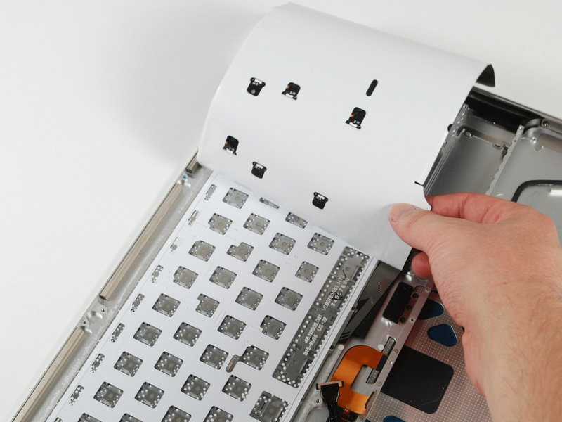

I agree. While it's true the exhaust vents are on the back, the air intake is through the keyboard. With the lid closed, the rubber gasket at the edges blocks much of the air flow. It can be done if the screen isn't closed completely. I've seen some users close the screen with a pencil or some other soft object used to maintain a quarter or half inch of space for airflow. This seems to help a good bit.
That is false. There is no air intake through the keyboard. Both intake and exhaust is through the vents in the rear. There is a solid sheet under the keyboard, preventing any meaningful airflow.

You know, I didn't believe you when you at first. But, a little digging revealed you are actually correct... Shocking! 🙂
I will admit, I lol'd when you posted a picture of the 2008 Macbook Pro.
That's just one example. The same is true for all Mac notebooks. There's no need to get a different picture for each model.
