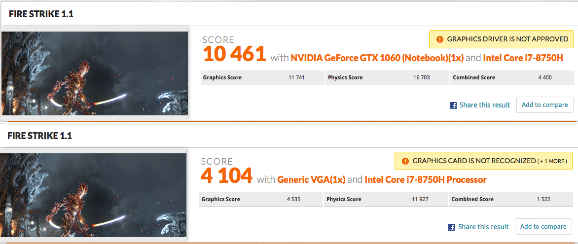

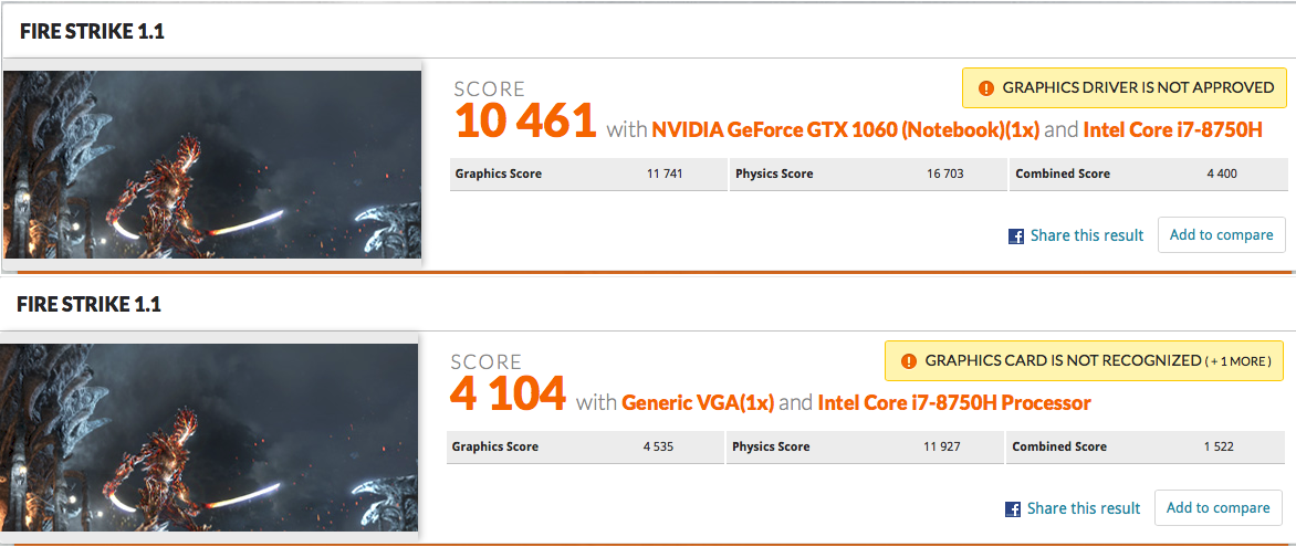

Here's my FireStrike benchmark, and compared against the RazerBlade I had (and returned).
I have to believe the 555x is not that much slower then the GTX1060 Max-Q. I could be wrong, though but I do suspect its a driver issue. Look at the MBP, it states its with the Generic VGA(1X). I've not had time to dig into this further. I also noticed in starting up the benchmark, the MBP took an extensive amount of time to collect the data before firing off the benchmark, like 5 minutes
Even the 1060 MAX-Q version is leaps and bounds above the 555x
