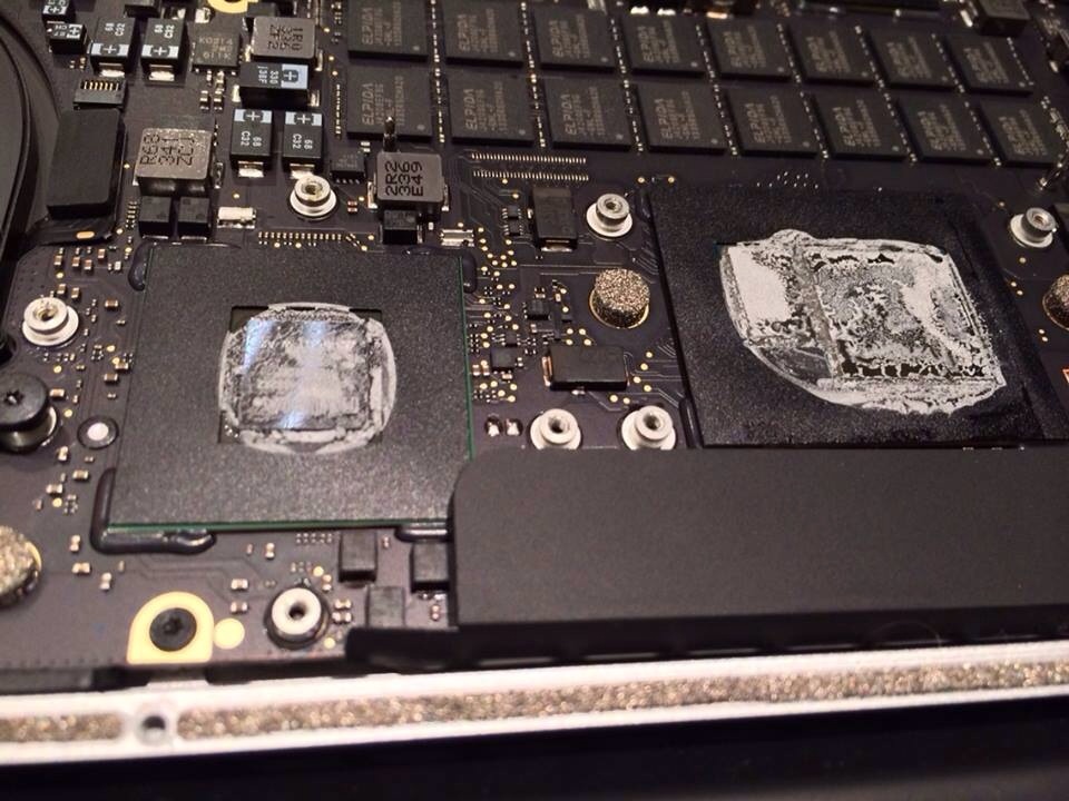

If you want extra peace of mind, try changing the thermal paste. Could knock as much as 10c off your temps.
The factory workers are the ones that cause the vast majority of heat issues with Macs due to the ridiculous amounts of paste used when assembling the machine.
Here's the inside of my 15" when I opened it the first time:
