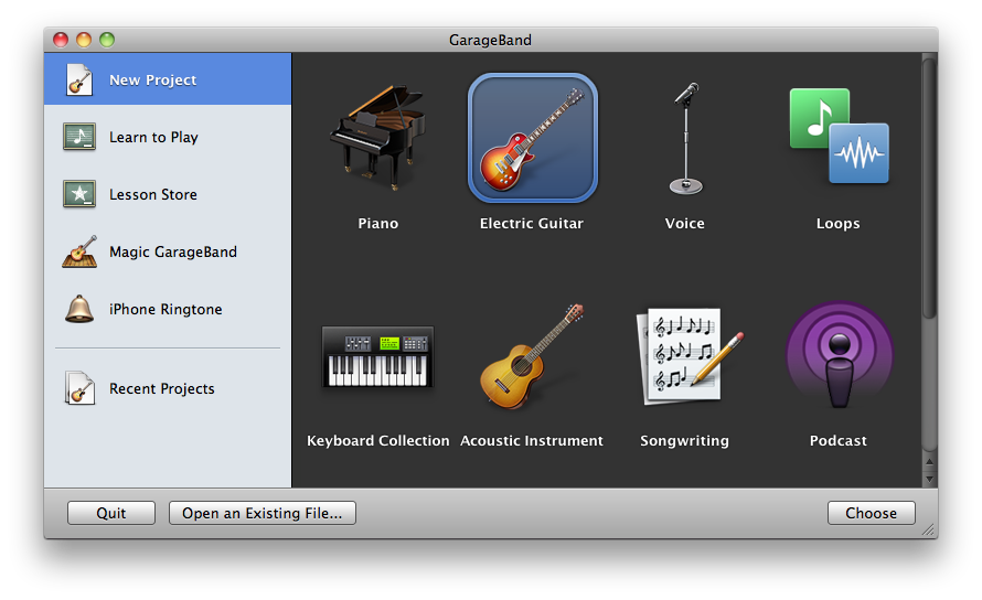

1. start GarageBand. select 'electric guitar', title your project (e.g., "CPU test"), and click create.

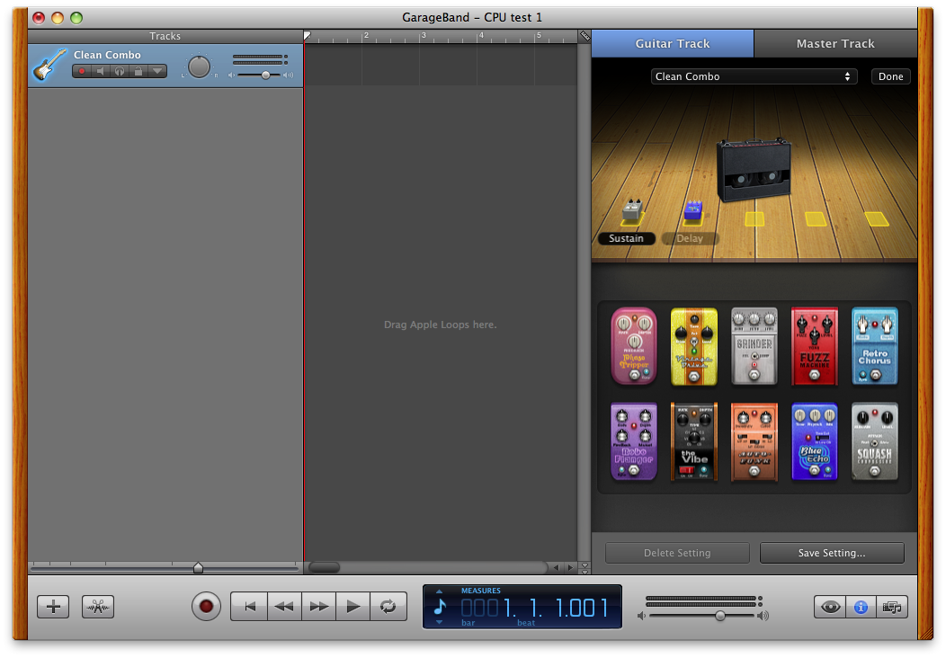

2. double click the 'sustain' pedal in front of the amp on the right, then drag and drop the yellow and orange overdrive pedal onto it, (replacing the sustain). fill up all 5 slots with (same) overdrive pedals.
attachment.php

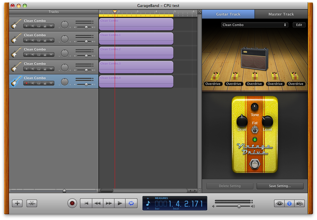

3. engage the loop option next to play at the bottom. record 4 bars of nothing (red button). click on the recording and copy it (apple + c). create a duplicate track: apple + d. make sure the marker is at 0 and paste the recording (enter, apple + v). make 5 total tracks like this.
attachment.php

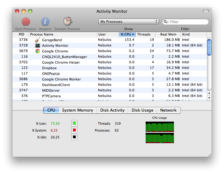

4. open up Activity Monitor and order your processes by "%CPU" (click the tab on top). also click CPU below to get a visual indicator. check that your volume is down and hit play on GarageBand. note the average % reported for GarageBand. (ideally, have nothing else running that takes up more than 1%.)
attachment.php

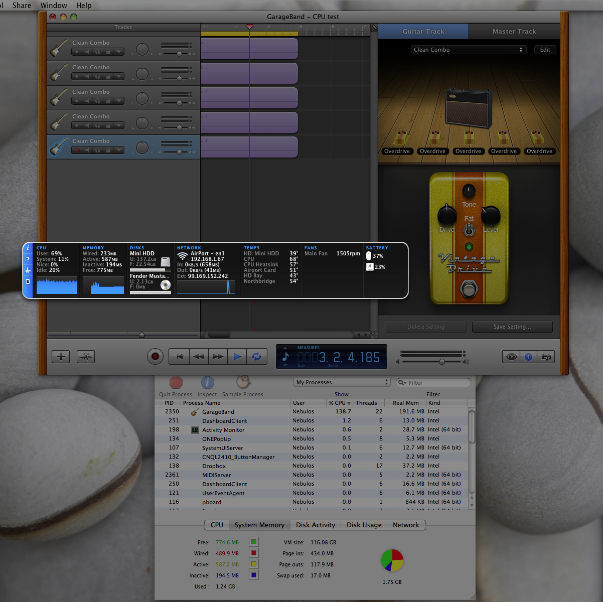

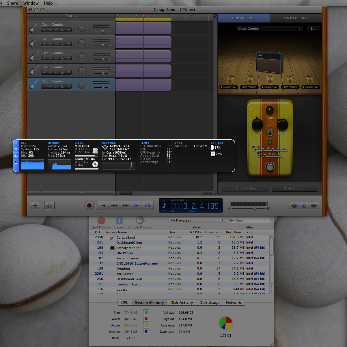

* Note on 2.26 Mini: Originally, I got 75% for the mini. I reran the test tonight (10.1.11) and the mini seemed to do a bit better, only needing 68% of its CPU to handle the test. CPU temp was steady at 68 degrees. Here's a pic:
attachment.php
(sorry about the thumbnails)

Followed you instructions exactly - Good instructions! - and ran the test. It does vary a bit, but when nothing else is running the CPU% hovers around 93% --occasionally dropping to 91 and occasionally hitting up to 95, but 93 is most common.
Also, I still have the test running and my CPU is at 83 degrees C and the fans are now on at 3600 rpm. (As a reference, the Star craft 2 Demo heats my little 11 up to 93C 😱)
So, I am not sure what that will tell you. I guess it is a little more efficient than the i5 -- 93/400 vs. 100/400
