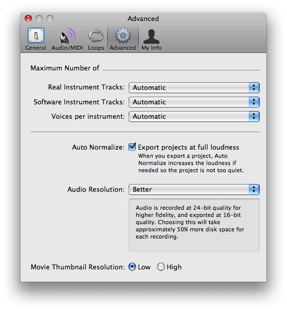

    Every time I export a song out of GarageBand, the volume for the MP3 track is too low. I have to blast my volume in order to hear it. In the old GarageBand, the volume would usually be too loud on the MP3 track, but now it is the opposite.
    I have tried adjusting the Master Volume and the Track Volume in GB and have still had no luck. The volume problem happens when I export a track containing only Apple Loops. If the track contains music played by my keyboard, then the volume is fine.

    Either of you tried toggling the Auto Normalize feature in the Garageband's Advanced preferences?

    JediMeister is right...
    But if I remember correctly the option is not there on versions before Garageband 4.

    Just went into Preferences and changed that stuff. Then I exported a song, but still had low volume.
    My old songs (like a year ago) were always booming with sound after export. What gives?

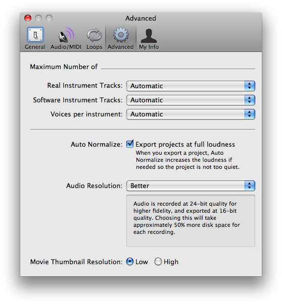

    This is the solution, just opt out "Export project at full loudness...". Paradox, but if you tick it, it will export in half-loudness.

    Ahhhhhhh! Thank you sooooo much. Its been months without any answers! Thanks bro!!!

    Hey I know I'm 2 years late, but I'm having this problem too. Just to clarify, to get full volume you leave the "export at full volume" box UNticked?

    That is INSANE, but you are right!!! It works quite the opposite way than it should!! I had this annoying problem even in GarageBand '11, but you Sir saved my life!
    You have to UNTICK the box!
    Thank you guys!
